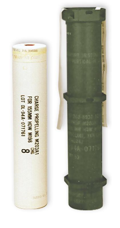

No, you cannot ram NATO 155mm projectiles and the propelling charge at the same time. If you try, you run the risk of crushing the powder bags, or for the newer extruded modular charges, crushing the cases. If you do this you will get unreliable ignition resulting in wide variations in projectile velocity, which in turn will ruin accuracy. Worst case you could end up with a projectile stuck in the barrel, or even burst the chamber, or barrel. The proceedure is: First the projectile gets rammed (loaded) to seat the projectile driving bands and then the propelling charge is rammed (loaded seperately).
Field artilery ammunition comes in four parts : the fuze, projectile, propellant charges(s) (could be one to eight charges), and the primer. The propellant is "built up" by combining different charges of to get the desired amount of propellant, the more you add, the greater the velocity of the projectile. You can change range by changinging gun elevation or propelling charge, or both. Bags of granular propellant (M3A1, M4A2, M119, M203A1, etc.) are still in the system, but the new modular charge technology is to stack pressed charges (they stack like tuna cans). Here is a 28lb M203 charge and its carrying container (yes that is 28lbs in a single charge):

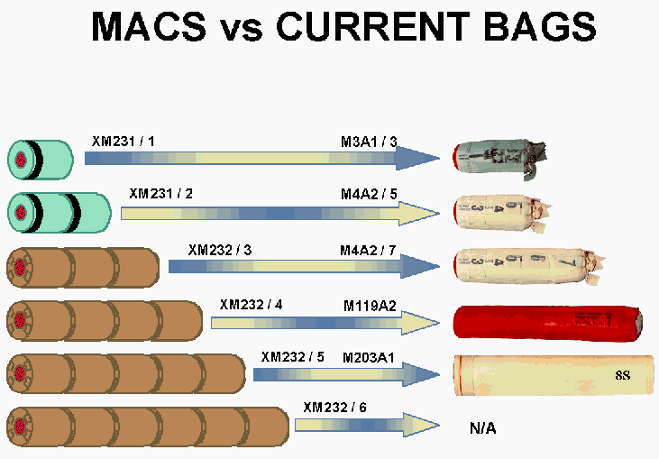

Here is how the new modular charges equal the older bag system.
The rapid fire 6"/47 and 8"/55 guns used fixed charges loaded into a brase case that in turn was crimped to the projectile almost like a rifle cartridge. Again, I am not certain that current 155mm ammunition can be be mated to a fixed case without modification (maybe they can use some super adhesive?), but it should be trivial to make future projectiles compatable with cases and bagged charges.
Although bagged/modular charges seem to be cumbersome, they do give the firing battery a tremendous amount of flexibility in controlling the trajectory of fired rounds and help make tactics like MSRI possible. Fixed charge ammunition is very inflexible by comparison.
