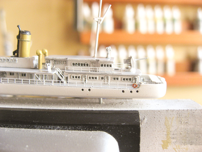

I'm on to the wash stage and started painting the water. For the wash I'm using Mig Pigment's pre-mixed wash. I'm still not sure how I feel about using pre-mixed washes -- seems kind of lazy to me -- but they do work well. They dry fast and are much more even than my hand-made variety. For the gloss coat I used the Tamiya gloss lacquer in the rattle can, decanted and airbrushed.
I've also stippled in the bow wave and the wake on the water base and started painted it with acrylics through the airbrush.

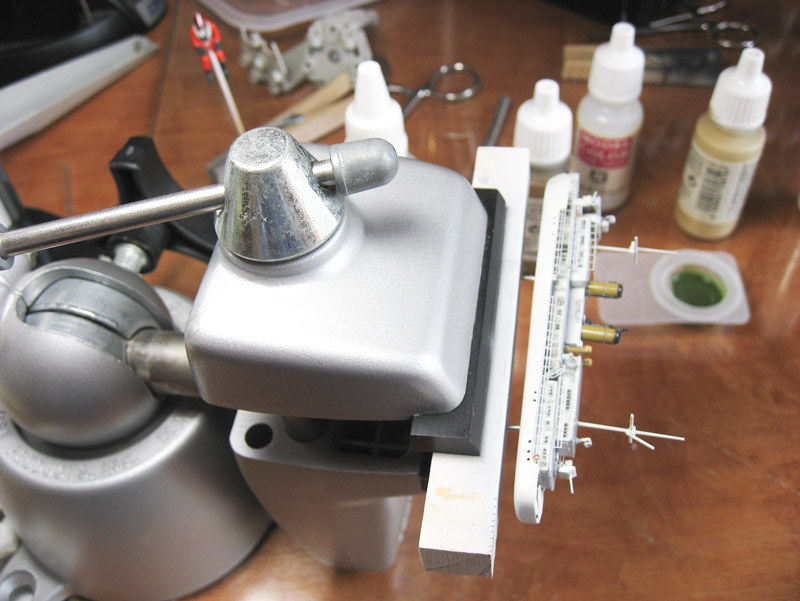

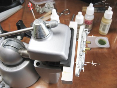

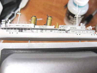

Just a quick photo of the wash results in the windows. As I stated before, I used the Panavise to put the ship first on her starboard side, then on the port side, then to stand her on her bow, so that the wash would pool in the windows. I'm happy with the results. After that I set her upright and did the regular wash on deck details, guns, etc. The dark gray wash is a little starker than I wanted, but with the naked eye in this scale, anything lighter was simply lost.
A little more cleanup today and then I'll dullcoat her for drybrushing and rigging.

Devin, the windows look great, nice build and review all in one.

Thanks, guys. I'm really happy with the windows, too. I wish I'd thought of this before I drilled out the portholes on the hull and done this instead with PE add-ons. I've never liked the look of drilled-out portholes -- it's the most out-of-scale thing you can do on a ship model, in my opinion -- and I think this will work well for them in 1/700th, and maybe even in 1/350th. Too bad I already drilled out three-dozen of them for the pre-war USS Wichita, or I'd have given this a shot on her.
