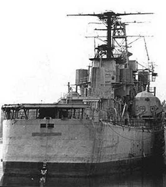

I noticed a couple of things on canberra as well as boston
first thing is a set of vents on the stern just above the ship's name
second is the bridge canberra has four skylight windows in the overhead of the bridge roof.
see as how both are sister ships.
if you check ancestry.com they have a section for navy cruise books lots of good pics
the boston has a few...though you might have to sign up for a free 14 day trial to get the stuff and cancal before the time is up
so you don't get charged....that's what I did..LOL!
I am going to try and load a couple of shots here.
if you want more send me an e-mail jfkcsi63@yahoo.com
Jerry
Thanks! and yes if you wouldn't mind I'd like to know which one had the baskets.

The "vents" in the stern are actually recesses for stern lights. These are formation lights and probably a wake light.
I'll bet the bridge "skylights" are actually just openings. The original ships had open bridges during WWII - really nasty for standing bridge watches in typhoons, etc. After the war these were partially enclosed with windows across the front. Some ships added wooden frameworks with canvas overhead. Later some ships replaced the wood and canvas with metal roofs over the center bridge, with open bridge wings.
I don't know if these changes were planned Navy wide, or if individual ships just made these changes when individual Captains decided to make them.
