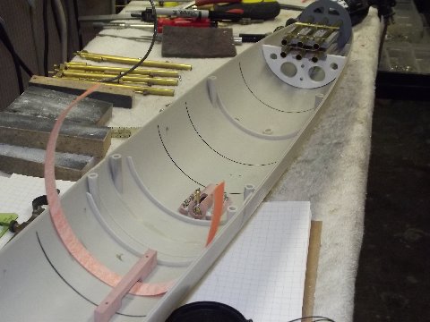

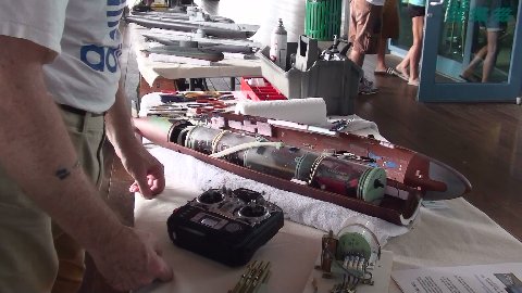

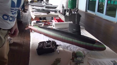

David Merriman will be publishing his cabal reports on RC'ing the Skipjack shortly. Here are a few pics of his prototype at a recent sub gathering last month in Newport News, VA.

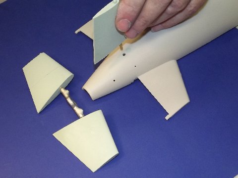

David just released some of his recent work on the fittings kit to whet your appetite.
Enjoy!

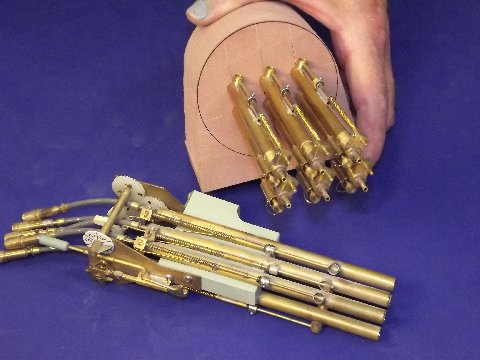

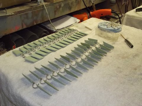

A few more of David's work on the conversion kit. He plans to have the masters this weekend and then will start on the mast kit. Caswell will offer 2 kits for the Skipjack that David is developing that will cover both RC & static modeler markets:
Quote:
The 'R/C conversion' fittings kit will be all the items needed to convert the kit to function as a practical r/c model submarine -- included in that fittings kit will be the foundations I showed last night to mount a torpedo weapon system if the customer desires.
I will develop a separate 'detailing' kit that will include refined masts, scopes and antennas, detailed door and deck hatches, main ballast vent flanges, cleats, mooring lines, figures, and other small parts to make a more presentable display piece.
Details can be found on http://www.sub-driver.com.

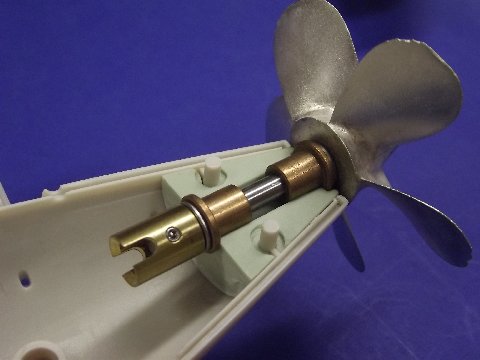

Here are more from yesterday's work.
David's too busy to post his usual cabal reports but has been sending me photos as he developed the fitting kit & runs production as he is now doing. The mast & detail kit comes next. Am sure he'll put one up on the Sub Drivers site once he's completed both kits but for now there is no conversion thread, just the details of either kit over on Sub-Driver. http://www.sub-driver.com.
