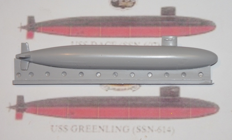

I received the OKB Grigorov 1/700 USS Thresher class kit and it is simple, but nice. It compares favorably in size with the 1/700 JAG WL kit I bought from D-Boy (Thanks again D-Boy!) The sail is essentially the same size and the lengths are very similar. Below is a picture with the model sitting below USS Thresher on the 11�x17�print, as printed on my printer. The model is slightly bigger, but not by much, so would do nicely for recreating the print in 3D. Below is a picture with the model sitting between USS Dace and USS Greenling on the 11�x17�print, again, as printed on my printer. The USS Dace was of the earlier design, shorter hull and sail, the USS Greenling of the later design. The differences are obvious. After receiving you all�s feedback and now that I have seen the model, I have a little different perspective as to my options. First, I think duplicating the print with models will be more difficult than I first imagined, and since I think I have enough information to be able to scratch build USS Greenling, at whatever size I want, this may be the avenue I pursue.
Still, I like the idea of duplicating the print in 3D, and if I could pull it off, it would look really cool, so I am still giving that some more thought. Here�s what I�m thinking. Tell me what you think.
Step 1: Use the model to make a rubber mold. It would actually be 3 molds, one of each side and one for the sail planes and screw shaft.
Step 2: Use the molds to cast the 9 short hull ships (I would probably make a few extra). This could either be done in halves, creating two pieces to be glued together, or by clamping the 2 molds together and making one cast. This is the way I want to try to do it.
Step 3: Cut the original model in half just behind the sail and add 0.25"shim and sand smooth.

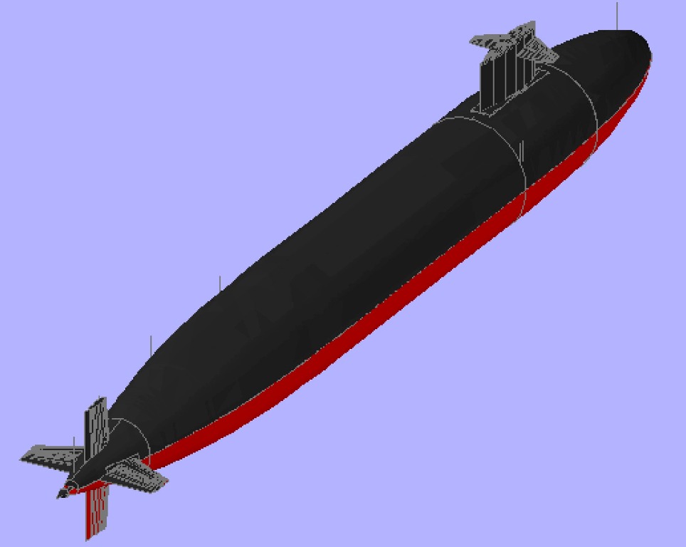

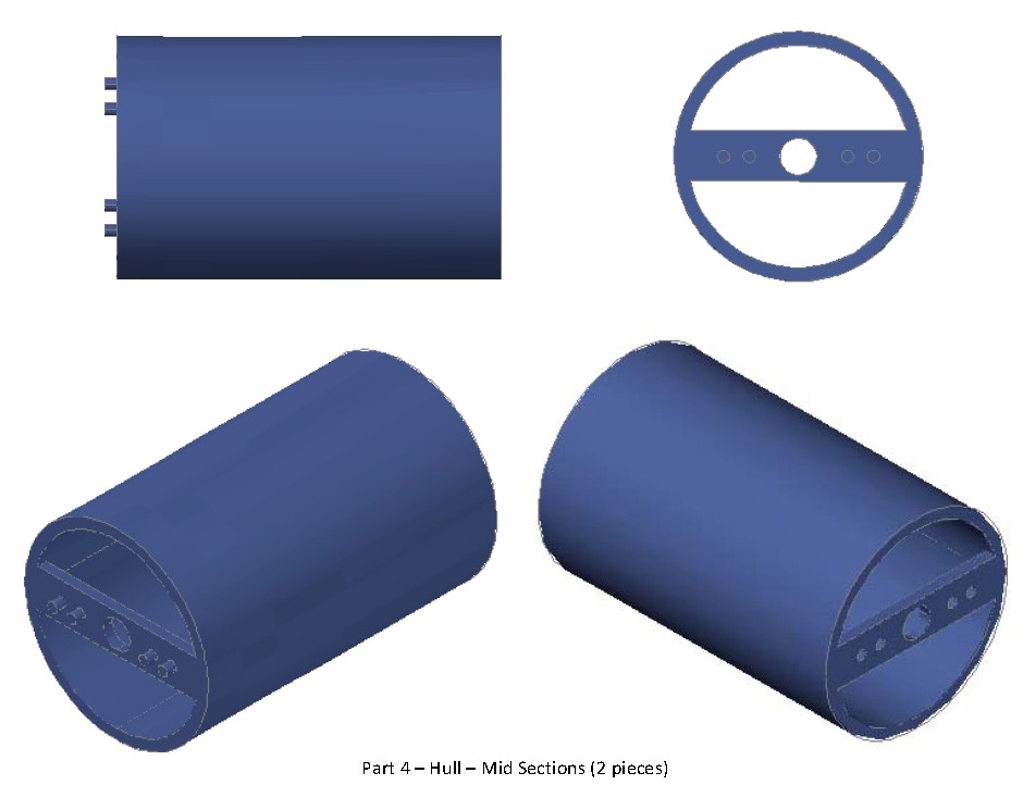

Hi Guys
A lot has transpired over the last week with regards to my plans for building the USS Greenling for my friend. First, I obtained a decent set of plans for USS Permit. Second, between the plans, the print and photographs of Permit class subs, I was able to derive what I think are reasonable dimensions for Greenling's sail. Third, another friend of mine told me that he has access to a stereolithography (SLA) system and said that he could use it to make the small parts for me.
The SLA method uses an ultraviolet laser that solidifies a thin liquid photopolymer resin. After one layer is solidified the SLA elevator platform is lowered 0.05 mm - 0.015 mm (0.002� � 0.006�) and the process is repeated. This continues until the whole part is completed. The advantage of this is that the parts can be generated straight from 3D AutoCad drawings, which I have recently learned to do. I therefore "built" a solid model of Greenling using AutoCad Civil3D, and it was a LOT of fun. I then dissected the model to make parts no larger than 4". And it was a LOT of fun too.
I�ve started a build log on the Subcommittee forum and at the risk of doing something improper the results are shown below as well. More detail of the process I went through is provided on the Subcommittee forum at http://s181686668.onlinehome.us/phpBB3/ ... 658#p67658. Due to the 10 pic limit per post here, Part 10, the propeller shaft, is not included. I hope you enjoy the images.

And of course, after I reassembled her, I had to �paint� her!
