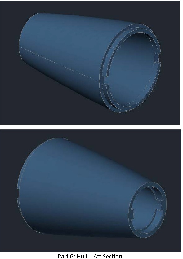

UPDATE 4A
Oh Boy! Was it ever a lot of fun taking apart the �ship� that I had put together with one set of pieces to generate another set of pieces so that I can build another �ship�?! If you have been following the Calling All Thresher/Permit Class SSN Fans this will seem familiar to you as I posted essentially the same thing there yesterday before I decided to start this WIP on this site.
I started by segmenting the ship into seven segments, because my buddy said that he could do parts up to about 4� long. With seven segments the largest piece is 4.0� x 2.5� at 1/150 scale. AsI said in the last post, based on advice I was given that 1/144 is a more common scale, I�ve decided to build her in 1/144 as opposed to 1/150, so the largest piece will be 4.2� x 2.6�, which is a little long but 4� was an exact limit. There are 13 parts, with 3 of them being duplicates.
I should perhaps mention that my buddy said that the parts couldn�t be solid, that they had to be hollow. We agreed that 1/8� (0.125�) would be sufficient. Increasing in size to 1/144 increases this value to 0.13� when I scale the model as is, which I will do, because to do otherwise would mean essentially redoing it. Again though, this small increase in width shouldn�t be a problem.
Below are images of the parts, beginning with an exploded view of the model with the individual parts identified, followed by close-ups of the individual part so the detail of each part may be seen. Having put her together, I had to �paint� her, so the last few images show her �painted� in the proper colors. Due to the 10 pic limit on this site, the images will be split onto two posts.
All of the design was done using AutoCAD Civil3D. The �Realistic Visual Display� option (using default settings) was used in all of the images.
After segmenting the ship and hollowing it out I decided to provide a means to align and provide support to the pieces. I did this by adding a �� wide strip at the ends of each piece, in which I �drilled� 3/8� holes through the center of to accommodate a 3/8� rod down the middle of the hull, which may not be necessary. I also �drilled� small holes on the aft side strips and put slightly smaller extrusions on the forward side strips for aligning the parts readily. I put two on each side, but probably could get away with one, and in act have already changed it although the pictures don�t reflect this change.
Because of size restrictions, the sail had to be a separate part, so I cut it out and extruded some small knobs, which fit into holes drilled in a plate I attached inside the hull. The knobs probably aren�t necessary, but they look cool and I�m going to keep them.
The tail section and to a lesser degree the diving planes took the most time to complete due mostly to me not taking the right approach to doing it. An interesting thing about creating parts in AutoCad is that there is usually more than one way to make a part, and some are better than others. In hindsight, there was a far easier way than the way I did it, but such is life.
I put the �painted� model over a light blue background and I think it looks pretty cool. I�m sure if I knew how, I could change the defaults to make it look better, but the intent here was not to build a virtual model, but to create the parts for a real model.
ENJOY! The remaining images will follow shortly�

UPDATE 4B
And here are the rest of the images. First the remaining parts� And now the "painted" ship. CHEERS!!!

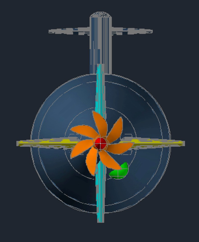

Re: 1/44 Scale USS Greenling (SSN-614) Scratch Build
UPDATE 5
I�ve been wondering for a while what I was going to do about the screw, and then I found this picture on the Net. The same article that had this picture also reported the diameter to be 15�, which at 1/144 scale is 1.25�. After looking at the picture for a while I figured out the geometry. The tailing edge is a curve on the plane of the aft end of the screw. The foreward edge of each blade is off set at a constant angle from the tailing edge. The aft and forward points on the hub and the end of the flat arc on the tailing edge define a plane that the other curved line is on. I decided to try building it in AutoCad. The one remaining question was, how thick, or wide was the screw. Once again the plans came in handy, and although there is no detail of the screw on them, the plan view clearly shows how wide it is. Using this dimension I was able to recreate the screw remarkably well. And it looks pretty good on the �painted� ship too! I�m pretty darn happy with the way it turned out. It was definitely the most complex part I�ve ever done. It�s got me wondering if I can use the part we make to make a low temperature metal cast. It would be cool to have a metal screw.
I sent my buddy a test file to make sure he could open them and he can, so the next stage is to try a part or two and see how they come out. I�ll keep you posted.

UPDATE 6
Based on a comment I received on the Subcommittee site, I redid the screw. Although I don�t think it�s perfect, it�s better than it was and I like the way it looks.
CHEERS!!!
CHEERS!!!

UPDATE 9
Hey All!
The first step in detailing went well. The Mushroom Anchor is added and it was a snap. With the aid of the plans, I simply drew a sphere of the correct size and put it in the right location. In the attached images, the Mushroom Anchor is green, the rudders are cyan, the diving planes are yellow, the screw is orange, the screw shaft is red, and the hull is a shade of blue. The next things I am going to try to add are the so called Zincs (see below), whatever the heck they are. Using the plans once again, I was able to locate the Zincs (Magenta in the image below), but I haven�t seen a picture of them yet, so I don�t know if they are supposed to be recessed (I assume) or raised from the surface. Does anybody know what they are for and/or what they look like? Pictures would me mucho appreciated!
Hey All!

UPDATE 10
Good Morning All!
And thanks for the feedback codythecat!
With the feedback I received both here and on the Subcommittee forum I made some adjustments to the Mushroom Anchor and did the zincs. For the mushroom anchor I used a larger diameter sphere and moved it in more. I then subtracted a smaller sphere from it to create the �dimple�. For the zincs I made a single 0.01� thick bar, with a width of 0.0564�. This is wider than 0.0417�, which would be 6� in real scale (as per some plans I was provided), but it agrees well with the Permit plans. Every 0.0833�, I cut 0.002� wide, 0.002� deep notches in the top and sides to delineate the individual slabs. I then mirrored this around to all four sides and sliced the one by the mushroom anchor. These should perhaps be wider, but I may be taking these off again anyway. More on that later.
I also �scribed� the �Access to Free Flood Area�. I did this by removing a 0.01� wide and 0.01� wedge around the perimeter of the feature drawn and located according to the plans. Most recently, I �installed� the MBT No. 7 valve. Or rather I carved out a spot for it, because I don�t want it to be plastic. I may have access to a PE system, in which case I will make them out of PE. If not, I sized the cavity with a 1/8�OD and 1/16�ID. That makes it a hair smaller than on the plans, but if PE isn�t an option, I think it would be beneficial to have them a standard size. If PE is an option, then I can always change it if I want. In any case, I left it red and yellow until I make a final decision on it. A little bit on how I am sizing and locating the various features�
AutoCad is wonderful, because it allows you to put scaled pictures on any plane. Then you can move it or rotate it just like any other object. Plus, the back side really is the back side, i.e., a mirror image of the front side. So, After importing and scaling the plans I align the tips of the screws. This puts the plans square in the center of the hull. Change your viewpoint and you are looking at a top view. The image above is in �Realistic Visual Style.� If you change it to �3D Wireframe Visual Style� you can see items below the part. If you want to look at a different view, say the starboard side, you just move the plan to the appropriate screw end and rotate it as needed. To see below the part, simply change the visual style and tada� You discover that you messed up.
While preparing this little description, I noticed that somehow I got the diving planes too small. Oh well, back to the drawing board. Anyway aligning and moving around in this way allows you to get proper location of an item in all 3 planes.
As always all comments are welcome!
CHEERS!!!
