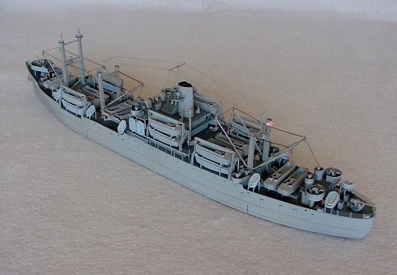

Have finished APA-49, USS Ormsby. She was one of the first war built APAs to enter service and earned 6 battle stars from Tarawa to Leyte. I wanted to show her as she was at Leyte, somewhat worn by 1.5 years in the Pacific.
Pic 1 is the best overall view I found (credit to W. Clarke National Archives). The pic was taken March 1945 after a refit and obvious changes include directors for the 5", more 20mm and the midships mast moved forward from the funnel to the top of the pilot house.
Pic 2 & 3 are the ship.

Have finally finished the 4 C2-S-B1 hulls, An AGC, APA and 2 AKAs. I am amazed at the differences in the ships. They did start out with the same hull.
The first 2 pics show the 4 C2 hulls in process and finished.
Pic 3 is 5 completed APAs. It is interesting how the king-posts line up.
Color, APA-49 (foreground pic 3) is the same color (5-O & 20B) as APA-34 (middle pic 3) yet shows much lighter??? The ships were on a table 6' from a large south facing picture window, the light was not direct but still quite bright. No flash was used. The only thing I could adjust in the future is distance from the camera. I did use the macro setting, the ships were 1' to 2' from the lens.
