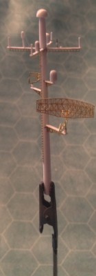

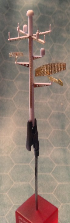

A few tweaks and the mast is ready for paint.

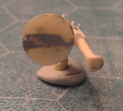

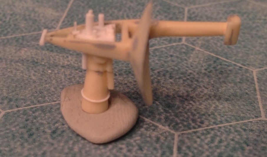

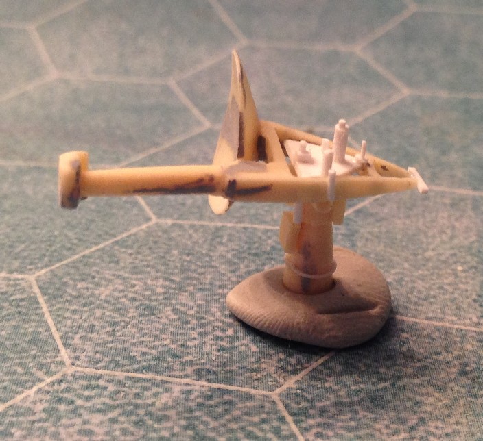

Here's the SPS-30 Radar supplied by IronShipwrights with a few enhancements by me.

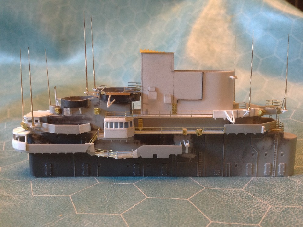

Antennae anyone?
PostPosted: Mon Jan 14, 2013 4:50 pm
Posts: 3125
Location: Hawaii
Needs a few more I think, never have enough :big_grin: Seriously man, awesome work!!!! I'm taking notes for a future CV-9 build I have planned. Keep it up :thumbs_up_1: :thumbs_up_1: :thumbs_up_1:

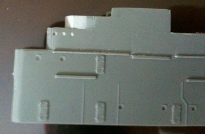

I forgot to post these pics of how I extended a portion of the island so it would flush with the edge of the tub above it.
I put layer after layer of strip styrene over the end of that portion of the island, then sanded down the ends of the strips flush with the sides.

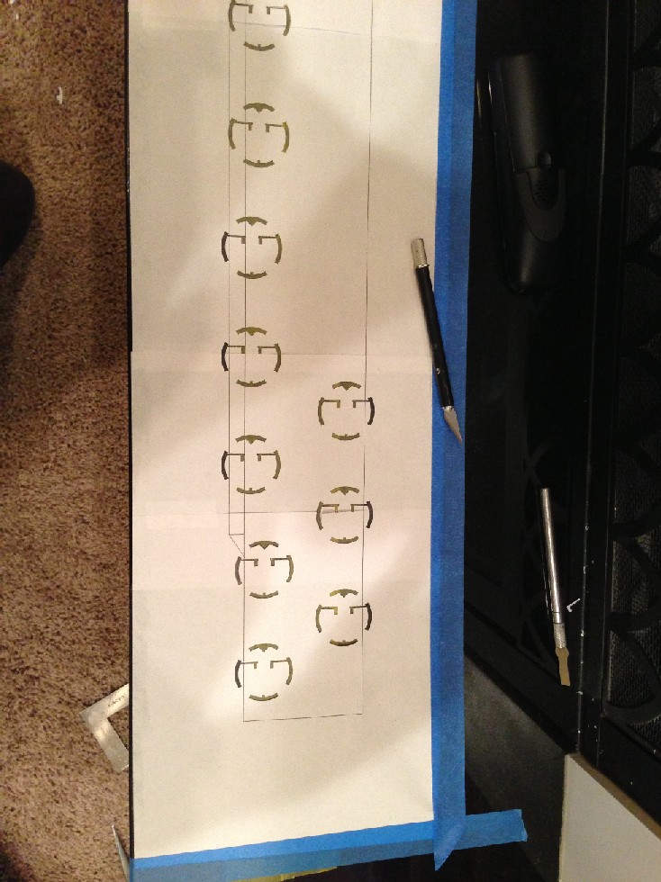

File comment: I created a stencil for the helo landing pads in PowerPoint and cut the stencils out with an exacto knife

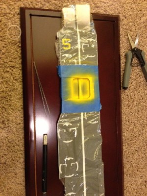

Here's the results of the stencils, I bought some low tack adhesive spray and stuck it down to the flight deck that I'd already glued and painted. I made some "splints" and taped them to the back to keep the glued seems from flexing and cracking.
I also cut a stencil for the ships number on the bow and stern of the flight deck. I masked the yellow paint edges around the centerline elevators in the 2nd photo.
