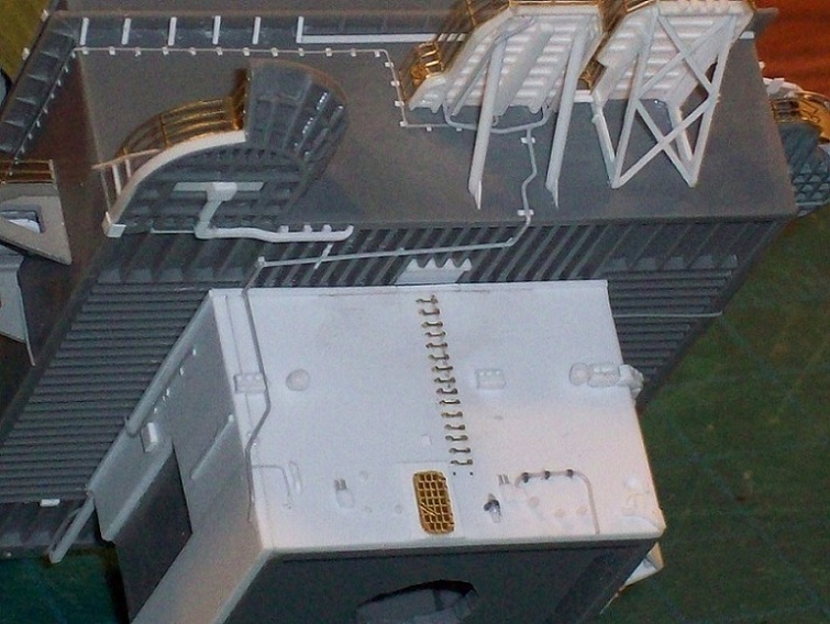

NigelR32 wrote:This is one beautiful build going on...
If I were you, I'd stop looking at HD pictures, they're driving you insane!!
Thanks for the comment and I'd have to agree with you on that one!!!
Bigdaddy Mark wrote:OK, now I need to go down to the basement (Navy Cave) and take a hammer to my Bataan.
I do have a question that's been bugging me since I came back to building ships and I got my airbrush.
How the heck do you paint the walkways and decks after you've added your railings? Or if you paint the walkways first, how do you paint the railings without messing everything else up.
I'm coming to the point in my build that I'd like to know how to pre-build everything like you'r doing before I paint it, I just don't have a clue how to do it.
Thanks Bigdaddy Mark, your Bataan is awesome man. I have been checking it out since you began. I have the WASP kit to build sometime in the future so I have been gathering ideas and watching you guys go to town on detailing these. I especially like that you took the time to light it the way you did. Outstanding work man!
In regards to the painting, most of the time if I pre-build something without painting it first, I know I will be able to go back and paint and mask as necessary without messing up any of the work. On part of the island, I painted some of the decks and masked them off already while I continue to build. I figured it would be too difficult to paint and mask them later so I did it now and then I will just remove the mask later. Another suggestion if you do this is to make your masks in easy sections to remove once you've completed the painting. You may get to a point where you will have to paint some things first prior to assembly and then go back and touch them up with paint after you attach them. I even sometimes pre-paint the railing prior to attaching them. I don't think there is a magic way of doing it. Just whatever you find works for you. Hope this helps at least give some ideas. Thanks again.
