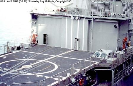

This is the flight deck from the USS Lake Erie, but the configuration is the same as on Spruance class ships.
In another thread it was asked what the Window above the flight deck was for, and what the windowed installation on the deck was for.
the Upper station is Flight Deck Control, and the lower station is the Landing Safety Officer Station.
In addition the four whilte vertical lines on the Hangar door are used to help the Helo line up when landing.

Post by el Cid »
jpdyno2 wrote:This is the flight deck from the USS Lake Erie, but the configuration is the same as on Spruance class ships.
The deck level station is probably the RAST control station, same as on the long-hull FFGs.
HTH
Keith
