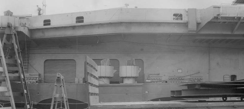

Yes - doing a correct notch wouldn't fix the kit unless they included a deck piece. Here's the photo I mentioned that shows the revised roller doors; note that the piping was laid out around the original plan for the doors. That and the watertight door to the right should help you place things somewhat.
File comment: Port side forward roller doors.

indeed, that is a very nice picture. Tells a lot and I already did my estimates. From my calculations the wide doors would be around 4.2 meters wide (13-14 ft).
Thank you alot

I scanned in the Arpil-May '45 Departure report last year; for those who've not heard of those before, the departure report was filed after the completion of work and listed all of the work that was done, or was not completed. That notch was a quest of sorts, and I finally found the departure report. I was in Alaska last week and was looking forward to getting back and saying "page X, April-May Departure report," however when I did get back, I can't actually find the entry that reports this. Page 17 of 43 is missing, so it's possible I lost it somehow (I'll grab it again my next trip), but I can't specifically state the page number or exact wording at this point, unfortunately. The best I can do at this point is from page 33:

After Stefan pointed out the notch, I started doing my own measurement and came up w/ the same positioning as his outline. I never considered that the notch was not just an extension of the flight deck angle but rather approx 22’ aft. When the notch is measured at this location on the Trumpeter kit I noticed that it would literally come all the way to the bulkhead… That’s when I took a closer look at your picture above along with this picture that I had which I never felt was “conclusive” in clarity.
However in your picture you can clearly see that the notch has in fact been “fixed”. It is very conclusive, you can see the where the 20mm gun positions were left in there after position (as compared to most other Tico’s). So I'd say when you compare the two pictures it's pretty clear that it was part of the overhaul as you stated.
