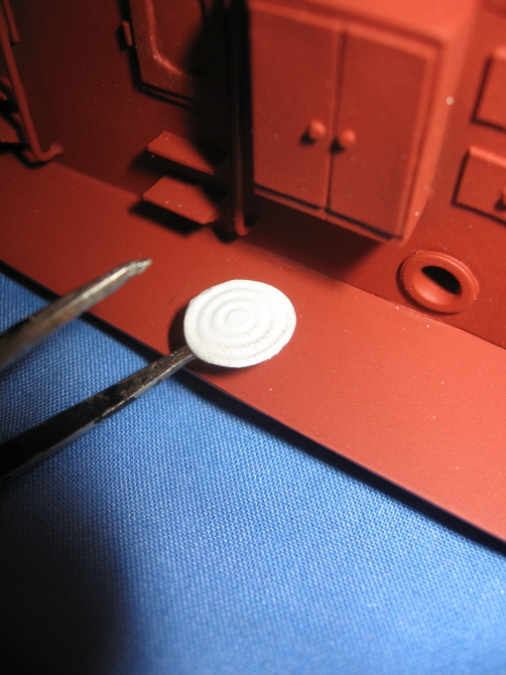

The smaller features were added to the top of the boiler room roof at this point. The flat, oblong sky lights were again cut from the printed sheet of plastic card. Hinges were again made from wire.
The circular flat topped man-hole covers were cut from plastic card and mounted on short lengths of plastic tube turned off on the lathe. I found making these a bore, so I subsequently made moulds and cast some resin ones to this design for the next model, which has lots more of them. The plus side to doing this is they all end up identical. There is nothing worse than scratch building lots of identical fittings, only to find that a couple of them are about 0.25mm out. You can get away with it if they are on opposite sides of the ship but if they are next to each other any small difference stands out and drives you �bonkers� every time you subsequently look at it!
I already had moulds for resin casting the circular dome topped man holes, so they were easy to install. I know these are available as white metal castings, but they are incredibly heavy and fitting 8 or 10 adds considerably to the top weight which is "bad news".
Some of the smaller detail was also added to the top of the WT room. Again the oblong hinged sky lights were cut from the printed plastic card sheet. Small brass wire eye bolts were fitted to secure the stay wires for the funnel and the stove chimney. A black plastic collar has just been installed on the roof to take the stove chimney.
The strange �pudding basin� shaped cast resin fitting is the (pottery or glass) insulator for the wireless aerial. You will see later how it is wired up. This is the first model I have built of a prototype vessel that was fitted with WT, gear so I had to figure out how to make the festoon of wires associated with this equipment dismantle so I could lift off the deck and gain access to the internals. Tricky but not impossible and a bit of fore thought was required. More on this later.

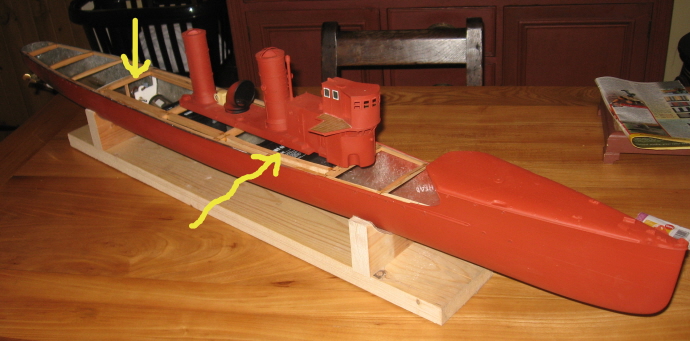

The main deck house structure was placed on the, as yet, un-decked hull to get an idea of positioning. I had already carefully worked out where the main removable deck section would be and drawn it onto the plans.
The factors affecting the limits of this removable deck were as follows:-
Maximum access area was needed to the internal equipment.
Avoiding splitting any main deck detail.
The aft of the two masts was to remain in place when the deck area was removed.
The forward limit of the deck access would be the bridge, leaving the forward torpedo tubes in place.
The small curved tracks along the deck (for wheeling about torpedo reloads) were to be used to disguise the deck access joint.
Indicated on the picture (arrowed) is the limit of the deck access. The gently curved deck support timbers, running fore and aft, follow the position of the torpedo moving tracks. These timbers will produce a register for the removable deck section to sit on.
The removable deck sections on models need not be geometric shapes, any shape is fine and I have made them very odd shapes to steer round deck detail to help disguise the joint.

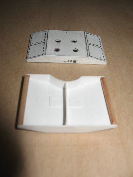

From the plans I transcribed the shape of the large removable deck section onto a sheet of plastic card, the same thickness (1.5mm) as that used for the deck. Onto the underside of this were glued two long wooden strips to give it some rigidity (arrowed). Plastic card was used to install transverse supports, again curved on their top edge to match the deck camber. A plastic strip edge support was also fitted, set in slightly, so that the end result was a neat panel that fitted the deck aperture and sat onto the small register around the edge.
The three holes for the funnels and ventilator were also cut out.
The underside of the boiler room roof/deck house structure had to be gently shaped (by rubbing it along a wooden formed covered with medium grade sandpaper) so that it conformed to the shape (camber) of the removable deck section. With this done the two parts were glued together.
SECURING THE REMOVABLE DECK SECTION.
I fitted a small aluminium tab at the front edge which slotted under the fixed part of the deck as the removable deck section is pushed forward. This held the front down well.
Two small holes were then drilled to take short M3 countersunk brass bolts (arrowed). These screwed into threaded, captivated brass tubes glued into the deck beams below, and clamped down the centre and stern end of the deck section. The screw heads will not be seen. You will see later how they are disguised.
This section of the deck is only removed at home, for maintenance and charging. I never remove it at the waters edge. A smaller more easily removable deck aperture (under the aft 88mm gun) covers all the power switches.

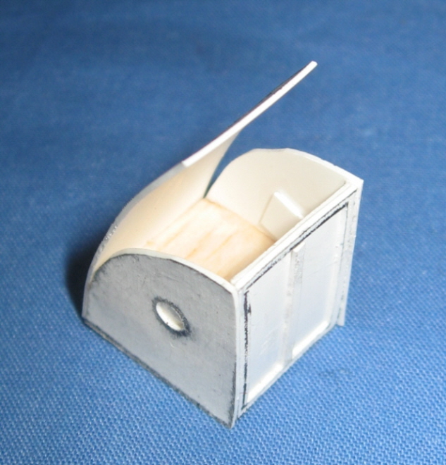

There is not a lot to say about this part of the deck detail construction. It all just boiled down to putting together a series of plastic card boxes of various shapes and sizes. These made up the boiler/engine room sky lights, and various companion ways.
This task was again made easier by having all the components printed onto the plastic card sheets, and as the plastic was only 1.5mm, they were easy to cut out using a scalpel and safety rule.
I did find that giving the companion ways a balsa wood base made them easier to construct and handle, less likely to distort and easier to glue down to the deck. Solvent weld was used to assemble them and CA glue was used for sticking them down.

The companion way just forward of the bridge.
The components of the companion way at the stern.

Along the deck edge there are quite a few circular coaling scuttles. I hate seeing these features modelled with white metal or plastic fittings just stuck onto the deck. This gives a scale lip around their edge of about 3inches on a 1/48th scale model and would have been a massive �trip hazard�! They should of course be flush.
This would entail machining recesses into the deck. I thought this would be messy, so I therefore came up with an alternative. Having turned a metal master/punch for the coaling scuttle, I popped it into a small press and embossed some self adhesive aluminium foil. These thin foil coaling scuttles were then punched out using the correct sized hole punch.
Fitting these was easy. Having pealed off the backing they were positioned and pressed down with the end of my finger, not too hard as this would flatten the embossed detail. When painted and varnished they are permanent AND FLUSH.
Historic note.
Interestingly the prototype vessel was mixed fuel, carrying both coal and oil. One assumes additional steam pressure could be raised by spraying oil onto the burning coals in the furnace. This, together with the forced draught from the blower fan must have created a seriously frightening sight and noise for the stokers.
Fitting the fore deck breakwater. The location marks and rivet detail are already moulded into the GRP fore deck.
The circular coaling scuttles are embossed into self adhesive aluminium foil to render them &quot;flush&quot; with the deck.
The circular coaling scuttles are embossed into self adhesive aluminium foil to render them "flush" with the deck.
