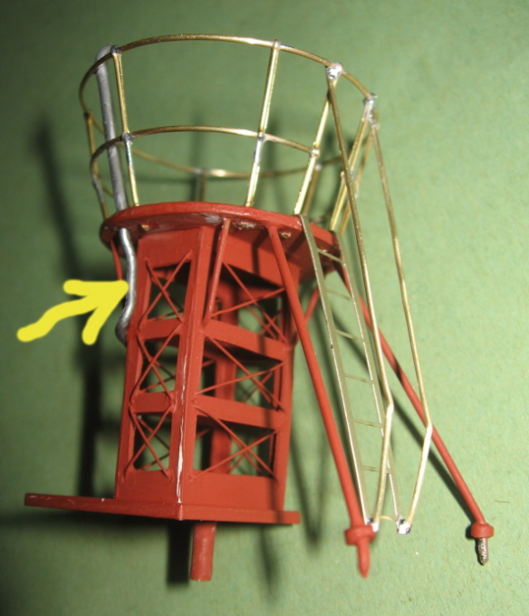

The next piece of detail to be dealt with was the compass binnacle/bandstand mount, amidships. The basic lattice framework was again from my printed plastic sheet, with the cross bracing added using nylon mono filament.
The circular platform was a little flimsy and too flexible in 1.5mm plastic card alone, so I stuck it, and the raised aft deck over the tiller, to some 0.5mm plywood for additional strength.
The steps, stanchions and voice pipe (arrowed) were added, the latter made from (lead wire). This whole unit was mounted on a plastic card base which could be lifted off. This covered and hid the small countersunk bolt, which holds the rear of the main removable deck section in place. It also helped disguise the joint in the deck.
The last picture shows this in place. The more observant and knowledgeable of you will notice that the ventilator cowls are completely the wrong shape! Their mouths should be a sort of inverted tear drop. This detail showed up in subsequent research and vac formed replacements are currently being manufactured to correct this.

The lattice frame work of the compass mount was from the printed plastic card sheet, with cross braces added.
The bandstand mount was fitted to a plastic card base. The voice pipes were added from lead wire.

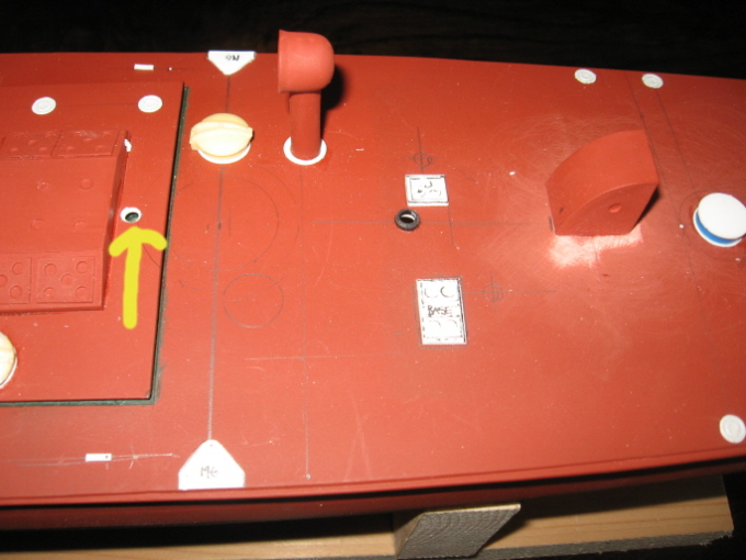

Before manufacturing and installing the torpedo tubes I concentrated on some of the smaller, surface mounted deck detail. The torpedo tube races (sometimes called racers) were made from square section aluminium strip. This was formed around a paint tin of approximately the correct diameter, matched to the plans and trimmed to length before being gently bent to match the deck camber. CA glue was used to fix it in place.
The small white circles represent the glazed deck lights. These were punched out of self adhesive aluminium foil, embossed slightly and are practically flush with the deck.
The arrows indicate the positions of the two countersunk bolts which hold down the removable deck section.
One of the man holes was raised higher than the others to clear the boiler room sky light and on the model this was reproduced by adding a length of (blue) plastic tube to a cast resin man hole.
The positions for a lot of the deck detail have been transferred from the plans and pencilled onto the deck.
The triangular shapes at the deck edge are the mounting positions for the Maxim machine guns.
The hole (with a black collar) is the position for the aft mast.

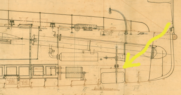

The rudder on these vessels was hung over the stern, the same arrangement as on my previous model HMS Velox. By a great piece of luck the shape of the rudder fitted to V105 was almost identical.
As I had decided to cast the rudder for HMS Velox in epoxy resin, I was able to use the same mould, and cast another for this model, modifying the profile slightly to match the plans for the German torpedo boat.
The same casting process previously talked about for producing other fittings was again employed, with RTV silicon being poured around a master of the rudder. The master was shaped to an aerofoil cross section and plate lines were added again using aluminium foil.
The finished silicon mould was mounted in a plastic card frame to support an M3 stainless steel shaft. This also formed a strengthening armature when encapsulated within the resin.
The resin was poured into the mould with a second (arrowed) hole allowing trapped air to escape.
After trimming off the casting sprue and correcting the profile to fit the German vessel, the rudders stainless shaft had a flat face filed onto one side, while the aluminium tiller had a corresponding �D� shaped hole cut into it. Two stainless M3 nuts (one above and one below the tiller) locked the two components together. The top M3 nut is seen on the model but photograph of contemporary vessels show HUGE locking nuts performing the same task, so I considered it scale detail.
It was difficult to get the rudder fulcrum correct, so the fitted rudder was quite �sloppy in its movement. I did not want to overload the servo or the linkages.
A clear plastic rudder extension, in the photographs, slots over the rudder when the model is rigged for sailing. The rudder, on its own, gives a �scale turning circle� i.e. BIG! Not a problem on a large sailing water, but I wanted a bit more control to sail safely alongside other vessels on more restricted sailing waters.

RUDDER ARRANGEMENTS
I thought I might include a few thoughts about the rudder arrangements on this and similar vessels.
I decided to fit the transparent rudder extension to improve control and reduce the turning circle. This was as a result of having gained experience of using rudder extensions on working scale sailing models. V105 sails fine without the rudder extension, performing beautiful, graceful, scale turns but allowing insufficient control to avoid other models getting unexpectedly in ones path.
I could of course have fitted two ESCs (speed controllers) and possibly a mixer, to use prop thrust to aid steering. Limited hull space and buoyancy ruled this out, plus I wanted to keep everything as simple as possible.
The prototypes of both this vessel and my previous model HMS Velox were fitted with retractable bow rudders, and I did consider fitting these to improve control. In the end I thought that the advantages would be outweighed by the possible problems. Having said that, my next build (the 1890 Russian Torpedo Cruiser Kazarski) has only one screw and I have decided to fit a bow rudder to this model as an experiment. The image shows the normal bow rudder arrangement, in this case on an earlier German vessel and on this plan the rudder is depicted in the retracted position.
I plan to fit a second servo near the bows connected to the main rudder channel with a �Y� lead. The bow rudder will not be retractable but will be removable. Its movement will be restricted to about 15 degrees to either port or starboard.
I would be pleased to hear from any other modellers who have first hand experience of both installing and using bow rudders on working models.
Normal bow rudder arrangements.
sandy
Posts: 330
Joined: Sun Nov 14, 2010 4:54 pm
Re: 1/48 German Torpedo boat V105 (1914)
Post by sandy »
Hi Steve,
Strangely, I was thinking about bow rudders recently if I model of either an Elan or Chamois class aviso drageur. Both show bow rudders of the blueprints, but, at least the Chamois class, didn't have them fitted. The rudders did not extend but sat in a sort of 'hole' in the hull right up by the bow and they were quite large.
I thought the fitting of them would be an interesting exercise, but they would be more like a big bow thruster hole, with a rudder extending down into it. The truning angle would need to be quite large as so that the 'tail' of the rudder came far enough out of its recess to deflect waterflow.
I do remember that many, many years ago due to the dreadful turning circle of the old 48th scale Clyde paddlers they fitted extra large rudders in clear perspex but they were fixed rather than removable like yours, which is a great idea.
If you want I can cut and paste some extracts from the prints and post them up when I get home.
All the best
Sandy

Sandy
Yes, pictures please, as I'm a bit intrigued by this.
I thought I could make the bow rudder with a brass shaft. This would push up, into a brass tube lined with a length of silicon pipe. The brass tube would be attached via a linkage to the servo. Obviously each time the bow rudder was installed, I would have to check it was aligned and synchronised with the stern rudder by turning it manually within the silicon pipe. Removing it for transportation would reduce the chance of it getting knocked off. Grounding would however be a problem in very shallow water.
sandy

Here you go:-

Sandy
Very interesting. A little less prone to getting damaged with it being recessed into the hull. I would certainly model it as a working function. Some experimentation would be needed to work out the limit of the movement. I plan to site the servo for the bow rudder well back in the hull connecting it with a long connecting rod to the rudder mechanism hidden (and once installed inaccessibly) up in the bows.

Post by PICKETBOAT »
Hi all
The deck detailing continued.
I had worried about the two steel lattice-work supports for the bridge wings. I knew the joint of the lift-off section of the deck would be beneath them, so the dilemma was, should they be attached to the hull or to the lift off section? In the end I decided to reinforce them and attach them to the hull.
The picture shows the model, still lacking much deck detail and in red primer. The lattice-work bridge wing support, so much a feature of many German destroyers of the period, are arrowed.
They were printed out on the 1.5mm plastic card sheet, so I carefully cut them out and glued a bent brass wire (1.5mm diameter) to their reverse edge. This in turn was inserted into two holes in the deck and glued in place. As both supports were now quite solid I was able to slide the removable deck section into place, with the bridge wings sitting on top of, but not glued to the supports.
Two small crane type hoists were situated on the deck amid ships, port and starboard. These were used to hoist torpedo re-loads on board. The re loads would have been lowered onto a small trolley which ran on the rails along the deck. These two cranes would probably have lent themselves to being etched in brass but I do not have access to this equipment so fabricated them from wire and off cuts.
The navigation lights are resin castings, like the anchor crane, which was covered in more detail in a previous post. These have been painted prior to fitting.
The lattice work supports for the bridge wings remain fixed to the deck while the bridge and boiler room roof lift off.
The lattice work supports are reinforced on their reverse.
