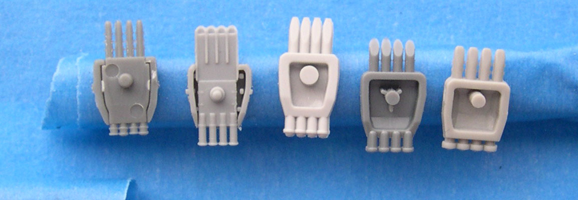

Today's comparison is specific in nature, addressing only the quadruple Type 92 Mod 4 torpedo mount for the Type 93 "Long Lance" torpedo. This comparo comes about because I'm working on units for my 1/700 Yugumo builds. The quadruple mount was a development of earlier twin & triple mounts; the Mod 4 indicates a covering spray shield for the mount, assymetrical in shape with the housing enlarged a bit on the starboard side. The earlier Shiratsuyu and Asashio DD classes also carried a Type 94 quad mount with a Mod 3 shield that was a bit more boxy in silhouette, and possibly symmetrical. The Type 92 Mod 4 was used on the Kagero, Yugumo, Akizuki, & Matsu/Tachibana class DDs, and on the Agano class CLs.
The Type 93 torpedo was 9m in length (29'6") & 61cm (24") in diameter. In 1/700, that works out to a length of 12.85mm. The actual tube was slightly longer, to accomodate a hatch at the aft end, so I would conside 13mm an appropriate scale length for a 1/700 version.
I don't have an original W/L mount lying around from any of the initial DD kits by Aoshima (Kagero), Hasegawa (Yugumo) or Fujimi (Akizuki/Matsu). Suffice to say they were basic in shape, devoid of detail, and only the Fujimi versions had any assymetry, IIRC.
The W/L consortium created the new Leviathan weapons sprues (still included with all Aoshima, Hasegawa and Tamiya kits), which included a new Type 92 Mod 4 mount with more detail and and an assymetrical shape. It's primary drawback was length, as it was 2-3 millimeters too short. PitRoad had released its own version just prior to the Leviathan release, with more detail, but also too short.
When PitRoad released new IJN DD kits in the early 1990s, it also released the E-10 equipment sprue with a newer version of this mount. Thankfully, it was now the correct length, but still symmetrical in shape, and detailed only on top. Fujimi released it's own Kagero class tooling in late 2010, with a two piece mount (housing and base), that bettered the E-10 version with a little more detail and the addition of a hatch on either side, but it's far too symmetrical. Recently, PitRoad released an updated three piece version as part of both of its new NE04 and NE05 equipment sets. I believe it to be the best version, as it is correctly shaped, length, and detailed on all exterior surfaces. It even has a molded set of four torpedo warheads that fits neatly up into the forward end of the mount.
Unfortunately, all versions have incorect bases. The base was formed in the same manner as that of the main gun turrets shown earlier, covering the entire width of the mount. All of these are far too narrow, though they fit their specified target kits as designed. FineMolds is set to release it's own version this July, so it will be interesting to compare that version to these.
Mount identification is included with each photo caption
Fujimi Kagero, PitRoad NE04, PitRoad E-10, W-L consortium, PitRoad E-2 top.JPG
Fujimi Kagero, PitRoad NE04, PitRoad E-10, W-L consortium, PitRoad E-2 front.JPG
PitRoad E-2, W-L consortium, PitRoad E-10, PitRoad NE04, Fujimi Kagero back.JPG
Fujimi Kagero, PitRoad NE04, PitRoad E-10, W-L consortium, PitRoad E-2 bottom.JPG
