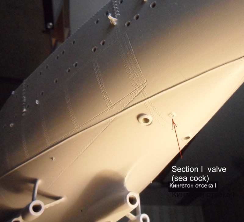

Hallo!
It is time to see and critique the section I (0-21,5 m) of my Bismarck hull.
(Note: there are details – on the hull and the upper deck- which will be installed after final painting.)
Best wishes!

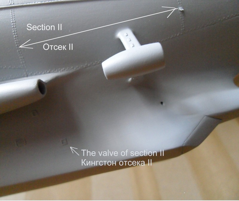

Now - the section II views.
Have a nice viewing!
Anatoly

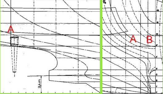

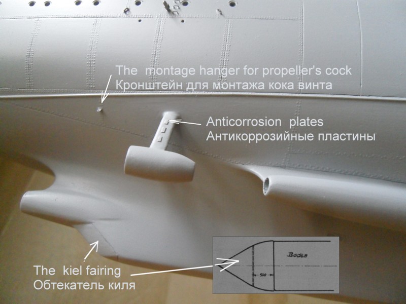

PostPosted: Tue May 21, 2013 8:37 pm
Posts: 5062
I am reluctant to criticize such an elegant and detailed hull, but it does appear that the stern in the rudder area and aft may be more V bottomed than the accompanying photo suggests.
Might be the lighting?
T
PostPosted: Wed May 22, 2013 10:21 am
Joined: Tue Oct 12, 2010 6:17 am
Posts: 95
Location: The Peter, Russia
Hi, Fliger!
Yes, you are right-there is a small distortion.
As I wrote before, I took the Hachette partwork as a base. It was my big mistake-the partwork has lots of distortions! I spend many time to correct them-if it was possible.
Also in the area you mentioned.
Please, have a look at picture 1. It is a part of very detailed drawings - and the section marked "A" shows us a almost flat surface close the ruders. Also, pay attention on the line marked "B". The line is "unlogical" - on my opinion
I tried to improve the distortion - but without a complete success!
The picture 2 shows the area in more "profitable" light.
With best regards-
Anatoly

PostPosted: Wed May 22, 2013 1:12 pm
Posts: 618
The frames around the rudders are ok, but the frames towards the stern are too pointed at the bottom creating a "sharp" edge at the center keel line. See the small insert of the BA photo adjacent to the model stern in one of the posting above. Also the MES was located differently on the stern. But these points are hard to correct with all surface details already in place.
Still beautiful work!
