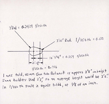

Hi Everyone,
I spent a couple hours scaling down and drawing the Centerline Teardrop 40mm bulwark in 1/350th scale for PetrolGator. He's planning to build the USS Johnston DD-557. Since I don't build in 1/350th scale I figured I would post the drwaing here for anyone to use.
40mm Tear drop Gun tub 1-350th scale 5-28-2013 lr.jpg [ 108.36 KiB | Viewed 2768 times ]
I used this drawing as a guide to scale down the particular gun mount area to 1/350th scale.
I would use .020 styrene stock for the base and 1/8 x .010 styrene strip stock for the bulwark.
The Mk-51 gun director foundation is 5' 2 1/2" in diameter. In 1/350th scale that equals 0.181 diameter and 3/16 of an inch could be used and not be out of scale much at all. 3/16 is a standard styrene rod size, that's what I would use.
The drawing is full size and all you have to do is print it. When you cut it out, cut away the line to make it right to size :big_grin:
Roger DD-473/DD-555 :wave_1:
