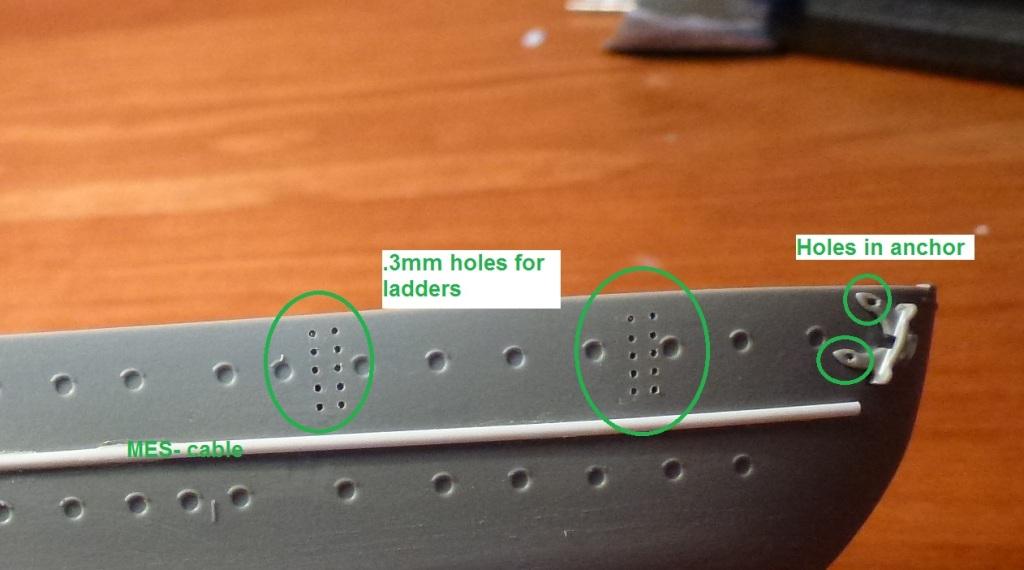

Well – let’s get to it..
The hull needs to be modified and “improved” in the following places:
- Look at Scharnhorst’s bow compared to Gneisenau’s.
You need to fill the hawsepipe/hole for the anchor and use small files to make openings for the cable/rope leads.
Also make loops from stretched sprue for mooring point close to the surface.
The bow also needs sharpening as it is far too thick: Use tough sandpaper and sand it down. Fine sanding with 400-800-sand paper.
- Scarnhorst has got almost two rows of portholes along the hull, Gneisenau has almost only got one (except for the bow and the stern area which has two. You need to fill in a lot of portholes!
- Dragon totally forgot about the MES (Anti Magnetization System against Magnetic Mines) – the “stripe” along the hull.
In my Scharnhorst I used .8mm round brass tubing and glued it down. Hell of a job!
Now I have found that Plastruct has got a half-round .8mm polystyrene strip available.
This makes this job piece of cake!
- To further improve the hull you may drill out the openings in the anchors and scrape away the “handle-bars” close to the stern. I replaced them with PE-handles from my previous Tirpitz-build. To do this, drill holes .3mm, fill with glue and place the handles into the glue.
- Scharnhorst has got 2 relative large openings for waste water on Port side and one on Starboard side (no picture here, but you’ll find lots of pictures of this).
From my pictures I can only make out one on Starboard and non on Port side in Gneisenau.
I hope I’m right, because I carefully scraped away the two on Port side..!
Since my Scarnhorst is built waterline in a scenario, I decided I wanted my Gneisenau to have full hull and be placed on stands.
It really was a lot of sanding to conceal the gap between upper and lower hull-halves (and still it’s far from perfect…)
Did I forget anything?
Yeah- remember to "beef up" the area below the cutouts for the anchors on each side. This is done in my model by using 2K epocy - and as always: lots of sanding!

Artwoxmodels also deliver a clean wood sheet in the same pattern as the Scharnhorst deck. This is absolutely a must as the planked area in Gneisenau is much larger than the one in Scharnhorst (more about this later).
Deck installations such as ventilators etc are not quote similar in the two sisters. I have corrected for some of this, but not all as that would produce too much cuts and holes in the original deck.
I closed up opening for the large ventilators at the base of B-turret, made some deckhouses from white plastic rods/PE and positioned the 30+ ventilator houses (from an old 1:400 Heller Scharnhorst) in their correct (?) places.
Templates for Swasticas were cut out in Tamiya tape. Spraying right onto the deck is nerve-wrecking, but everything went OK. :big_grin:
