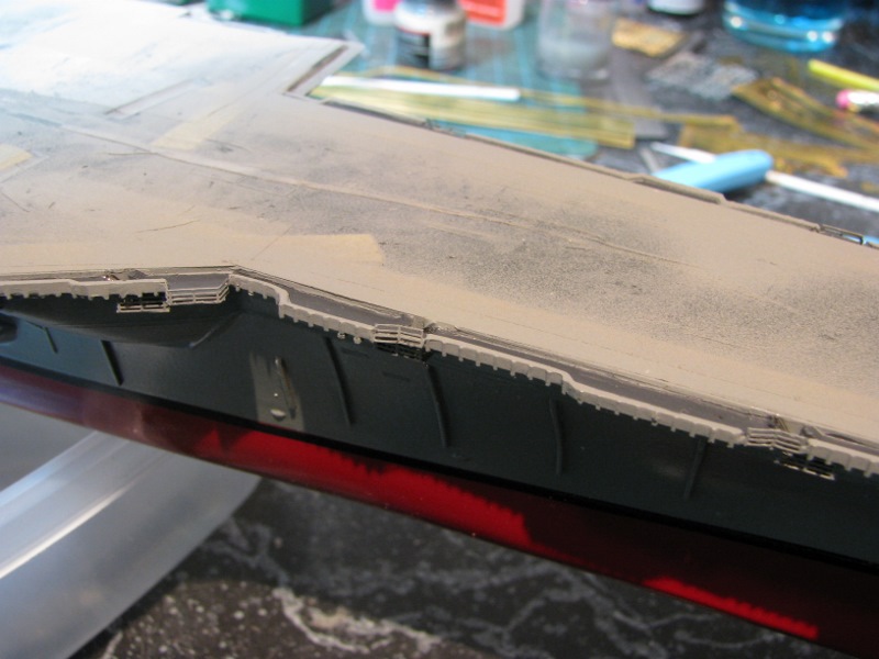

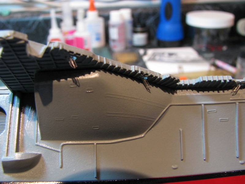

Finished up the railings all the way around...
Ready for painting of this assembly.
Scrolled back in the photo folder and threw in a little before & after...
BEFORE
BEFORE
AFTER
AFTER
Ready for paint
Ready for paint

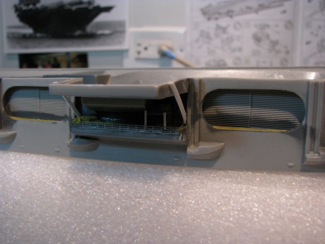

Cemented the upper and lower hull sections with super glue from the inside; note the bent micro brushes.
Filled the gap at the bow.
Provided dry-fit comparison to the actual area starboard and aft of the superstructure�crane is not perfect, but much better than the kit part � provided before and afters
Cleaned up and masked the elevators
Masked/prep�d the lower hull, the crane, the Mk 25�s, a lifeboat, and the fesnel lens (the ball)
Created life raft baskets from short-stantion rail from the WEM CV-6 PE set.
dry-fit area starboard and aft of the superstructure�crane is not perfect, but much better than the kit part

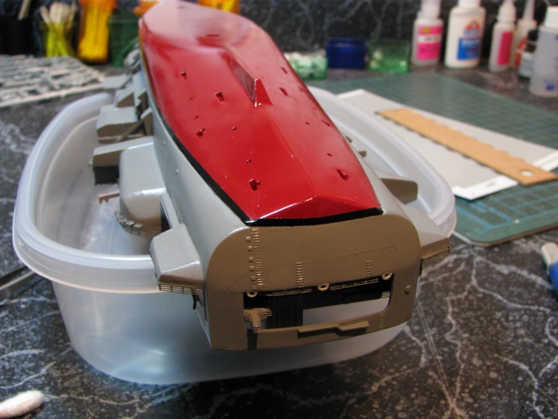

Finished masking the flight deck edge walkways with Tamiya tape and Parafilm, and painted the edges and bottom of flight deck gray.
Coated the hull with Future.
Then used Microscale 1/16"" Black Stripe decals to create the boot stripe between gray and red sections of the hull.

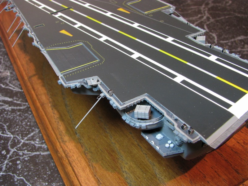

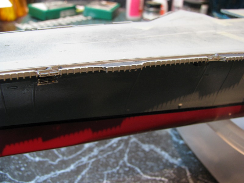

Been spending some nights at the bench....
I attached the flight deck. Then got all the PE ready to go. I started with the safety nets on the elevators, then at the bow, stern and end of the angled deck. After painting I cleared blocked holes with a straight pin.
I had removed the molded-in stairways back before I painted the deck, now I made all the stairs (22 of em) and pushed them through the openings and tacked them with a touch of super glue.
Next I put a door at the bottom of each stairway. Then I made the railings and glued them over the stairs and doors.
Then I cut catwalks and glued them over the railings from the bottom (ship upside down)
Next I did more railing in various spots around the sip where required.
Then painted everything and touch up the whole walk way around the deck.
Next will be the hose reals and lifeboat baskets.

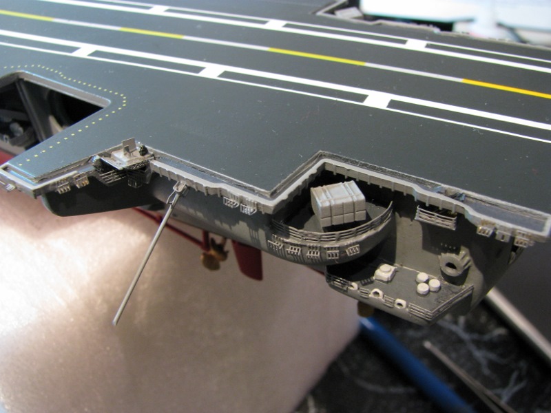

More pics of PE stairways and railing as described above.

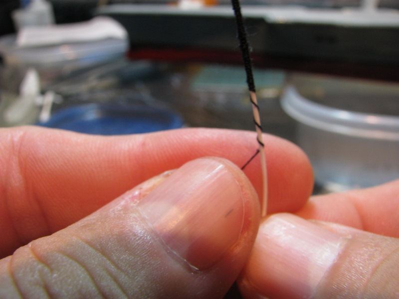

PE Hose Reels:
Bent the stands and glued one reel side to the stands.
Twisted black thread around .1oo� / 2.5 mm plastic rod and coated in thin super glue.
After the dry, sliced thread/rod with razor to simulate hose.
Then glued other reel side to hose slice.
Glued reel side / hose slice into other reel side /stand.
Dry fit first one in place on forward port side.
Twenty-something more to go.

So with the deck complete, it was back to the flight deck edge detail. I�m glad I decided to do the deck decals first as I knocked off the PE safety nets aft, port, and on a few elevators while decaling.
I decided to start with the recently discovered Basic Point Defense Missile System (BPDMS) director devise and its platform on the starboard side. Thanks again to forum member Charles Landrum for the excellent references. I again stole from the CV-62 Indy kit and adapted its platform to fit, notching the rear lower corner to fit the edge of the deck below the superstructure.
I then scoured the spares box and leftover PE. After a few attempts I came up with what you see in the pictures. From the 1/700 CV-6/CV-8 PE leftovers, I cut out part of an AA gun and two airplane wheels/struts. I bent back the struts and glued the trimmed wheels to the sides of the AA section to simulate the BPDMS. I glued that to a small spare plastic sprue for a �stand�. I drilled a hole in the top of the platform to receive the stand.
With my razor saw, I then sliced a slot 270 degrees around the platform. I cut 3 sections of safety net to size from the spare PE from the GMM CVAN-65 PE set, and slide them into the slots with a touch of glue.
Then I added 2 support posts and dry fit the structure. Now I just have to paint it and attach.

Finally got to spend some quality time at the bench during the long holiday weekend.
Finished up all the antennae, and placed all the PE lifeboat baskets, then hand painted them all. I worked the deck color, MM36076 Eng. Gray, into a ball of sticky tack with a spackling knife and let it set up for a few hours. Then I worked balls of it into the baskets to simulate the folded canvas/rubber life boats.
I simulated the rack of 4 light gray rectangles on the starboard side with PE catwalk and sections of square styrene rod.
I glued the scratch built crane parts into place and stretched fishing line between beads of superglue to simulate the cable and hand painted these parts in place.
Placed all the hose reels. (2 are yet to be found in the nooks and crannies around the floor of the shop!) Truth be told, I�m not crazy about them. They�re clearly not to scale. Kind of wish I�d left the molded ones�.but live and learn.
I glued the Basic Point Defense Missile System (BPDMS) director platform in place on the starboard side and I made the saluting guns out of spare PE.
Being pretty much done with the edge detail, I placed the ship on the finials on the oak base and took pics from 360.
On to the superstructure. And from the initial dry-fitting, it�s gonna take some work�.
