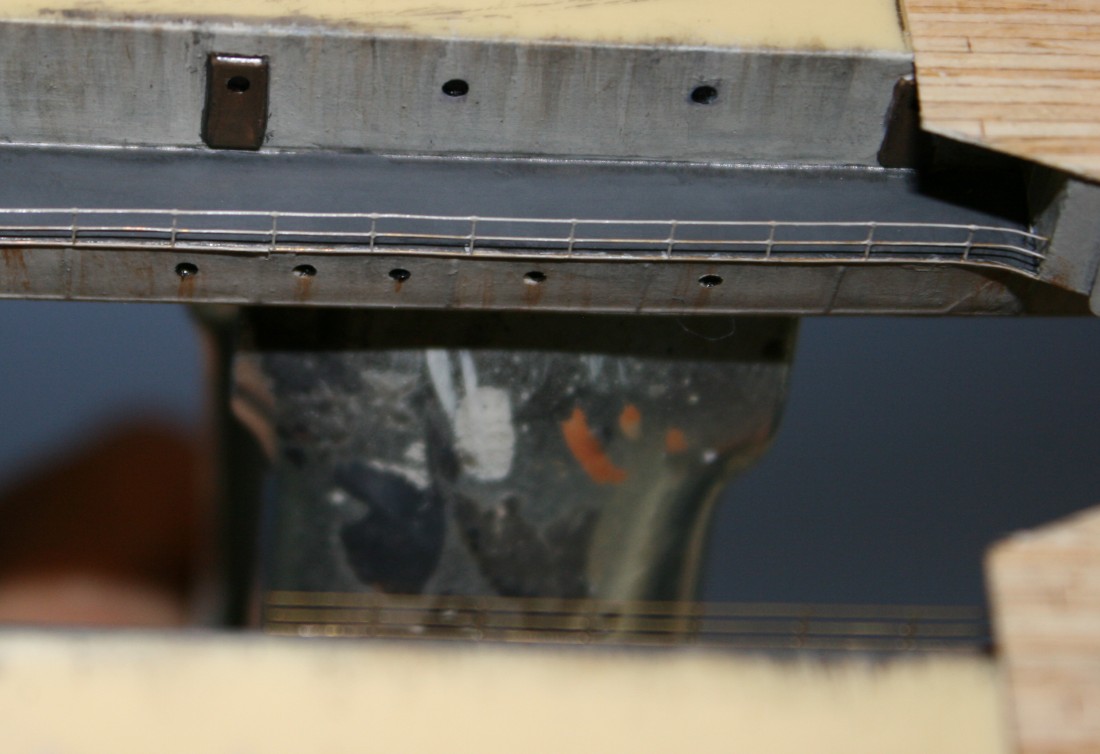

and we are painting.....
It takes much longer to simulate the neglect of a ship at the end of her life.... ( flash photography is never complimentary to models!)
There is a theme going here... :cool_2: what am I planning...? :scratch: :cool_1:
see if you can guess....
small quiz
the clue is... Turners ' THE FIGHTING TEMERAIRE'
:wave_1: JIM B

A useful view of the fwd area of the inner area between the hulls show that there are some missing portholes in the inside faces of the hulls,
as well as some seemingly structural beams which look like they will support the fwd deck
which I am in the process of adding- ( none of which are discernible from the plans)
-along with a solid bulwark in the forward curve

The next task will be to add the porthole windows that can be seen on the inside faces of the hull sides
as seen in the above photo
--then onwards to railing before the upper deck can be applied
