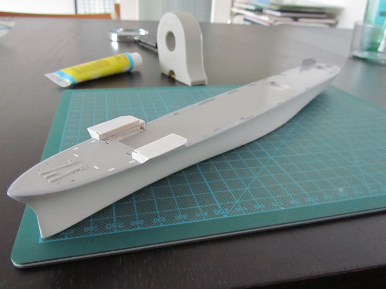

Hi all,
First time post here. I have been reading and re-reading many topics in this forum. I have learned a lot form the people posting here. I used to build scale airplane models some time ago, but I always wanted to make ships. This is my second ship as the first one was a study to measure if I was going to be able to work in 1/700 (space constraints). First one was an Arizona in 1/700 and I always wanted to have a Hornet CV-8.
I read several times the CASF topic on the Hornet and found out about the hull problems with the Trumpeter kit. I said well "how hard could it be to correct it?"... well, it was harder than I thought (spent a couple of months sanding). So I started making a new hull using Paul Budzik's technique (Thank you a lot for publishing your technique) and surprisingly, my implementation of it came out to be OK (at least, I am happy with it). I am still in the "shaping" process with fine sandpaper to give it a smooth finish. Now I have where to start if I want to have a CV-8 in 1/700
Thank you also to everyone at the CASF for CV-8, CV-6, and CV-5, very knowledgeable people out there.
P.S. I like full-hull...

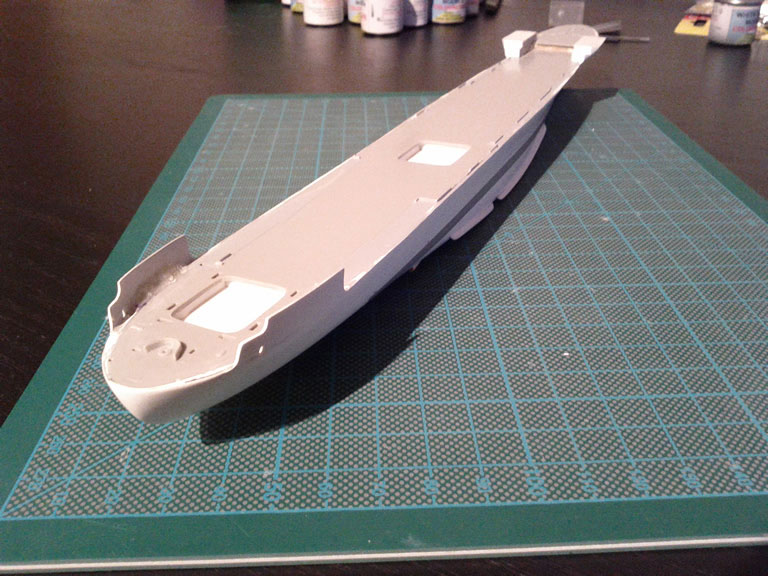

Hi everyone,
Long time and small update (Sorry for the quality of the pictures, my camera is not working properly).

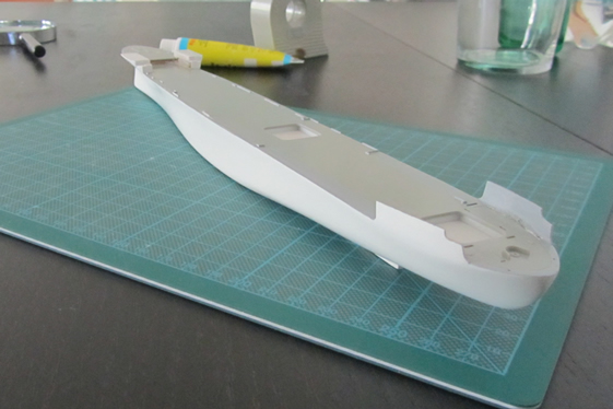

I added the bilge keels, armor belt and shaft exits to the hull.
It is now time to add portholes, but I am going to try the PE portholes to see how they look. (Still waiting for them to arrive)
In the meantime I made the propeller shafts with their supports, the Trumpeter ones are too short and not properly formed.
Also I started modifying the island to make it look more like the CV-8 Hornet (it is still not glued together)
Once I get to the portholes and be able to keep my sanity, I will post more pictures.

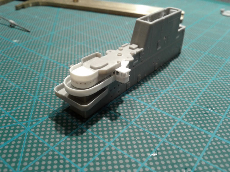

I have been having trouble implementing the Hornet pilot house (it is not symmetrical). Still working on it...

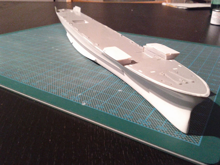

Hi everyone,
Very small update.

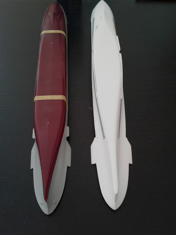

I got a new Trumpeter kit (I really like the airplanes it comes with...) and I can now take a comparison picture of the hulls.
As you can see, I already started adding the PE portholes. I am fixing them in place with future as I read somewhere in this board, I am happy with the results and for me it is easier to keep a straight line like that. After they are done I will drill some of them.
One thing I noticed on the Trumpeter kit, is that *maybe* they tried to fix something on the hull. I don't remember noticing this on my first kit. In the picture below you can see what it looks like a mold insert (I am no expert on this topic). You can feel the "step" on the hull and *maybe* it feels narrower.
Of course it is still wrong, and maybe I am just imagining things.
I am working more on the island now, and will update this thread when I have more meaningful progress.

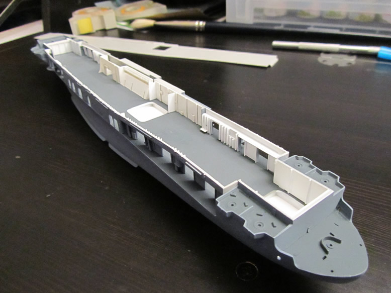

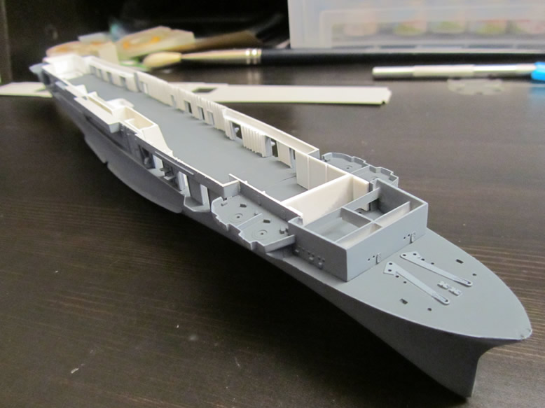

Another small update. Some preliminary base painting with 5-O (check for errors, polish here, there..). I shortened the height of the hangar deck bulkheads, the Trumpeter ones are around 0.7 mm too high. Some out of the bulkheads and some out of the flight deck. It was an easy detail to add (or remove).
I added some generic detail to the hangar deck using other builds published here and a couple of photographs online as reference. I took some liberties on it but I think what is to be seen once the flight deck is on is minimal (you can only see that "something" is there, not ejection pin marks).
Next, the Ms12 mod camouflage masking...
Thanks for watching, comments and criticisms welcomed!

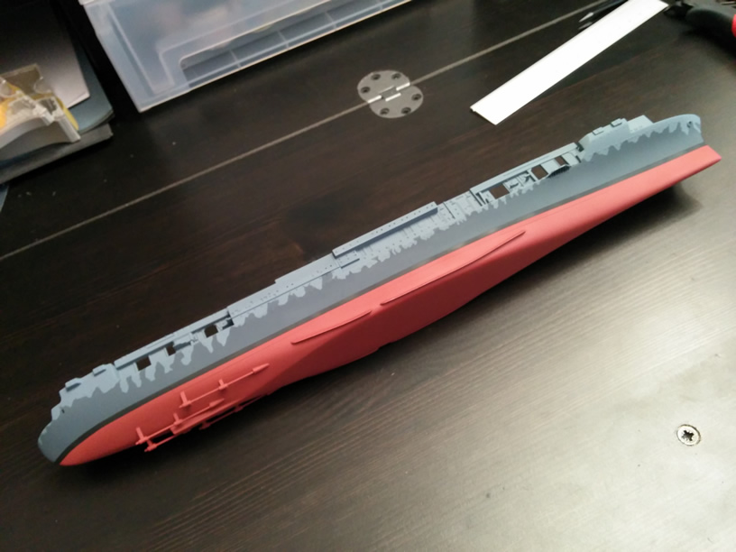

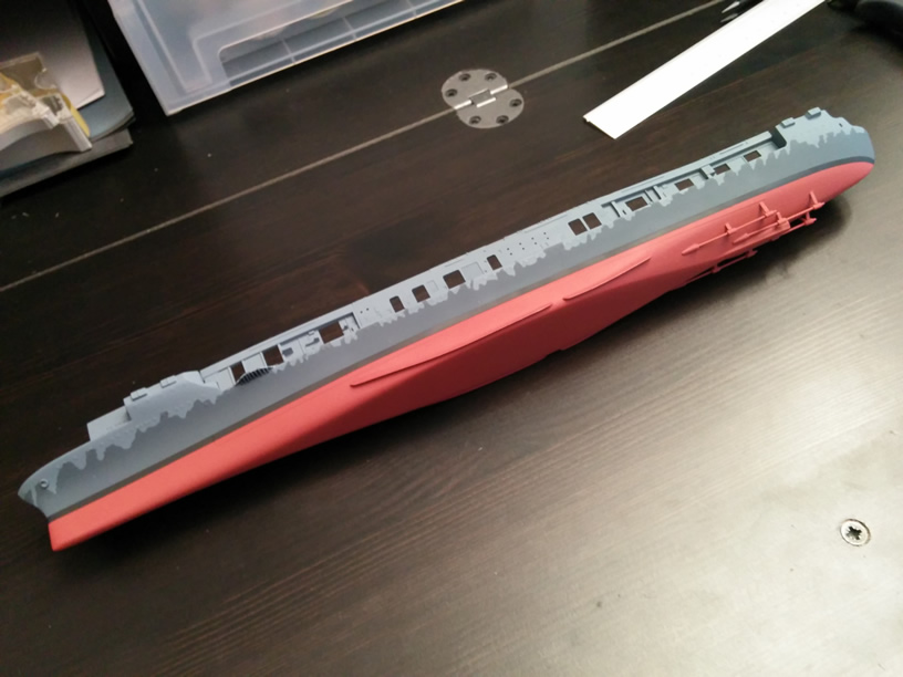

So I did some masking and painted the Ms12 mod on the hull. A picture of the process and the result.
Masking:
Masks lifted:
Next, some light weathering and shading. Then the flight deck and finishing the island. In between maybe some airplanes...
