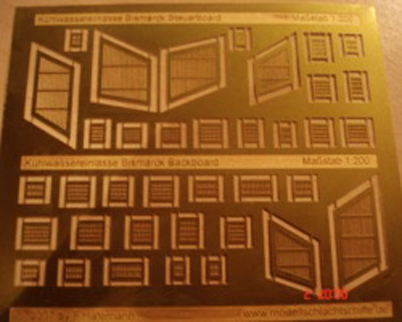

I found this GREAT German website for 1/200 German Navy builders. There is a lot available here, including those 1/200 photoetch gratings you need for the cooling water inlets in the Bismarck hull!
http://www.modellschlachtschiffe.de
As you navigate around the site, you can't help learning some rudimentary German. For example "Rumpf" means "hull" and "Rumpfzubehor" means "hull accessories." The 1/200 Bismarck photoetch "K�hlwassereinl�sse" (cooling water inlets) are listed under "Rumpfzubehor."
The owner, Florian Hafemann, states emphatically "No PayPal." He requests "Bankueberweisung" (Bank Transfer) as payment which is commonplace in the EU, but horribly expensive (prohibitive) from the USA.
I wrote a VERY respectful E-mail letter to his "Contact" page in formal German, pleading my case for a PayPal purchase, and he agreed. I'd suggest a similar, very respectful approach, if you can only write English.
He cites 4-6 weeks for delivery (Herr Hafemann explains things are painstakingly produced in small production runs) and shipping cost is EU 15,00 (about USD $20.00) for a small package of several items. Postage to and from Europe IS expensive. :wave_1:

Or.. just hit the english language button on his site. I ordered some stuff from him on Friday, am currently waiting for the payment request.

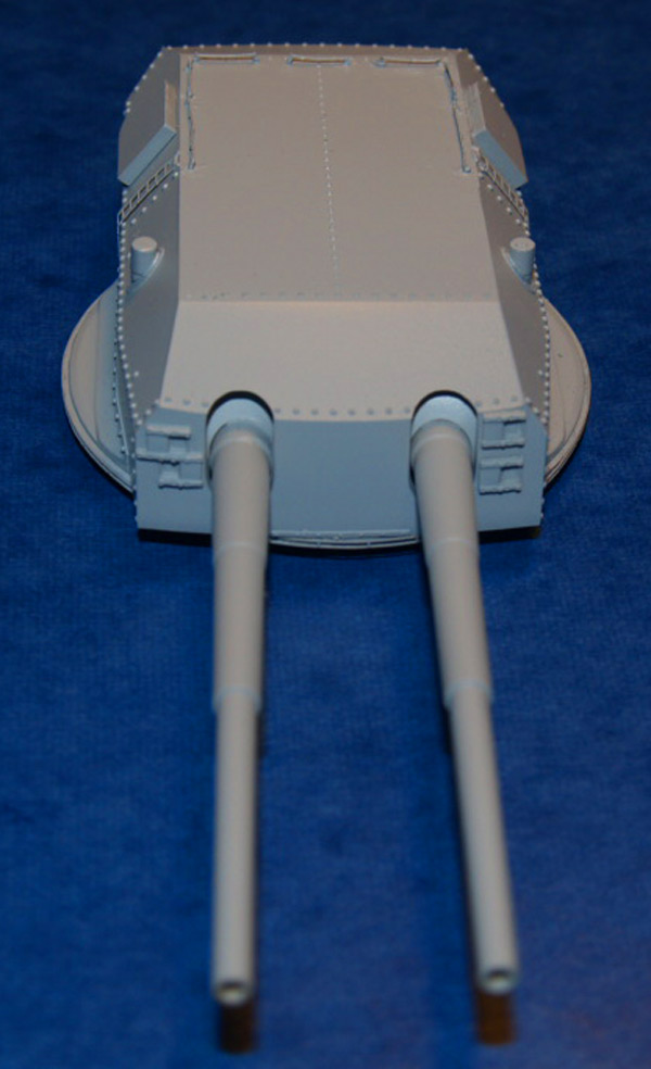

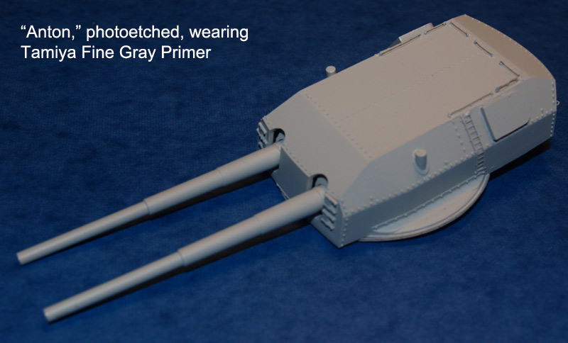

I started building the 38 cm turrets. It's pretty straightforward, but my eyesight is not as good as it once was and my hands not quite as steady as they once were when handling tiny photoetch parts. This is going to demand some time and willpower to get through! Anyway, here are some photos of my progressing turret builds.
"Anton" has completed photoetching and is wearing Tamiya Fine Gray Primer.
