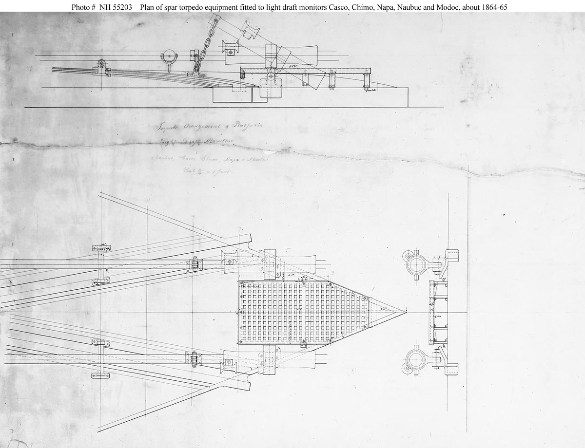

Yes. That is what I have based the torpedo equipment on. Thanks much.

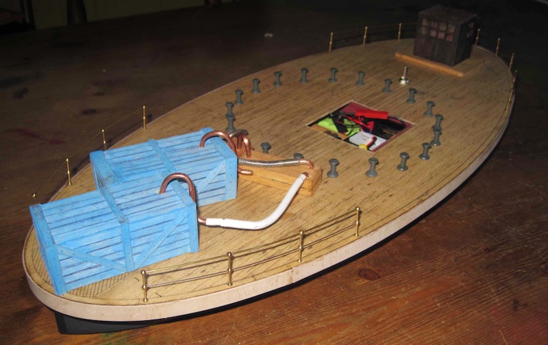

I attach a few photographs of the latest additions to the GWP. The skirt around the deck is 1/32 ply, cut across the main grain and steamed to shape. I was afraid that this might present a few fiddly problems, but using a thick cyan glue it went together quite nicely with no tearshttp://www.shipmodels.info/mws_for ... 52&t=4712#. With a little bit of judicious sanding the joints should be barely visible.

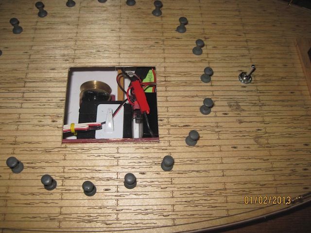

The other photograph shows the means for raising and lowering the balloon - I initially intended to run a lead from the mother ship (CdLion) to operate the balloon winch, but the wiring became a bit obtrusive so I opted for a separate receiver in the GWP operating on a spare channel. The hatch however was originally designed for access to the servo winch, it now has to accommodate the receiver and the battery for the receiver as well - it's all a bit gynaecological!
