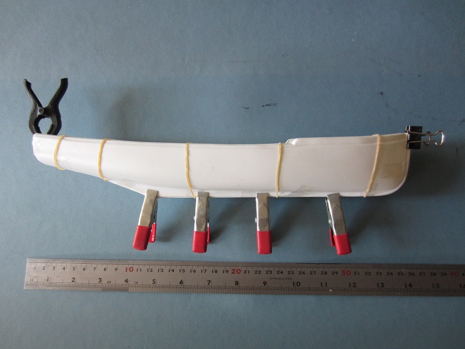

Hi all
I used Revell solvent adhesive to stick the two hull halves together, holding them in place with tape, spring clamps, rubber bands etc. The adhesive should only be applied to the points where plastic touches plastic (not on the wooden keel and bow timbers). Leave this to set overnight before running plenty of medium thickness CA along the wooden keel. Tip the hull forward and backwards so that it runs along and soaks down, bonding it in place. Leave to set over night. You might also need to stand the hull upright so that CA glue can be run along the bow timber bonding it in place too.
File comment: Sticking the two hull halves together.
PICKETBOAT

Hi all
After installing the inner transom re-enforcing piece, I decided to also reinforce the short length of “butt” joint in the hull halves (between the transom and the wooden keel piece). This was easy to achieve with a small strip of 1mm plastic card. The solvent adhesive had stuck the hull halves together really well, but the last thing I wanted was for this joint to crack after the model was finished. As the hull is only nominally 0.75mm thick the “butt” or edge to edge joint is an obvious weak point. Another reason to reinforce this point was that the stern tube will exit here and the hull will need to be drilled to accept this.
The vac formed motor mount was cut out. This already had, more or less, the correct angle designed in. It was stuck down to the hull floor with solvent adhesive. The location point is indicated in the picture.
File comment: Hull seam reinforcing strip.
File comment: Installing the vac formed motor mount on the hull floor.
