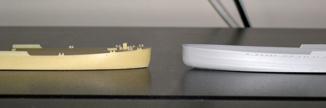

A word about this kit, marketed as eight different sisters. It�s great to have a styrene kit of this class, and most folks will be satisfied by it. That said, it�s about as simplistic, generic and inaccurate a kit as Fujimi has ever released. It certainly does not measure up to the detail and general level of accuracy of Fujimi�s other 1/700 IJN releases of the last few years. The bow and stern are wrong, the hull plating grossly overscale, a generic layout is used for the configuration of piping and hatches on the main deck, the forward and aft bridgeworks are also generic (though some kits contain as many as three different bridge facings; a nice touch to try and differentiate among the sisters but, also oversimplified), and a host of smaller errors.
The H-P kit isn't entirely accurate either, but it certainly captures more of the shapes and details correctly. Here are some comparison views between the Fujimi kit and the H-P kit.

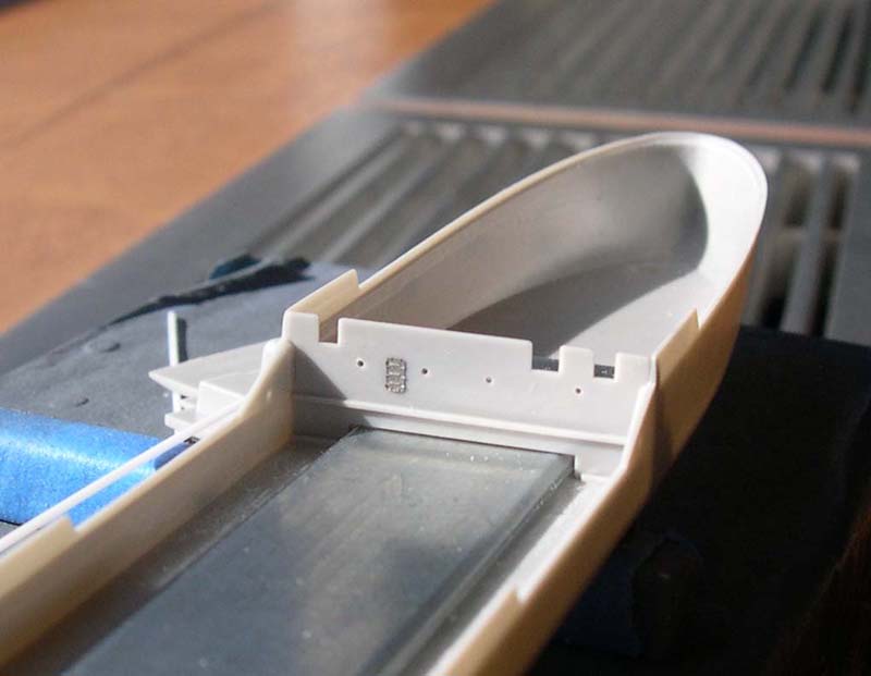

I chose to work on the quarterdeck and aft bridgeworks next, in the mistaken belief that this would be an �easy� step. I scraped off all the molded on fuel lines and winches, and turned my attention to the first level of the aft bridge. To my eye, plans and photos seem to indicate large, open passageways between the outer row of cabins and the internal cabins. So, I opened these passageways. Later, at Motoyuki-san�s insistence, I reviewed again the plans that I had and discovered that these openings were, in fact, large hatches. Oops. So, as photos later on in this build thread will show, I squared off and shrank the openings, leaving off the hatches on those bulkheads to add at a later date, after painting the quarterdeck and mating the boat deck to this structure. I also drilled out portholes according to plans.

At this point , I also provided for a main refueling line and supports on the quarterdeck.

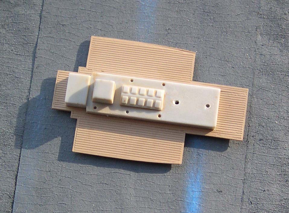

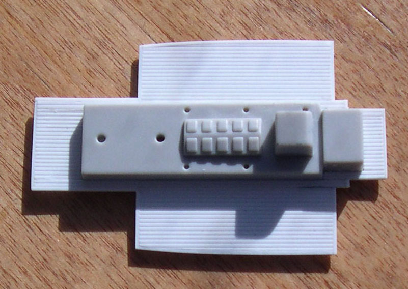

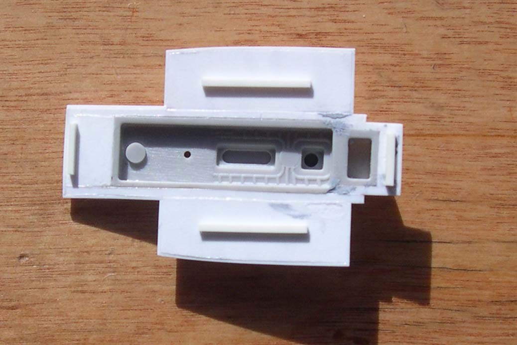

The next step was to re-create the boat deck. The kit deck is closest to that of Nippon Maru, which only had a portion of this deck planked with wood. Most all the other sisters had fully planked decks, though the overall outline changed subtly between groupings. I chose to retain the superstructure portion of the kit and sliced off all the decking, replacing it with .2020 V groove styrene. In retrospect, I think it might have been far easier to not only replicate the deck with V groove but to also scratch built the actual superstructure. Oh, well.
- Posts: 9086
Re: Kawasaki class oil tankers in 1/700�Kenyo & Kyokuto Maru
Once the deck was complete, I sprayed the planking with the new Tamiya deck tan (flat). Then came a coat of Future, and a wash of burnt umber. I thought it turned out well. For comparison�s sake, I included a stir stick covered with just the Tamiya deck tan.

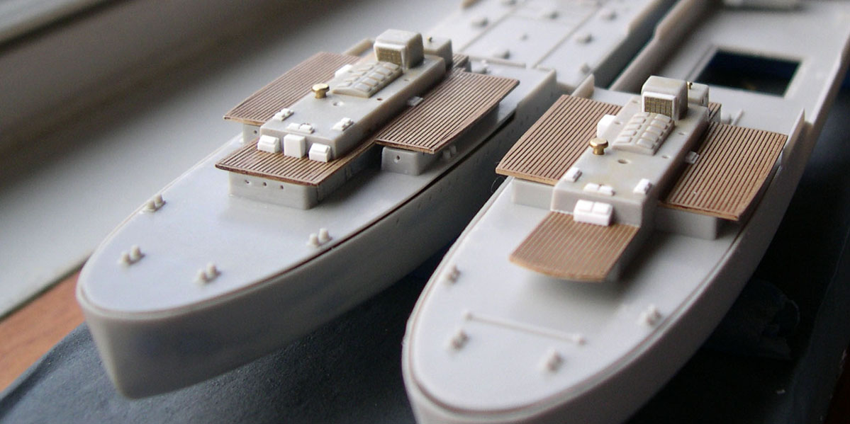

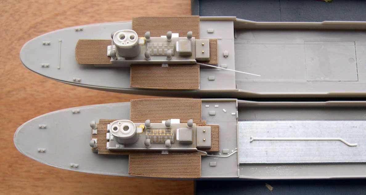

Two thoughts that I neglected to bring up in my last post: 1) The boat deck is bordered with a .015� x .02� strip, which will provide the footing for the railings. The border idea came from Motoyuki-san�s work and I think is an excellent idea. 2) I actually attempted to use the kit supplied boat deck first. Doing so required scraping off the raised planking detail (which is very nice � if only their carriers had it this way, which kind of proves my point about Fujimi�s arbitrary planking choices) and scribe new planking lines. Ultimately, that didn�t work out as I couldn�t space the ruler edge properly. Hence, the move to V-groove Evergreen sheet.
Taking advantage of the initial learning curve, I then replicated the boat deck for Kyokuto Maru (top).

Continuing with the build came the addition of vents, a turbo blower intake, and skylights. Lots of little skylights.

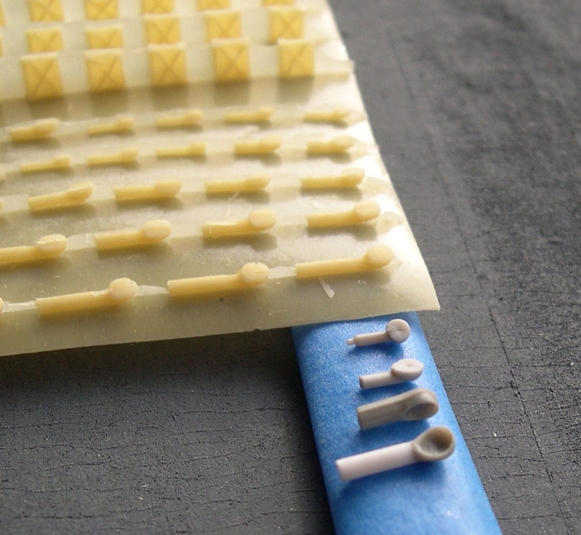

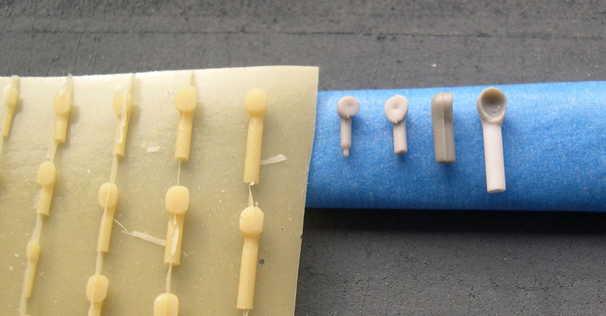

Next, I focused on the distinctive, large gooseneck ventilators on the rear superstructure. Virtually all of the sisters carried seven of them on the rear superstructure, though the positions varied slightly between groups. As the photo of Itsukushima�s aft superstructure shows, the apertures rise substantially above the uppermost housing. Unfortunately, the kit pieces are woefully undersized.
- Posts: 9086
There were a couple of options open to me. Casting was one but, frankly, it�s not an area of expertise for me. There are a number of resin & styrene versions, though I don�t have all of them. Pictured are (l to r) ventilators from the H-P Itsukushima set, those from the Fujimi kit, a version from the PitRoad Kimikawa/Kamikawa Maru kit that�s also sold as part of a sprue for merchant auxiliaries, and one from the old PitRoad E-38/E5 equipment set, which turned out to be the closest match
- Posts: 9086
However, it needed serious reworking as the halves were molded out of alignment. The other drawback is that the final shape is more oval than round. (In truth, this shape is more appropriate for the 1TL tankers.) I spent perhaps 6 hours reworking enough for the two ships. Not so much fun. I probably should have sprayed them with a coat of paint or primer before mounting them, to expose any obvious cracks or imperfections. I guess I was impatient. Now, I will have to wait until I coat the entire structure with paint to check for flaws.
