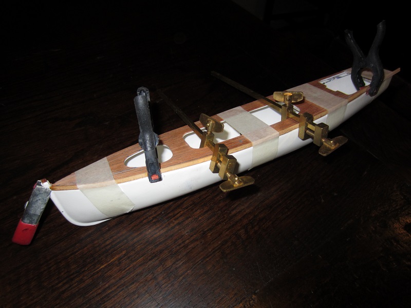

Having secured the deck in place I next ran medium thickness CA along the outside deck edge joint. Capillary action drew this into the joint and bonded the strip wood deck to the top edge of the hull. Inverting the hull when doing this meant that I did not get CA running down the outside of the vac formed hull and make a mess of it.
The deck at this stage was not sealed. I decided the fine grained mahogany planking looked pretty good, colour wise, so I applied a thinned coat of matt polyurethane varnish. The varnish made the black caulking lines show up just enough. When dry the deck was flatted down and the process repeated twice more before being rubbed down with some very fine nylon type abrasive pad. This �cut� the surface enough to enable deck fittings to be safely glued to the deck with CA glue.
I left this over night to dry and then used a sharp craft knife and sand paper to trim back the overhanging wooden deck, so that it was flush with the hull. By this stage the hull/deck unit had become very strong and rigid but was still very light weight.
I had moulded the vac formed hull with a small groove along its top edge. This was designed to accept the strip of timber which made up the deck edge.
The deck edge timber was only 1.5mm by 3mm. This had its top edge rounded off with fine sand paper. It was then seated in the groove along the top edge of the hull moulding and secured with CA. It was positioned so that its top (rounded edge) stood 1mm above the deck, therefore reproducing the deck edge of the prototype boat. This strip was held in place with clamps tape and rubber bands till the glue set.
The deck edge timber was glued in place along the groove in the top of the hull moulding.

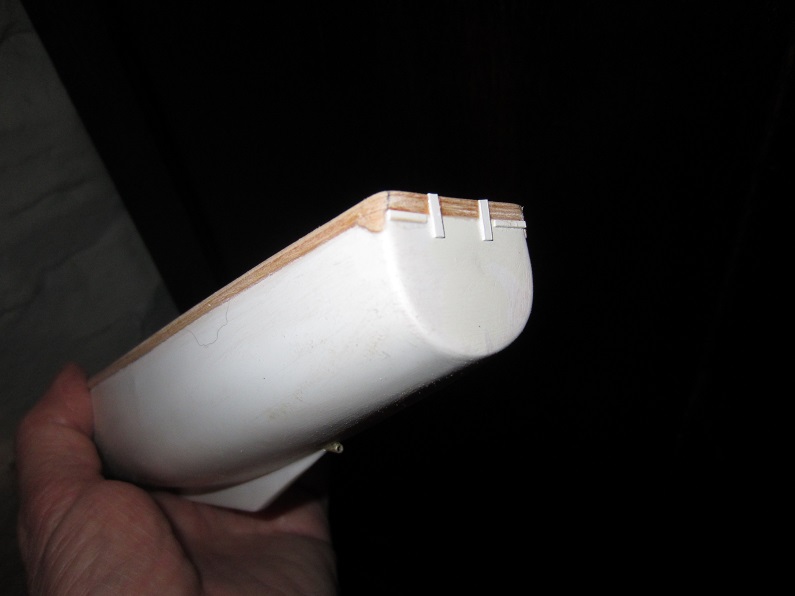

After fitting the deck edge timbers, I started to install the thin rubbing strake along the edge of the hull. This thin timber strip was carefully glued in place with CA and held with clamps/tape till the glue set. It was then carefully sanded to give it a rounded cross section.
The stern was also given an edging timber. Photos and plans also show a rounded timber extending partly down the aft corners of the hull. This appears to be protection for the hull on these vulnerable corners which must have been constantly knocked against ships and jetties. Again this was trimmed to shape glued in place then sanded to the correct rounded shape.
When I was happy with all these little bits of wood along the deck edge, they were given three coats of thinned matt polyurethane varnish the same as the deck.
Installing the rubbing strake along the deck edge.
The thin rubbing strake was held in place till the glue had set then sanded to the correct shape.
The stern edge and aft corners of the hull were also fitted with protective timbers. These were varnished the same as the deck.

Thanks. Re wooden planked decking. In this model the sub deck is plastic card so I used CA glue to secure the planks. On some of my other models the sub deck is thin ply. I experimented for a long time to find a suitable glue to secure the planks.
Some of the modellers out there might find this interesting. I was looking for a glue that had:-
A good quick "grab"
Was quick drying
Did not bleed through the timber planks
Was easy (and not messy)to apply
Had a low moisture content (water makes the planks curl up) so PVA was ruled out.
Reasonably water proof (for working models)
And was sandable (should any little bits squeeze through).
The one glue that "ticked all these boxes" was good old fashioned BALSA CEMENT!
Its just so easy. Apply a thin bead to the reverse of the plank and press it into place. Hold it down for about 60 secs and repeat with the next plank, working out from the king plank. I inserted little tabs of 0.25mm plastic card at the "end of plank" joints. which were removed when the glue had set. These gaps and any other small gaps were filled with black acrylic deck caulking before the deck was finally sanded smooth and varnished.
It might not work on very small scales but was easy and very effective at 1/48th scale.

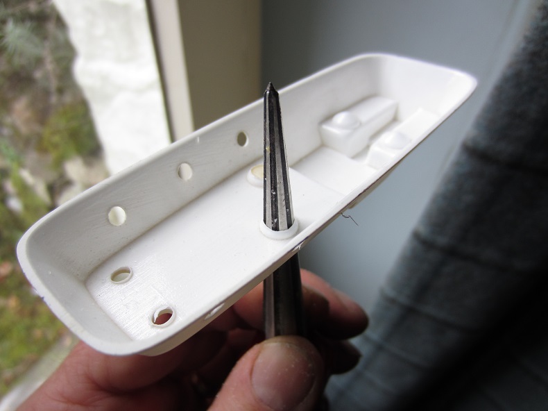

The port holes were carefully opened out using a tapered hand ream, a really useful tool particularly when dealing with thin plastic sheet.
I'm sure most model makers will have already discovered these tools. I small pilot hole was drilled first; the ream was then used to remove a small amount of material at a time, until the holes were the correct size. The shank of a twist drill bit can be used to check the size. Using a large drill to create the holes would risks tearing and damaging the thin plastic.
The cabin roof was cut away as this was to be a removable item giving access to the power on/off switch mounted in the deck.
The cabin roof will be a removable item to give access to the power on/off switch.
The port holes were carefully opened up.

Yes, reaming-out holes to the correct size is a good practice. In the watchmaking trade they have tapered five-sided cutting broaches that go down to almost microscopic dimensions.

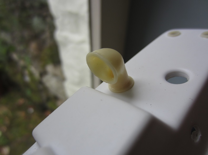

The tapered ream was also used to open up the two holes which accept the two boiler room ventilators. These fittings were removed from the casting base again using a fret saw. I ensured they are a neat fit and are well secured with CA glue. This is important as the securing mechanism for the removable boiler room roof will be fastened into the bottom of these casings. More of this later.
The ventilators are now installed.

I cant remember where I got it from. I first saw one being used for plastic/styrene work in a Dave Wooley article and straight away thought "I want one of those". Since then I have thought "how did I ever manage without this tool."
Probably a good UK source would be Squires.
Wefalk is right, clock makers broaches work on the same principal and are MUCH smaller, so would be great for small scale work.
These tools do create a hole which does not have parallel sides. Not an issue on thin sheet material (they do work on non ferrous too), but could be a problem if you are working in thicker material. This idiosyncrasy can also be turned into an advantage. When installing the ventilators I as able to get a nice interference fit as the casting locating boss only came into contact with the narrowest part of the hole. I was then able to capillary CA glue into the joint (the slightly wider part of the hole) from underneath. A very secure non messy joint can be achieved this way.
These tapered reams do work on wood but struggle with some softwoods and balsa, as they clog easily, and leave the hole "fuzzy" around the edge.

Reamers of all sizes and types are carried by (model) engineering or horology supply houses.
There are straight reamers with either straigth or spiral flutes to create precise diameter holes with smooth walls. They come as 'hand reamers' with a square at the end for a handle bar, or as 'machine reamers' with a round shaft smaller than the diameter of the reamer to be chucked up into machine tools.
Tapered reamers for pins (usually 1:50 taper) for chucking in machine tools.
Tapered reamers for thin (metal) sheets with a cross bar:
Small 'cutting broaches', which are tapered and five-sided, used in horology to ream to size holes in hands etc.:
Small 'smoothing broaches', which are tapered hardened pieces of metal to burnish the holes in hands etc.:
And speciality reamers to ream to size and shape e.g. the Morse tapers in machine tools.
One has to be cautious when using metal reamers on wood, they dull quite quickly, because of the too big cutting angle.
