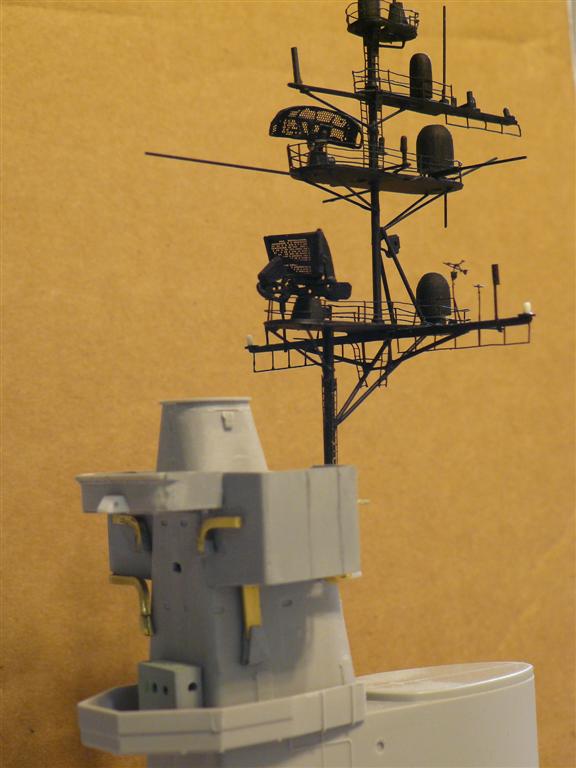

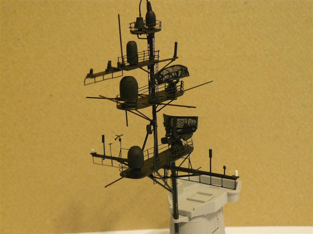

Well, as of last night I finally have the Foremast/Radars complete. I have the wave guides fashioned but are at this point, not included since they will be installed once the mast is in place. Paint touch up and "fine tuning" the handrails will come later.
Foremast looking from port aft
Foremast looking from stbd aft
This entire unit was created from styrene sheet, brass rods, PE from both the kit and Pontos, and 3 weeks worth of tedious work! Additional supports and possibly elec. cabling will be added upon installation. I've begun to work on the modifications to the conning tower (seen below the mast) that will alter the upper part for inclusion of the ECM antennas, etc. and equipment houses on either side of the conning tower.

Well Hank, can see what has been keeping you off the streets at night! Off to some great scratch building. When painting the radar screens the small paint globs that can clog the mesh can be eliminated by blowing air through them before the paint dries. The whole effect has come out very nicely.

Tom - thanks for the comments and advice - should have thought of that last night!!! Oh well, a pin point will do the trick.
