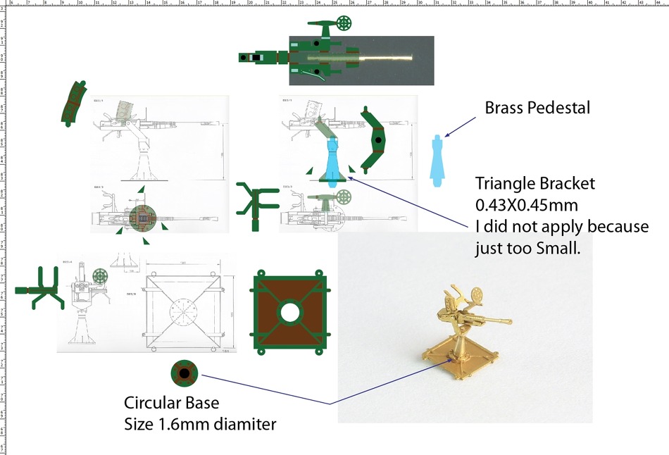

Dan K wrote:
Good pic! The problem is that the documentation for Yamato at the end is thin on the bases for these mounts. I do agree that round bases need to be included.
Thank you for your reply.
Here is my design source of IJN type 96 25mm single MG.
Reference drawing : Anatomy of the ship "Battleship Yamato" & "Battleship Fuso"
I designed circular base and appllied already. just triangle bracket is too small.
So I did not apply the smaple.
I must consider what is most appropriate. because Here consumar is not idiot.
Thank you
Sang Hyun Park
Pontos Model

AllianceModelWorks wrote:
This is the round base, larger than footprint of the pedestal.
So if we count the square thing as a base, there were probably 3 different ones, all larger than bottom of the pedestal.
AllianceModelWorks,
Thank you for your advice.
But this thick line means Deck itself, not circular base plate referring from Skulski’s other diagrams.
Generally this thick line(base line) was drawn for showing the height from baseline.
(For Example, seeing from E14/1, the height of muzzle center shows 1180mm)
Also this E14/1 diagram also shows 8bolts were fastened without extra circular base.
Of course I don’t think All Skulski’s diagrams or drawnigs are right.
But there is no photo showing extra circular base plate, so at this time we would not draw any extra circular base.
Thank you.
SH Park
Pontos Model
PS. I assembled again my 1/350 Type96 25mm singleMG today
it's very diffcult to be assembled because triangle bracket is too small as to pick it up.
I should make more larger to easy assembling.
Understood, and practical. Your 25mm looks great!.
