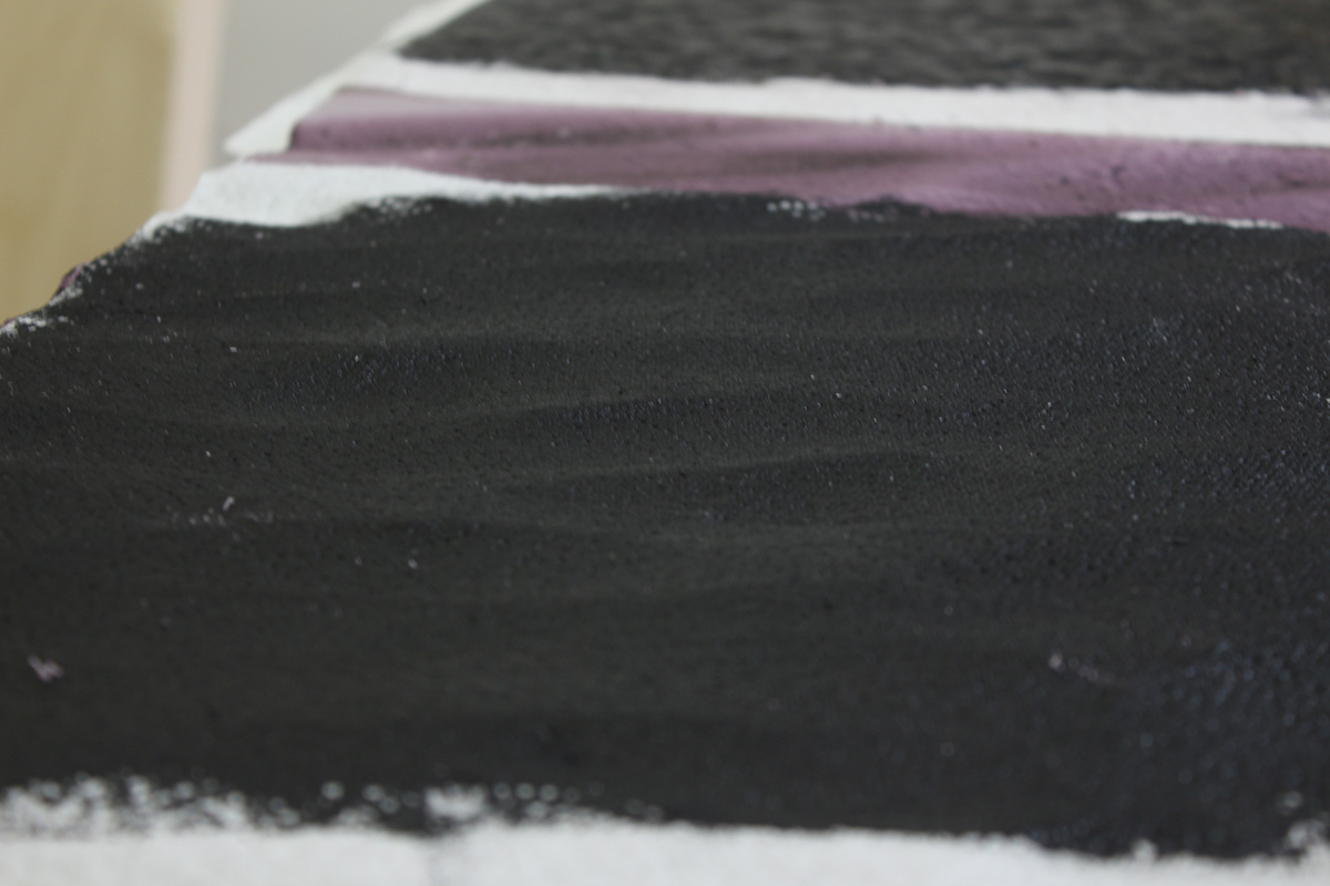

SURFACE TREATMENT
I've come to believe that smoother is better for a sea surface. Everything has to be smooth, undulating and free of un-wavelike lumps, grits, cracks, inconsistent 'waves' , pin holes, brushy daubs, and other such tells. I've had a great deal of success using small pieces of regular paper or paper towel that are glued down with either acrylic clear medium or aerosol spray adhesive over the sculpt, be it foam, oats, or whatever. I outline this process here viewtopic.php?f=4&t=157503&p=637868#p637868 Sanded smooth, the overall effect is quite naturalistic.
I've experimented with attempting to fill a lumpy surface with some kind of filler, but nothing works quite so well as collaging paper and acrylic clear medium over a rougher surface to create that smooth undulating effect. I do lots of sanding and nit-picking these days to get it perfect. Coarsely carved styrofoam that is sanded, then covered with paper is probably my most favorite and more successful efforts at making a sea. Many different effects can be produced by applying paper or paper towel to a coarse surface. My HMS Howe and Zerstorer are good examples of this. It's really become my go-to process.
For thousands of wavelets, it is possible to lay down a rough surface of oat bran onto a glue layer, let it dry, then glue paper towel on top of it regardless of how your initial sculpt was made. Here is a link to that specific idea: viewtopic.php?f=4&t=156536 . Coarsely carved styrofoam that is then covered with paper or paper towel produces the same sort of effects and is more elegant in concept. For a very calm, breezy wavelet look, you could simply use some kind of small tool to make thousands of little dents in styrofoam and finish it with a single sheet of paper towel applied with spray adhesive. After many coats of paint, the look will be very convincing.
For a very calm sea, I've used plaster that I blow with a straw. My Graf Spee was done this way. http://www.modelshipgallery.com/gallery ... /index.htm To be honest, making a sea with a wet material like plaster is messy, risky, and too wild to produce perfect results. The concept of blowing plaster is kind of cool and might work for certain people though.
While plaster can work well for a very calm sea, I again have to say that styrofoam that has been carefully cut and shaped and sanded to perfect smoothness is still the better way to go, followed by a texture treatment. I've been experimenting with a perfectly smooth surface that is first textured with acrylic clear medium then painted. This can work very well for calm water and is outlined in full here: viewtopic.php?f=4&t=158909&p=651903#p651903

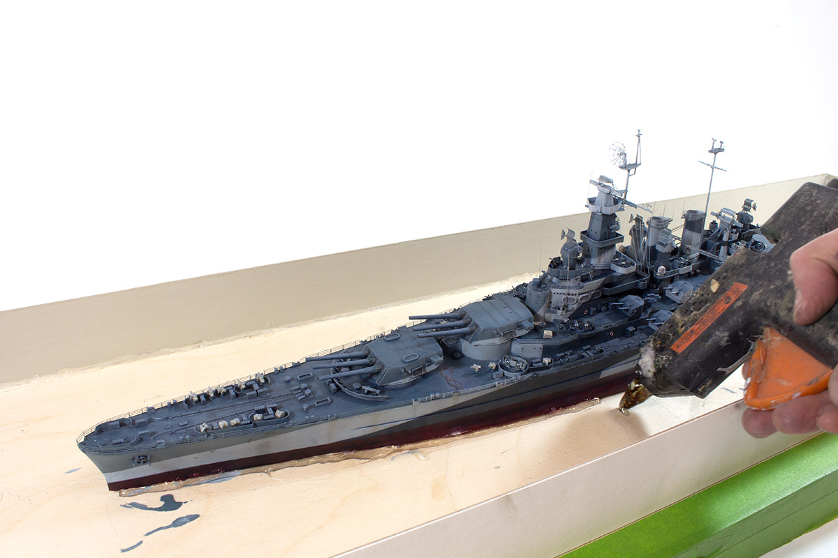

Using the hot glue gun, I attach my water-lined or un-water-lined hull to the wooden base. At 1/350, I water-line larger ships, but would keep smaller ships like a destroyer full-hull.

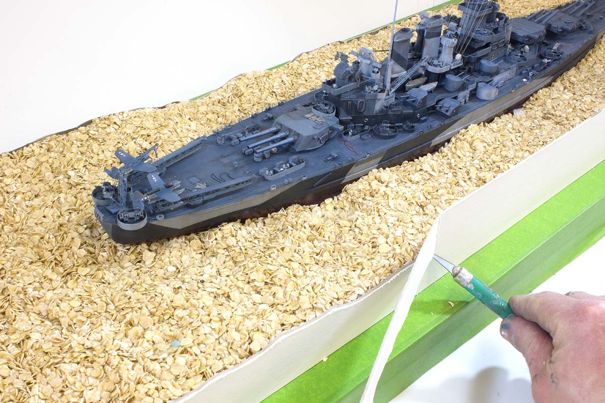

I dump bulk-purchased dry OAT BRAN, (not  regular oats) into the walled off area. NOTE:  THESE PICTURES SHOW ME USING REGULAR OATS, BUT I'M FINDING THEM TO BE A LITTLE TOO COARSE SO I NOW ONLY USE OAT BRAN.  Using my hands and a flat brush as a tool, I manipulate the oats until I like the look. I love that I can do this indefinitely until I am fully satisfied.

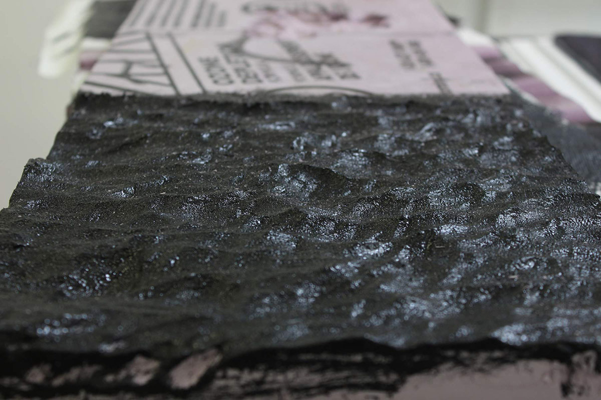

As I mentioned above, foam is my go-to process these days. For every type of sea condition where waves are present, it is possible to carve foam in such a way so that when it is covered with either paper or paper towel, the result will look convincing. Below are test examples of different foam carvings that have been covered with paper towel.
I have recently discovered that it is very easy to simply glue down one long piece of paper towel by first spraying aerosol contact cement to both surfaces, waiting for it to get tacky, then pressing the paper down. After thoroughly buffing the paper towel with your hand and fingers, it will take subsequent paint layers without wrinkling. Wrinkling should always be avoided as it a dead giveaway that can ruin the overall effect.
Here I have used a dremel tool with wire brush attachment to create coarse wavelets.  Covered in paper towel and many layers of paint, the final effect can be quite convincing.  I used spray contact aerosol to do this.   One long sheet of paper towel.
A slightly different dremel texture that has been covered with paper towel and many layers of paint.  I would do many more layers if this were for an actual diorama to hide the towel texture.  The more coats the better when doing seas.

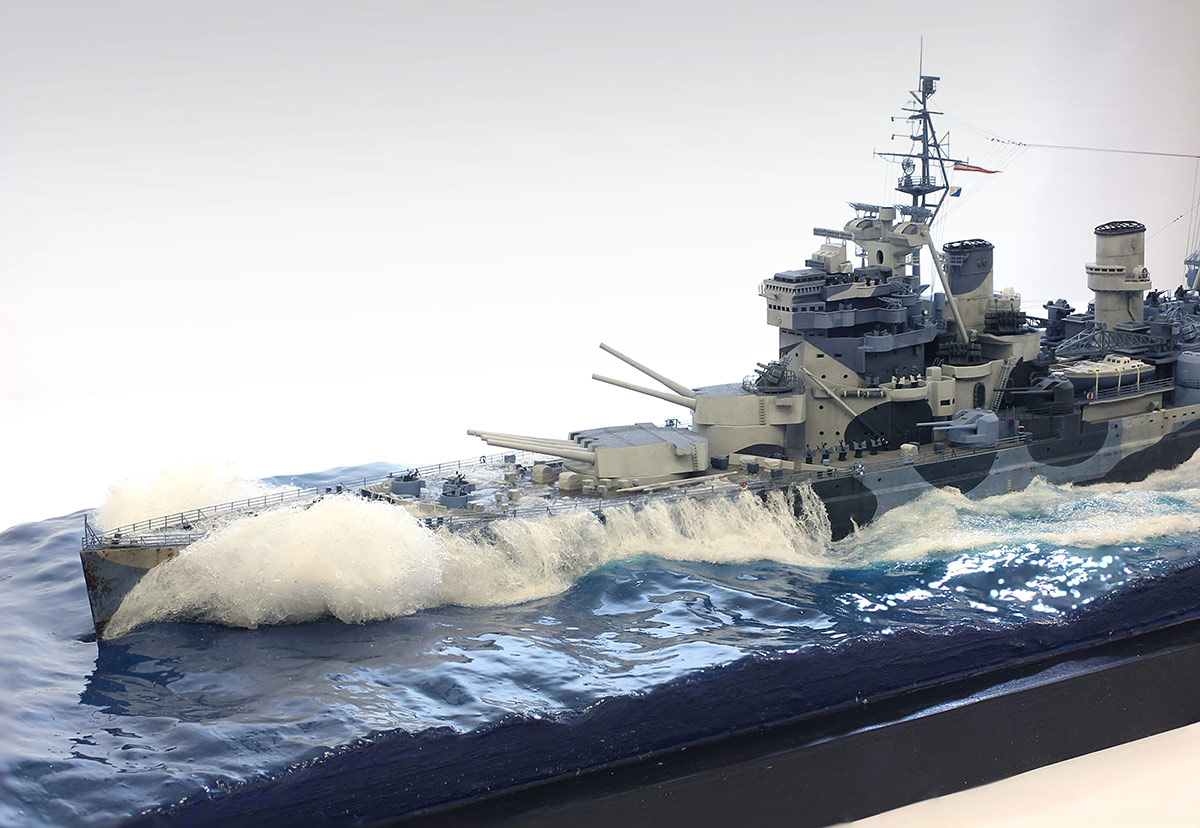

BOW CRASH
I'm certainly not the first person to use cotton for a bow crash. Here's a link that demonstrates my current thinking on the matter: viewtopic.php?f=4&t=157503&p=637868#p637868

RE: WATER31.jpg � You indicate that �I'm applying some white-water to the forecastle area� � I was wondering if this was a mix of white acrylic paint with some gloss medium? You really did not say fully, just that it�s �white-water�.
RE: WATER42.jpg � �I will let it dry thoroughly and will top-coat everything in Liquitex HIGH gloss acrylic varnish.� � Does this mean that after using Krylon Crystal Clear spray that you go over the ship, cotton and the black base? Or is it applied to just the water base and then cotton? As you say �top coat everything�, so do I take that as literally?
I hope that these points are good feedback so that others also have a clearer understanding as to your process.
Feel free to also e-mail me at: johnsullivan@sullivanvideo.com
Thanks & Cheers!
John
Hi John,
I"m glad you liked the article. I answer your questions point by point:
-I use gloss, extra heavy acrylic gel medium to coat the oat surface. i sand the surface first, then lay it on very thick, being careful to make it water like. Once it's dry, I'll add more to make sure the oats are very well buried.
-Yes, i use crazy glue . THIN viscosity that I buy bulk from Mercury adhesives
-Oat bran is basically just the husk of a wheat grain or something to that effect. I'm assuming you are from the US? I find that Americans don't know what oat bran is�it must have a different name down there. It looks like you took quaker quick oats and but them in a blender. It's a finer texture
-I work wet into wet as much as possible. While my sea colour is still wet, I brush in my froth colour. Should my sea colour start to dry, I brush more down and keep going.
-Whitewater on the forecast is simply more cotton and clear medium like I did in the water. I NEVER EVER use white paint as it simply runs any attempt at water IMHO
-I use Kyrlon crystal clear to affect glossy areas on the ship. I hose it on liberally around the forecastle, hull and any lower decks that might be wet. Though there is overspray onto the sea, I don't coat my sea surface with Krylon krystal clear. I use the Acrylic Liquitex brand High gloss varnish to give my ocean its shine. I don't brush it onto any cotton puffs such as bow spray..but yes, all ocean elements get covered with the liquitex
Hope that helps!
