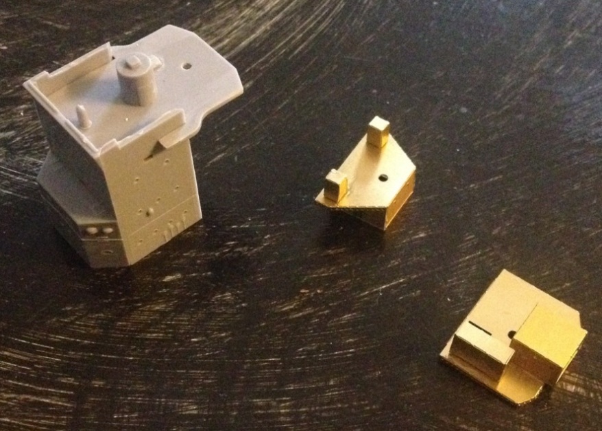

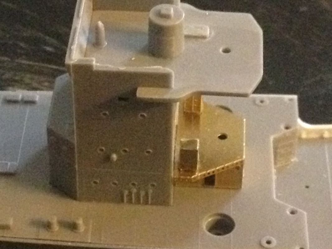

Build time: 20 hours
I have started some of the other sub assemblies. This is all bridge work.
