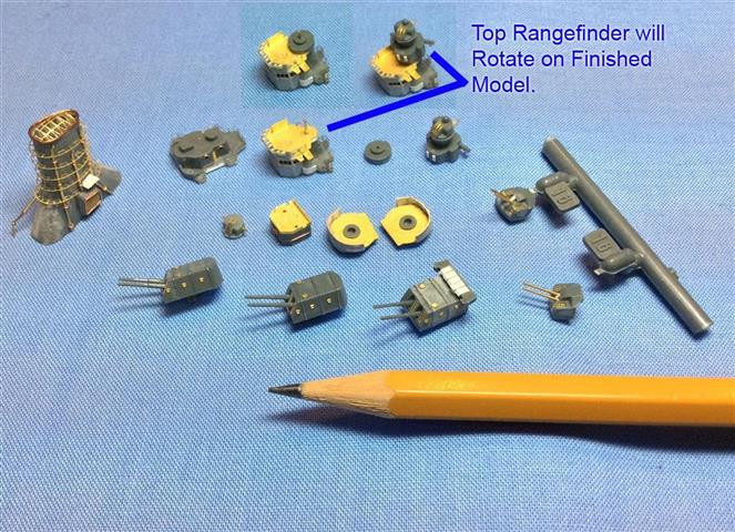

Some progress. #4 shows how I had to create all the detail on the superstructure base. Nothing came on the kit. #5 show scratched mushroom vent, slightly overscale but they turned out pretty good.

Some photos of the superstructure and smaller details just before painting.
