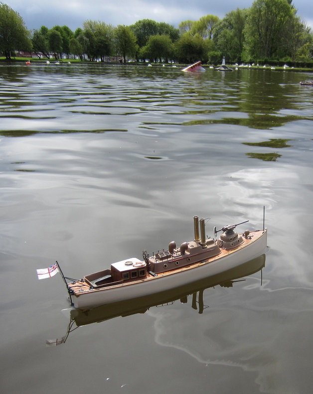

PostPosted: Sun May 11, 2014 4:20 pm
Joined: Wed Jul 21, 2010 2:44 am
Posts: 474
Location: Dumfries, Scotland
Colin
Thanks for "taking the helm" while I scrabbled about on my hands and knees trying to get a few decent photos of the finished model on the water. Many thanks to all at Glasgow Richmond Model Boat Club for their help, enthusiasm, sense of humour and excellent tea. I am looking forward to attending the Model Warship Weekend at GRMBC later in the season. It certainly sounds like this event is getting bigger and better with each year, and I will be in attendance with my models.
The Picket Boat model performed very well on the water, with only slight radio control interference towards the end of the sail which remains a mystery. It is amazingly controllable and turns in about twice it's own length. It rides over waves well and the tiny motor gives a scale speed, with a slight excess of power to get out of trouble if required.
It would look better with a few crew members, so that is the next challenge.
File comment: Picket Boat at Glasgow Richmond Model Boat Club 11/5/14
File comment: The maiden sail went well.
File comment: The model performed very well.
File comment: The next challenge will be to add crew figures.
