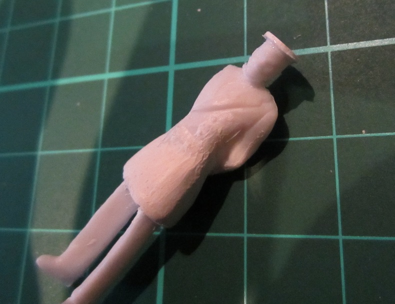

Hi all
Photos of officers of this period show that their jackets were double breasted and long (see picture below). I therefore modified the existing jacket on the figure by lengthening it.
For this I used "Milliput" epoxy putty, fantastic stuff, but I'm not sure if it is readily available outside the UK. I use this in my "day job" restoring antiques and fine art so know how it works. The pictures show the "super fine white" but it is available in other colours. Mixing the two parts produced a sticky malleable clay like medium which can be worked and spread with tools and fingers. Adding a little water to the surface makes it possible to smooth it out. It cures slowly over about 6 hours to a density that can easily be carved with a craft knife. Left another 6 hours and it's rock hard and can be sanded.
I also re positioned the figures head and removed the modern collar and tie which will be replaced with a Victorian stiff collar.
File comment: Note the officers long dress coats and the small hats.
File comment: The long dress coat was going to be reproduced on the figure which started off with a modern suit.
File comment: Milliput epoxy putty is excellent for these fine modelling tasks.
File comment: The initial stage of smoothing out the putty requires a little water.

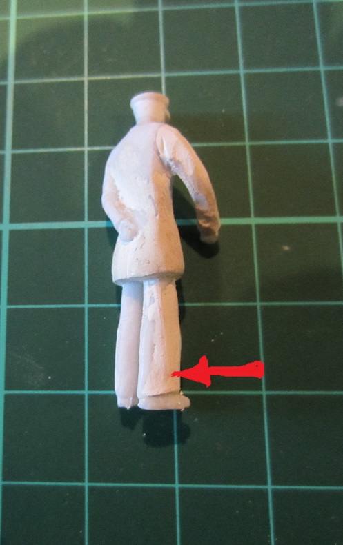

Hi all
Having previously removed the top of the figures head, I now needed to give him an officers hat. Using a hole punch I cut out a small disc of 1mm plastic card, followed by another disc slightly larger but the same thickness. The smaller disc was the same diameter as the figures head. These discs were glued, with solvent weld, to the top of the officers head, small disc first.
Punching out a hole, followed by another, larger but off set created a tiny crescent which was glued in place to create the peak of the hat. When the glue had set this hat was tidied up and gently sanded.
The epoxy putty was used to create the beard and mustache and also to make the trousers slightly more baggy. It's a little difficult to see the detail as everything is white but it will show up much better when the figure is primed.
File comment: Two plastic card discs were used to create the officers hat.
File comment: A hole punch was also used to create the a small crescent used for the peak of the hat.
File comment: When dry the hat was tidied up.
File comment: Epoxy putty was used to add the facial hair.
File comment: Epoxy putty was also used to make the trousers more baggy and to add a Victorian stiff collar.

Well this is the moment of truth. You never really know how well these moulds work until you try them out.
I poured the resin and increased the pressure pot internal pressure to 50 psi.
Not bad results in the end. OK so it's not exactly "Games Workshop" quality but for home produced figures they are not too bad. There was a small amount of very thin, and thus easily removed, flash along the mould seam. The "walking sticks were very easily removed with small side cutters. These served their purpose very well and there was no loss of limbs.
Beards and chins are a slight problem with small air bubbles trapped under the figures chins on some de moulds. A fine incision in the RTV mould,vertically under the chin allowed the bubble out. The resulting "web" under the chin was easily removed on the de moulded figure.
File comment: The first figures out of the mould.
File comment: Some fine flash was left along the mould seam.
File comment: The "walking sticks" served their purpose.
File comment: The "walking sticks" were removed with small side cutter.
