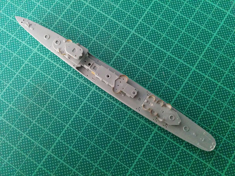

Re: 1/700 USS Monssen DD-436
Thank you for your kind words Gordon! This build will be faster, since it will have less scratchbuilding.
Here are some updates, some more PE added...
This part is primed to check for blemishes, since the deck is mostly scratch. As always, comments, criticisms and/or guidance very welcome!

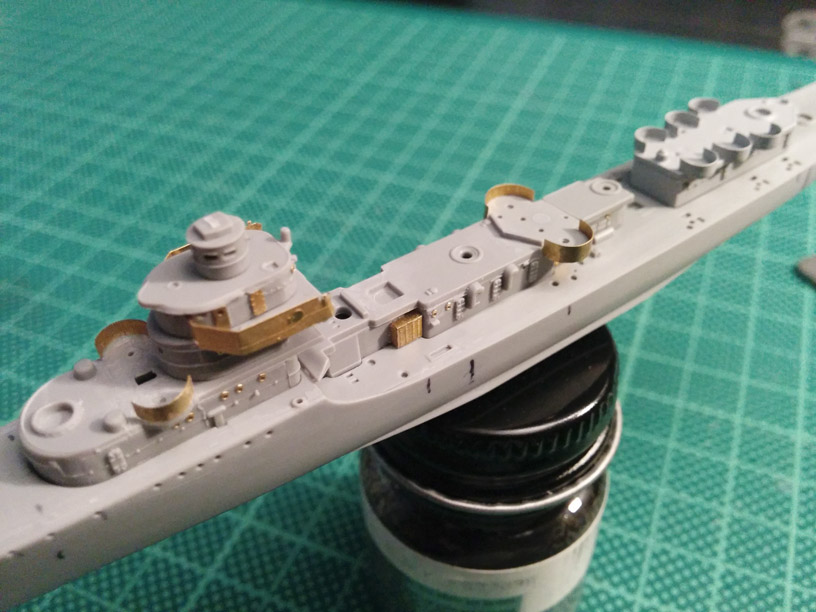

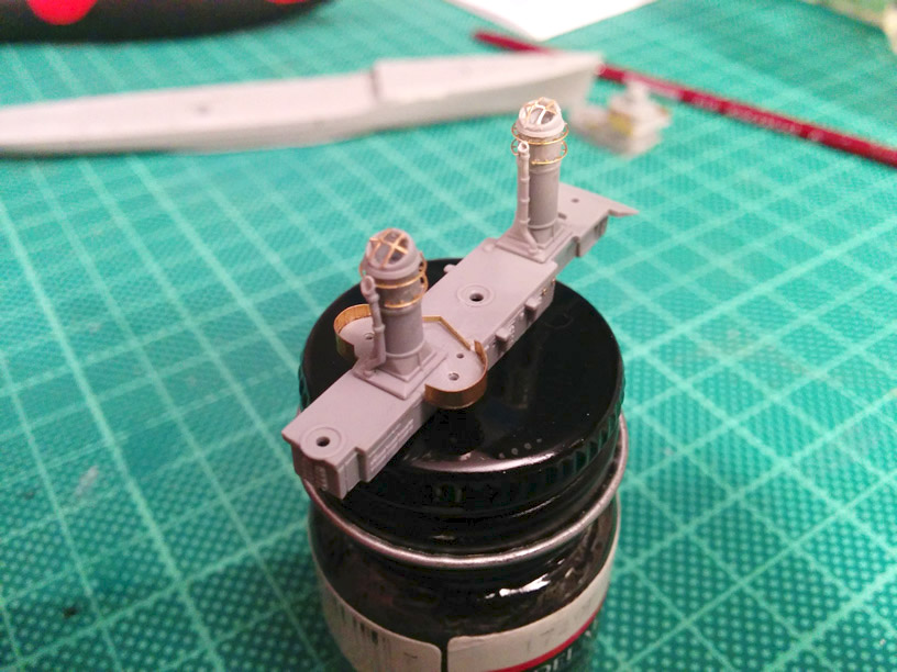

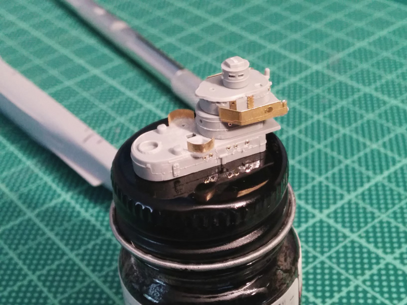

Hi everyone,
Some updates now that I have some more free time.� I have been working more on the superstructure and small details.�
The funnels are not yet ready, other details will be added after painting.� I tried to hollow some of the parts included. Even before starting, I got the feeling that the portholes were too high.� Using pictures and some drawings online as reference,� I moved them lower to match the references. Comments, criticisms and guidance welcome!
Nice work!
hypno7,
This is some really nice work. 1/700 destroyers are my favorite subject and most enjoyable builds. You are doing a terrific job on this one. I never caught the problem with the portholes. Look forward to seeing more.
Thank you all for your kind comments!
- Gabriel:� an optivisor and a good set of tweezers do wonders!
- Mac:� Maybe I am wrong (please correct me as I am new to this), but to me they seem too high,� specially when I wanted to "accentuate" the round edge of the upper forward hull (apologies if the terminology is not correct).� The portholes ended being over the round edge. There are one or two that are not perfectly in line... If the bother me too much, the will be filled with epoxy and redrilled.
In the following picture I made out that they should be around the same height of the hawsepipe
hypno7
No, I don't think you are wrong at all. I'm impressed that you noticed and very cleanly, corrected it. I've built two of these models and certainly didn't catch it (maybe the magnifiers would have helped!). I have two more to build and, thanks to you, I'll at least get the portholes right.
I'd not seen the Flyhawk set until now; it looks to be a good one. I've been using the White Ensign set which is my "go to" set for all my pre-Fletcher class destroyers. Incidentally, Five Star offers a set of reinforced splinter shielding that is very useful for U.S. ships. Guess a call to Free Time is in order.

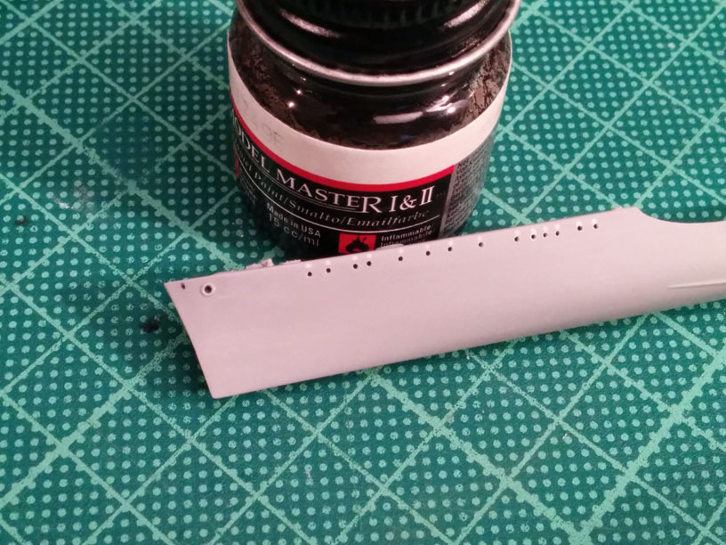

Thank you Nicolas and Dan! It does keep me motivated.
So this weekend I painted the hull with the same process as with the Hornet. The superstructure camouflage will be painted with normal brush, as it is too small and my efforts in masking where not so successful (too many fiddly bits already there).
Nice camo hypno
i like it
Your camouflage pattern is looking very sharp !
This one is coming along very nicely!
Great detail so far (masts and director are really great!), and the camo looks excellent. It is not easy to keep the pattern flowing well without sharp corners when masking and airbrushing camo (one of the reasons I would probably brush-paint a camo like this myself, but I'm lazy!), but you succeeded and the resulting finish looks very smooth.
I'm looking forward to the next steps!
