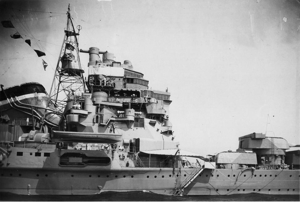

But I understand that the bridge is different between the Takao/Atago and the Chokai/Maya. What is different?
I'm posting several photos below to give you an idea.
Quote:
Also, if I went with the Fujimi kit, what all would I need in the way of PE to get the windows done, railings, degaussing cables, etc. to get the kit as detailed as the Aoshima with the Flyhawk PE?
Again, PE sets are available for the Fujimis.
Takao bridge face prior to 1939 rebuild, side view, flipped.jpg [ 166.9 KiB | Viewed 3393 times ]
