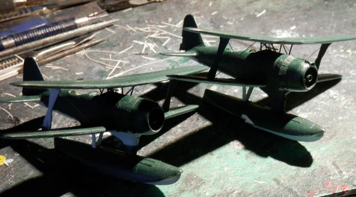

2 x Petes still missing many parts to be added,,
to be carried by Aoba from July,1944
really timetaking when scratchbuilt, but hoping it one day becomes a bit rewarding,,,
Mutsuo S.
Nakajima type 94 model 2 x 1 was also carried by Aoba for a short period in July,1944
zooming as the cause of lack of sharpness of the pic.,,
