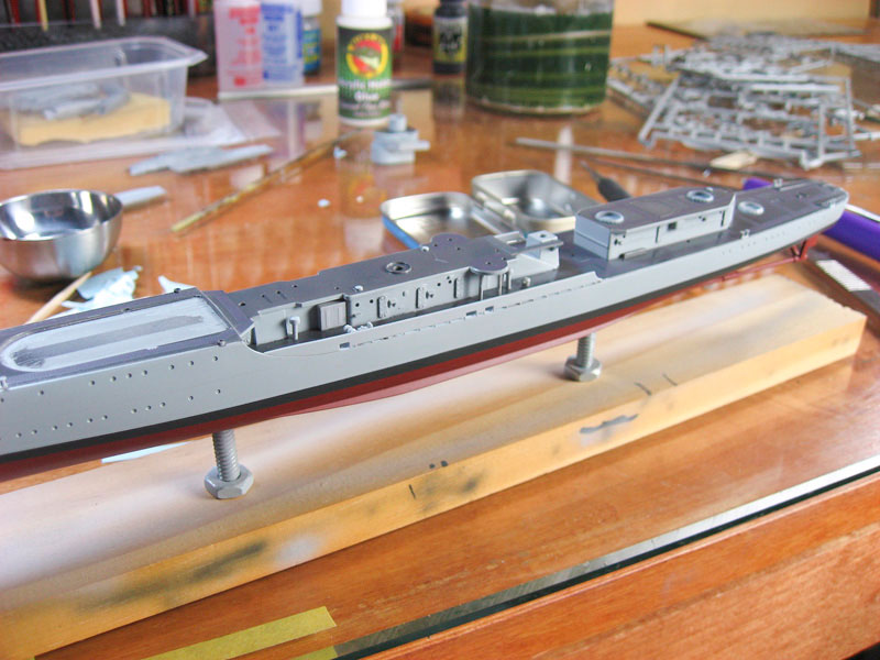

Ten days off for the holidays, so time to get as much done on this as I can. I'm at the point now where things start going together. Big assemblies are good, but the detailing of them takes a bit of time. These Dragon kits have a TON of minute parts, all well done and very nice, but detaching, filing, sanding, priming and painting each of them takes a lot of time. A couple of photos:
The midship's deckhouse is the one major problem spot on these kits. It doesn't fit very well in bare styrene, and when you paint it, the fit is even worse. It's a simple fix, though: sand down the forward bulkhead until you can wedge it into place, then apply ample adhesive, and clamp it down like it's a fugitive flight risk.

Yesterday morning I was perusing the directions and realized that it was an opportune time to add the walkway decals. Two days later, I've finally finished them and am now able to start actual building again. This is the earliest I've ever applied glosscoat during a build, but I'm glad I realized to do them now rather than later when the superstructure and fine detail parts are in the way. As always with long decal runs, it helped a lot to cut the 3" and longer runs into smaller sections. The decals did behave well with setting solution. The only issue is that they're so close in shade to the deck gray that I don't know how visible they'll be after final finishing. Oh well, I tried.
Mushroom ventilator and auxiliary generator (?) added. There's a little bubbling at the joint of the superstructure and the deck here needing attention, and the gun platform supports further aft need some touch up paint.

After super structure added. Still some towers and such to add, along with a lot of smaller details.

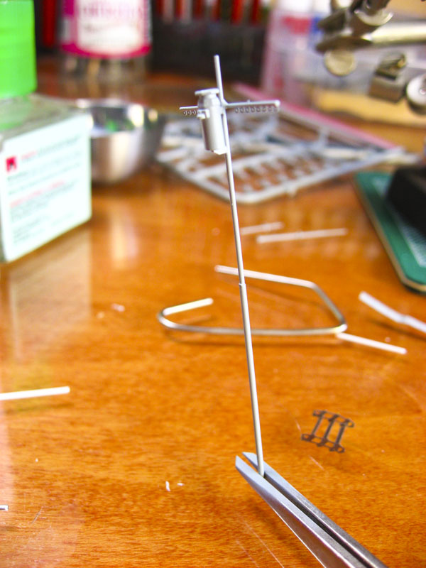

Working on the mast these past couple of evenings. I really wanted to just use the kit parts and be done with it, but I can't talk myself into not rigging this thing, so brass it is. Mast itself is three sections of telescoping micro-tubing, the cross member is brass solid stock. I realize now I should have assembled the cross member to the vertical first, then started adding in the details and crow's nest. Oh well, if the alignment is off, I can just strip it down and start over.

Here it is put together except for the top most part of the vertical. I had that on there as part of the entire assembly, but mis-measured and cut it off by accident. I'll add it once the glue on this has set for a few hours.

Two days later and still working on the mast. When I said I may have to tear it all apart and start over, I was right. Nothing was plumb, parallel, or horizontal. I started over from scratch, building the vertical once again with telescoping tubing. I then put the cross member (yard arms) using a square to make sure it was perfectly 90 degrees, fixed it with super glue, then reinforced the joint with 30 minute, 2 ton epoxy. In the photo you can see the white plastic square fixture I built on the flag bag deck to give it the proper position and support, and a tiny disk of styrene at the base of the mast that I punched and drilled to fill the too-large opening. I still need to add the crow's nest and other little bits. Trying to decide if I should do that now, or wait until the superstructure and mast are fixed permanently, so I can be sure of alignment.
You can also see small sections of railing that I glued to the front of each flag bag to give something to tie off the halyards to. I have the specific Dragon photo etch set for the kit, and there's a section of railing that's supposed to go there, but it's no where near the right size, so I cut out single sections to make these items.

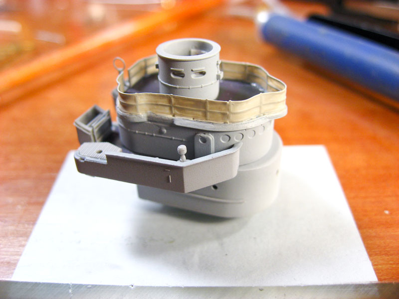

The upper superstructure and railing has to be finished and installed before the mast can go in, but I have to have them both dry fit so I can judge where to drill the holes for the rigging attachment points.
I've built two Benson class DDs in resin before, so I KNOW I've done the railing on top of the deck house, but I don't remember it being so difficult. I started out with the PE bit from the Dragon set, and found it as useless as the railing for the flag bag area. I'm seeing a disturbing trend here. I have a set of Classic Warships generic PE that came with the USS Wichita kit, so I cut some sections from that. Very fine PE, too fine for this instance of multiple curved bends. I'm cutting it down into sections to make it workable. Once it's all in, I'll be coating this upper section with white glue to replicate the canvas dodgers/windscreens.
Lots of work for a single photo. It's taken at least an hour to get this simple bit of railing in place.

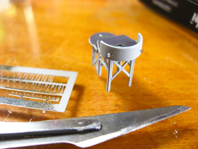

More small details that have to be added before final assembly begins. For the canvas rails on the top of the bridge I'm using something shown elsewhere on this site (maybe Jim Bauman?) that utilizes white glue. The mast is also finished and ready to install, and I've started drilling for the super tiny rigging points.
Here some of the railings have been filled, some have not. Once this dries, it gets a coat of paint only on the outside, so you get the effect of solid canvas outboard, and see the underlying railing on the inboard.

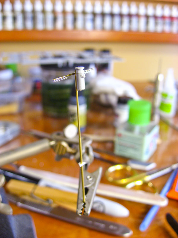

The mast has a coat of paint. There were more details on the kit part, and if I weren't on a deadline I'd have added more for visual interest, but honestly I've spent way too much time on this one assembly as it is.
The rigging anchor points from the L'Arsenal set are so tiny that they make the #80 micro drilled hole (the smallest drill bit I could find) look like craters.

Nice update. I did not even think of cutting the bridge railing in to smaller pieces like you did. I struggled to bend a long single piece that rook a long time and was pain to do. Good tip for next time.

Thanks for the feedback, guys. Gordon, the railing trick was out of necessity, I tried for about an hour to get a single run folded correctly, but it just wasn't working, and I was losing my mind.
