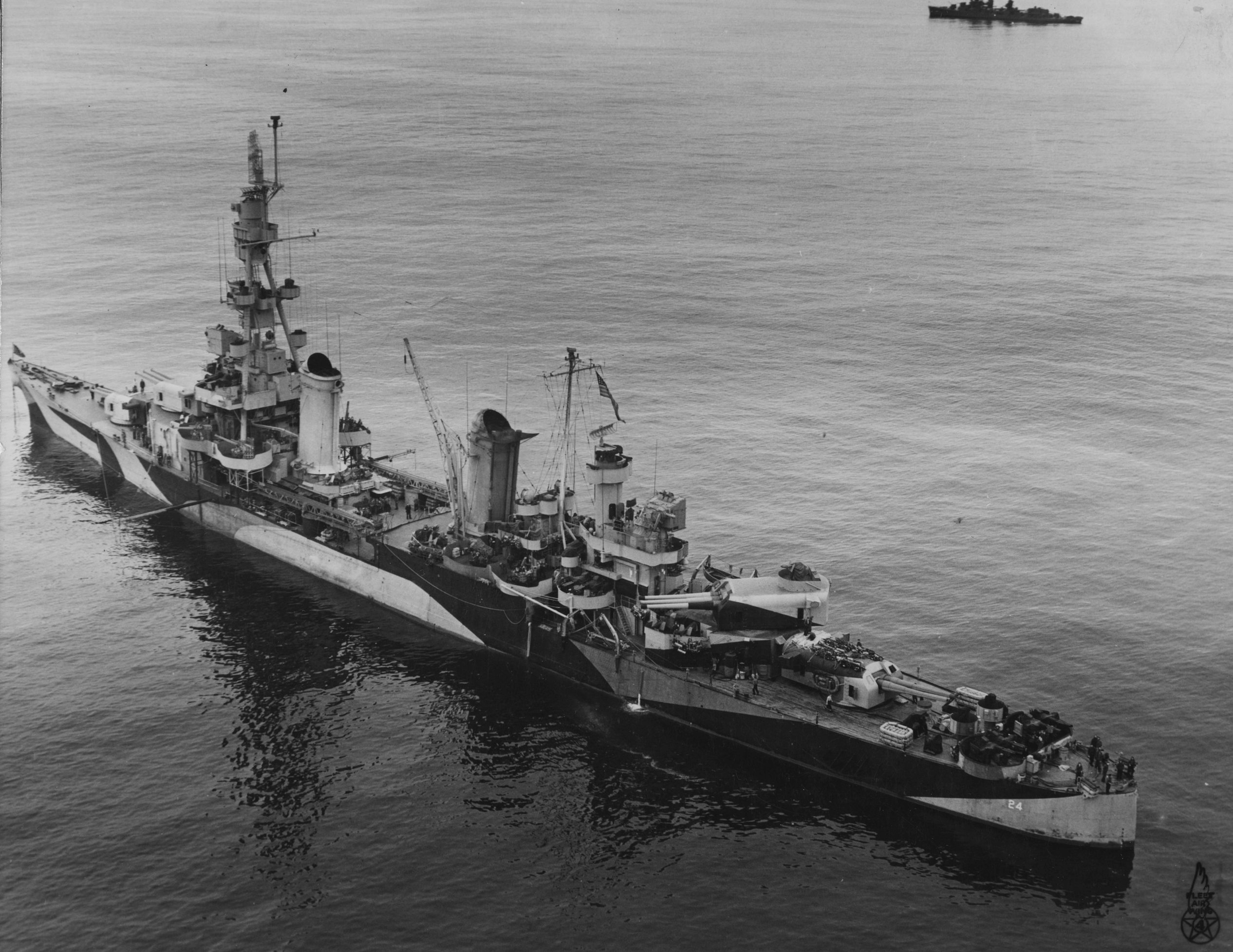

I will be using the 1/350 SLC kit to back date it to Pensacola at Santa Cruz in the near future.
Research has been ongoing for about a year.
By pure luck I found an incredibly clear crop of the ship off Hawaii in the summer of 42 at http://imgur.com/YIlxRwU. Using that photo plus the one Martin posted awhile ago I believe I have located all 20 MM guns. I have photos here on a word document that has arrows pointing to all of the guns.
If anyone needs this info please contact me I will email the photos to you.

I am thinking that the Pensacola did not undergo much change between the Summer of '42 and the Late-Fall '42, when it fought in the Solomons. Would that be correct?

A couple of shots of the Pensacola in Late 42 that I had not seen before.
Coming alongside the Big E just prior or after Santa Cruz
a few days after she took a torpedo
