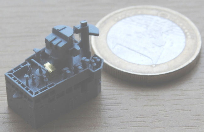

Each deckhouse component is molded as a single piece�there are no multicomponent deckhouse assemblies to be put together. They are packed separately in a clear plastic box, and because they appear to have been created in a slide mold, they do not need to be removed from a sprue tree or cleaned up prior to assembly. This will greatly expedite assembly of the kit. Particularly noteworthy is the bridge, which has nice representations of wind baffles molded in place. All portholes on the hull and deckhouses have fine, in-scale eyebrows. Molding of the deck details and planking is delicate and the overall effect is outstanding.

And here are some links of An Chu's wonderful modifications of the WEM kit of HMS Dido to make some other ships of this class (Naiad, Argonaut, and Sirius). The latter two builds show how you need to modify the bridge to represent the ships of this class without the open port and starboard galleries. You can see some of the mods he made prior to applying paint, in the photos for Argonaut:

Thanks Mike. I've just realized that I should have seen this bridge detail on the IWM site - many pictures of the Dido's are online now. Note that contrary to what's mentioned in Raven & Roberts Cleopatra still had .5in machine guns when she entered service (picture A7062).
