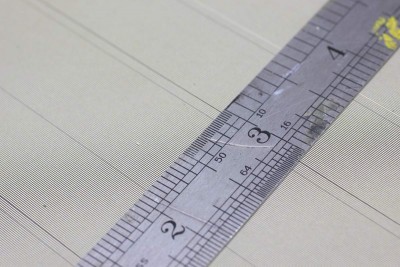

In Photoshop, I made an 8.5"x11" sheet of stripes that correspond to the approximate thickness of 1/350 rope. The image was basically a solid color of dingy rope tone overlaid with black stripes. I won't describe how I did this here. I printed off a stack of these which will easily last me the rest of my life.

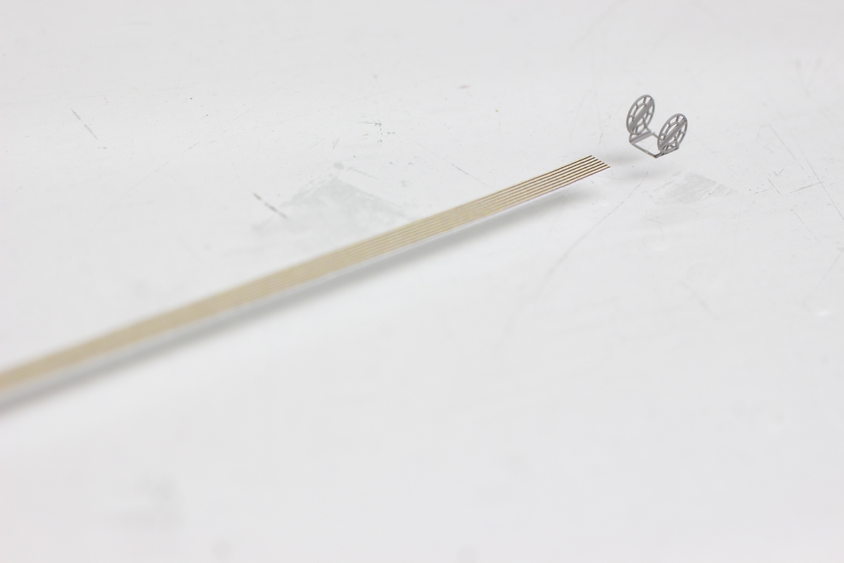

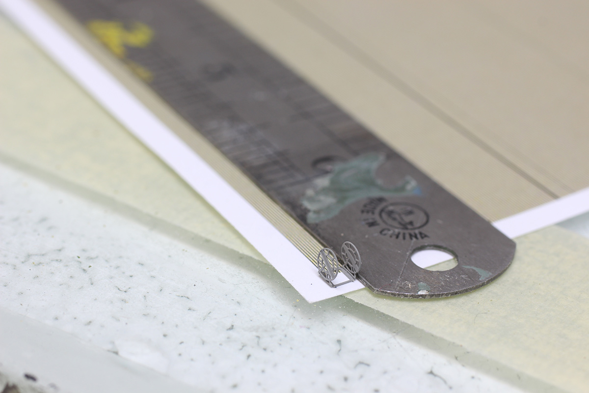

Now I cut a strip that is exactly as wide as the width between the cable reel frame. It is important that this width be perfect. Not too big, not to small.
One strip will yield many reels.

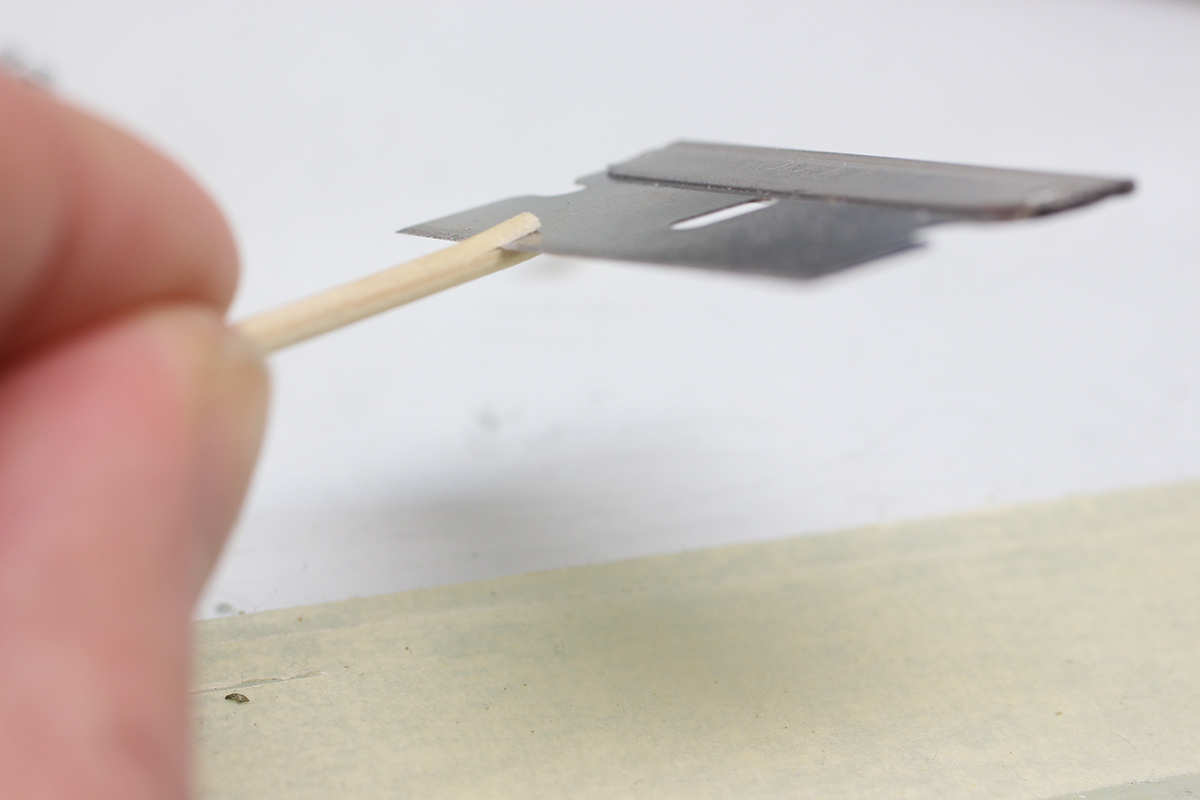

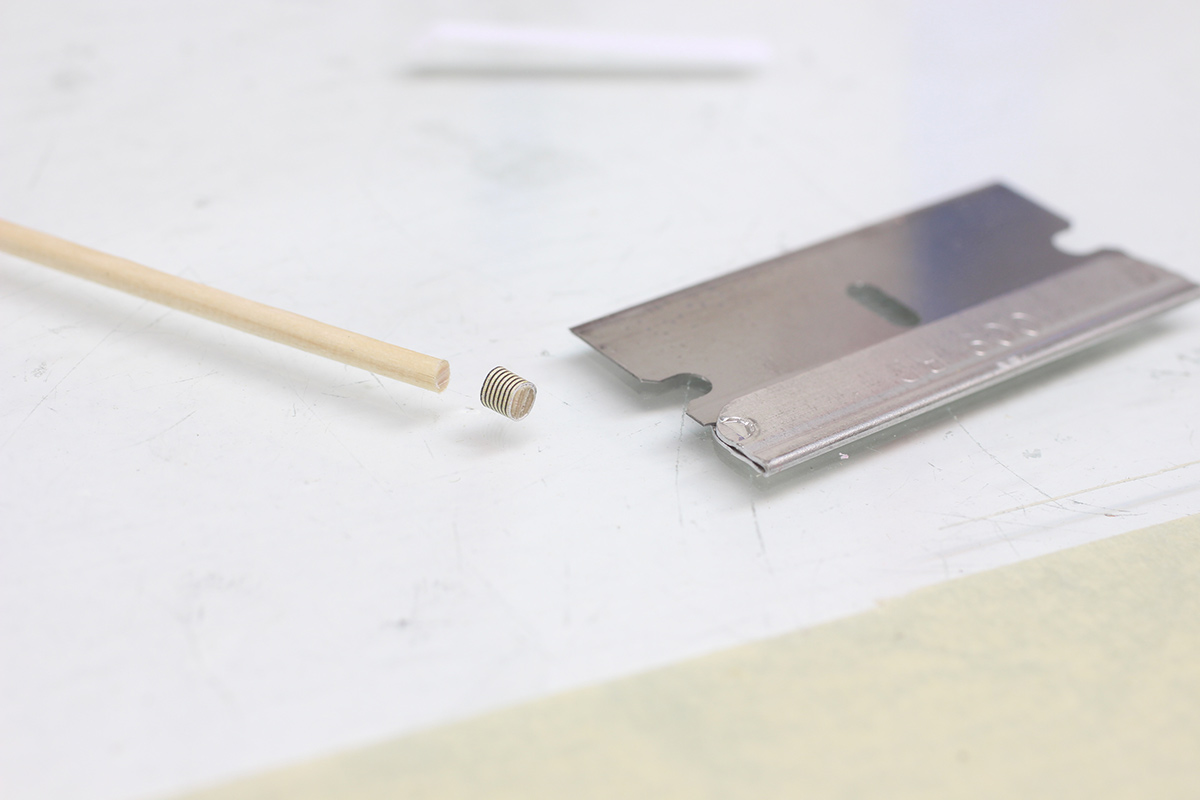

Next I cut off the end of a regular cocktail stick/toothpick and sand the end flat and perpendicular to the length.
Now I take a blade and make a 1/4" slice approximately down the middle.

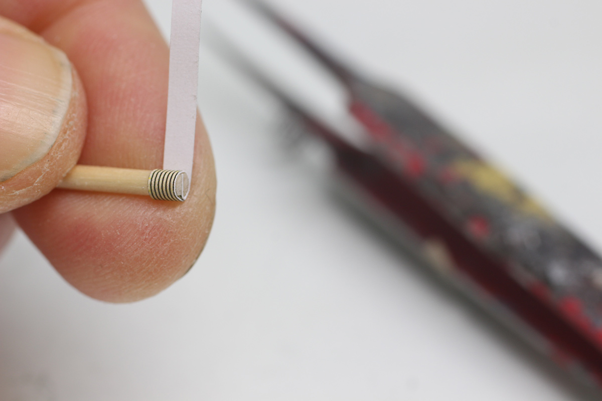

This slice now acts as a holder for the paper strip. It makes it very easy roll the paper around the dowel.

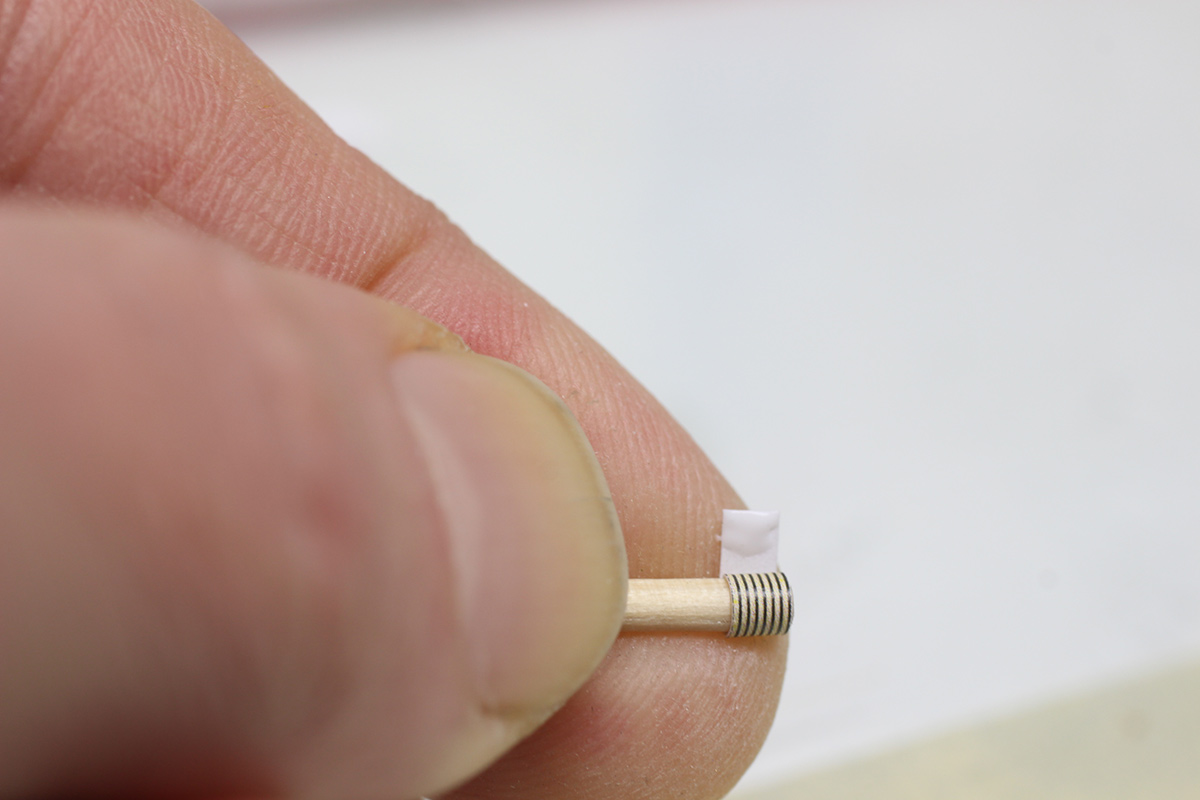

After the paper has made one round turn about the dowel, I trim the end and apply a small touch of white glue.
It glues instantaneously once some pressure is applied.

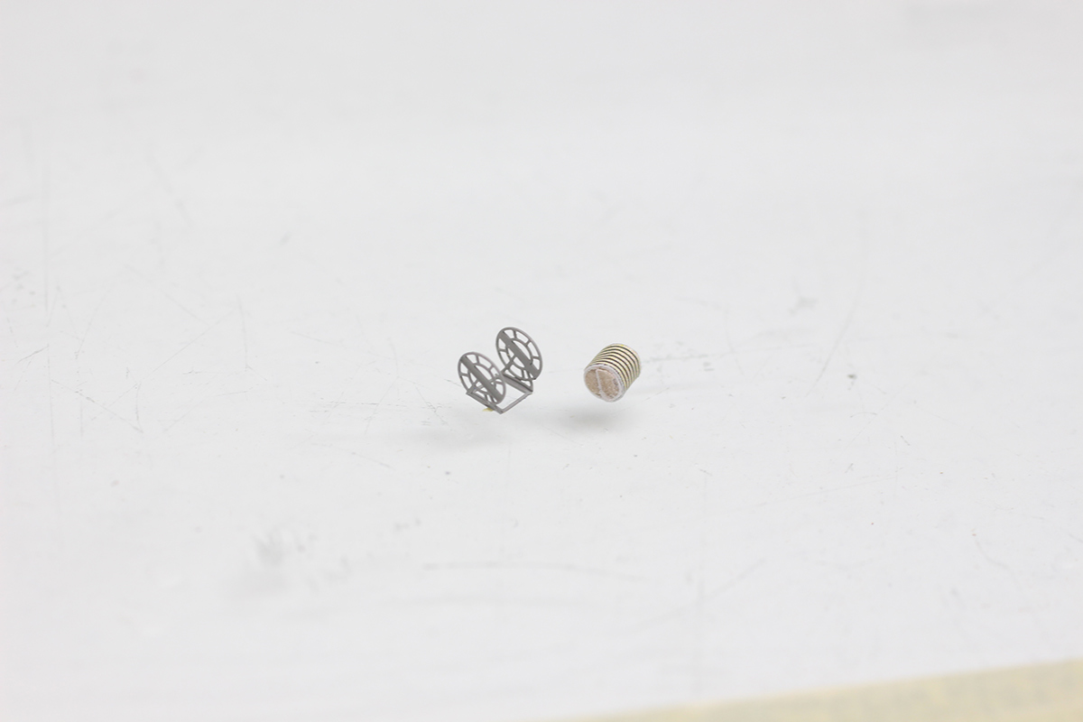

I cut this bit off the dowel.
continued....

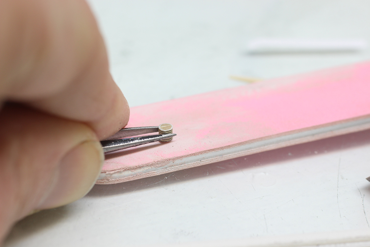

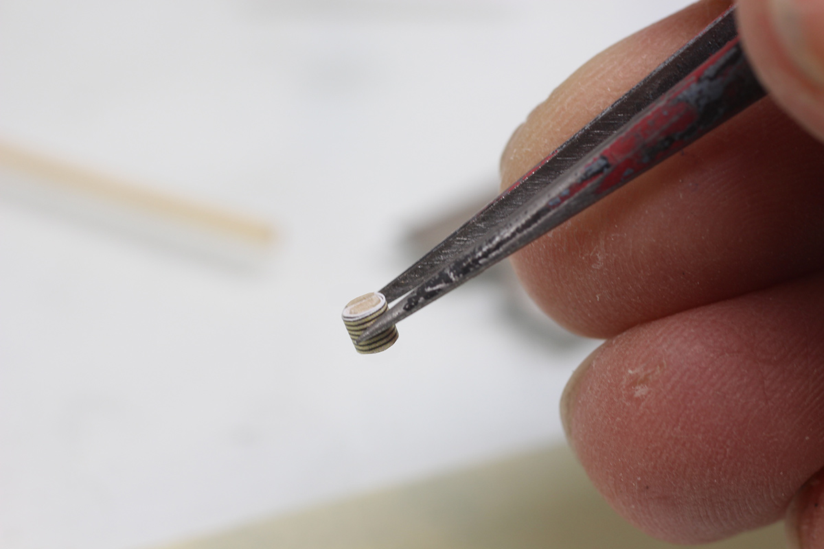

Using tweezers, I flex and shape the dowel to get it round. The cutting process can distort it a bit.
I sand the ends to make things neat and flush.
Next I attach this bit into the frame seam down. Theoretically, you could run a piece of copper wire through the center of the drum where the split in the wood is. Providing the split is dead-center, you'd have yourself a perfect little axle for attaching. The paper seam will never show on the finished model if placed at the bottom of the drum.

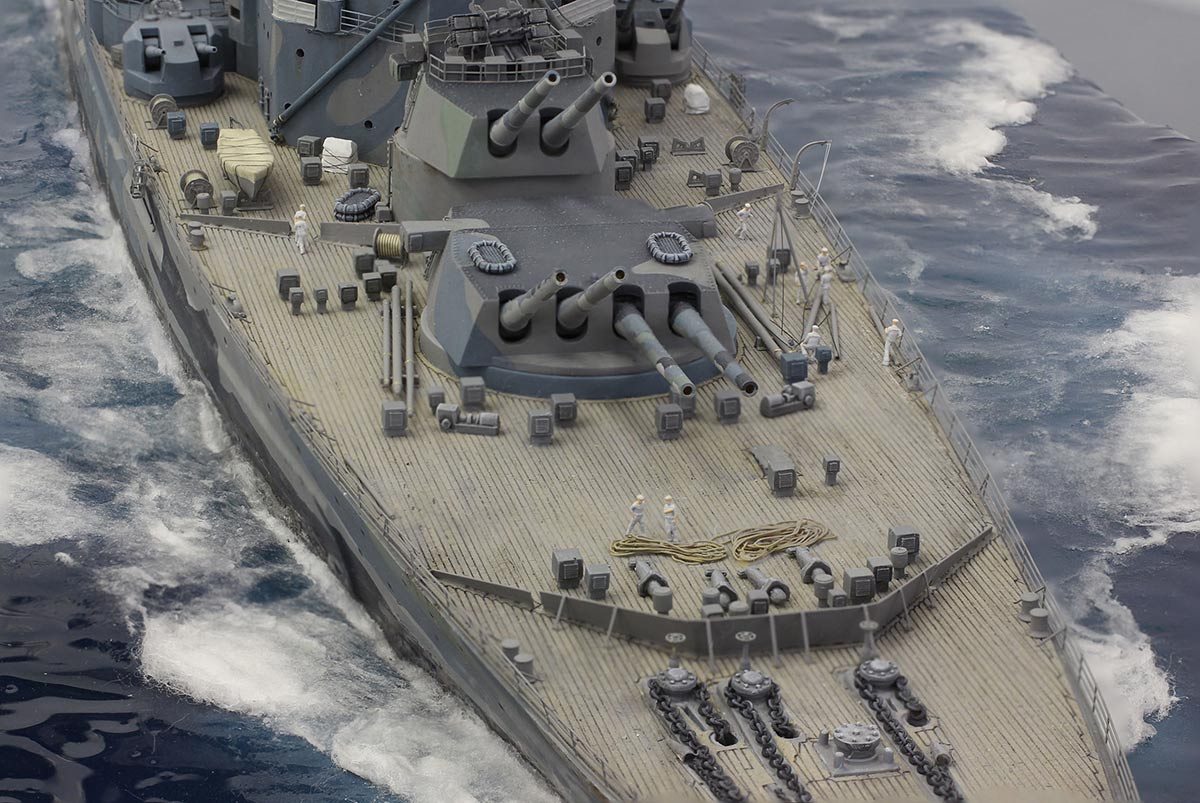

The finished reel on the ship
