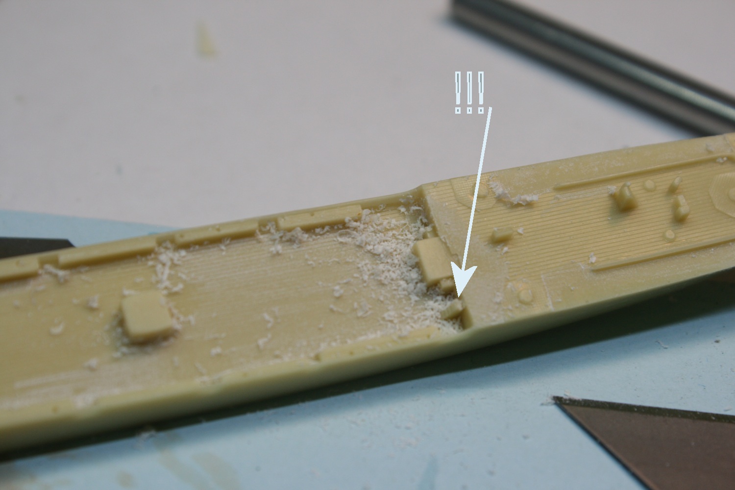

Ancona had a strange cutout on the foredeck--port side only--it can be seen in the plan-view-- but not the side elevation as the drawing shows stb side only!
i do not know what the purpose of this is --but had to add it...

The cutout reminds to the ones for anchors, but it has a strange position for that.

I think the cut out may be for launching paravanes.
Re: Regia Marina - 1/700 Ancona - (ex SMS Graudenz )
Post by Guest »
It looks like it's used for an anchor to me. I think you can see it in your first photo "Ancona1_3.jpg".
