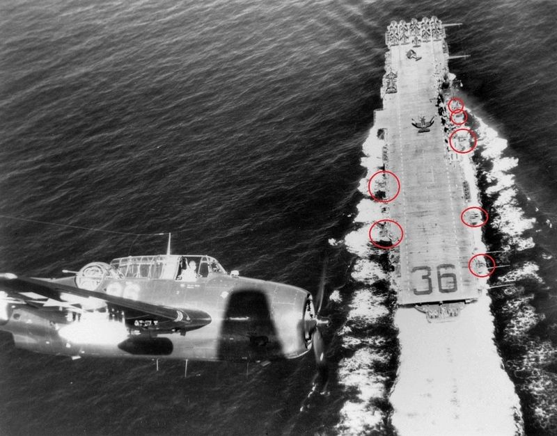

I have been researching CV-36 USS Antietam as she appeared from commissioning on January 28, 1945, through the end of WWII. All the printed material I have in various books, as well as what I've found on the net states that she never received the additional 40mm quad Bofors sponsons that some other Essex class carriers received during refits late in the war. I found this photo and have circled what clearly seems to be the seven 40mm quad mounts that were the standard configuration when beefing up the AA outfit late in the war.
Here is the super-large original version of this photo (without my circles).
http://upload.wikimedia.org/wikipedia/c ... 9_1945.jpg
Just figured I'd add to the ever growing body of knowledge on these ships. :smallsmile:

Erik,
Have you seen this pics of Antietam from March to April 1945?
http://collections.naval.aviation.museum/emuwebdoncoms/objects/common/webmedia.php?irn=42843
http://collections.naval.aviation.museum/emuwebdoncoms/objects/common/webmedia.php?irn=42845
http://collections.naval.aviation.museum/emuwebdoncoms/objects/common/webmedia.php?irn=42846
http://collections.naval.aviation.museum/emuwebdoncoms/objects/common/webmedia.php?irn=42847

MFH wrote:
Yeah I've seen those before. Thanks. Most of the Antietam photos I've found from WWII show the ship in the time frame when she was wearing the Measure 32/17A(2) camouflage, before she deployed to the Pacific.

Conventional wisdom also said that Boxer never had the outboards, but this photo is from Navsource:
http://www.navsource.org/archives/02/022132.jpg
And by 1947, they are gone:
http://www.navsource.org/archives/02/022134.jpg
Both Boxer and Antietam were in the Pacific en route to the war zone when the war ended. Antietam spent close to a month at Pearl before continuing on. Apparently, like Randolph before them, they had the outboards added prior to seeing their first combat. But once the threat was over the outboards were removed, most likely because of topweight concerns.

Top weight was an issue for sure, however, of greater concern, particularly for the late Essexes remaining in active service in the immediate post-war period, was the fact that the outboard 40 quads prevented the ships from clearing the Panama Canal. Many of the early ships went straight into mothballs with all their wartime quad mounts.

While Canal transit was an issue, the two ships in question remained in the Pacific and Antietam was only deactivated in 1949. The outboards had already been removed from both before then. Other signs point to topweight, like the removal of the on-mount shields from the remaining 40MM quads on all of the active Essex's on both sides of the Canal. Topweight was increasing due to the increasing weight of the aircraft and electronics. This was coupled with the removal of the Kamikaze threat and no equivalent threat was in immediate prospect. Something had to go. The Korean War, to some extent, increased the threat level, thus the outboards reappeared, but not in the same numbers as seen on Princeton and also shown by some empty tubs on Bon Homme Richard following her reactivation. (CV-31's on-mount shields had also been removed.) But the outboards could still be removed relatively quickly if the Canal needed to be transited, as on Franklin when she went to the east coast for her 1945 repairs.
