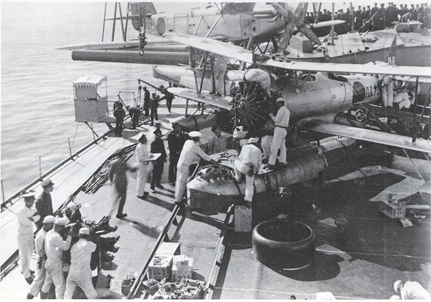

In 1/350 scale (and converted to inches), 30mm works out to 0.0034". It's half that in 1/700. Below, I've posted some photos that I believe help give one a sense of perspective on their size. Best to try and compare the width of the strips to the size of the shoes worn by the various deck personnel. Admittedly, without a true close-up, it's hard to say that the strips are as narrow as claimed. However, if, for instance, the strips were actually closer to, say 50mm/1.9" in width, that would still only work out to 0.0055" in 1/350 scale. (Think .006" brass rod.) So, I think one can see why I feel that this feature is difficult to replicate in 1/350, and truly over scale for 1/700.
Still, these strips seem very prominent in photographs. Keep in mind that it was the practice to keep them polished in peacetime, and that when the light hits them at the right angle, they tend to pop out in appearance. FWIW.
