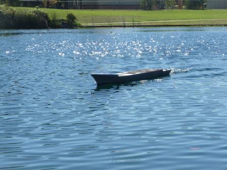

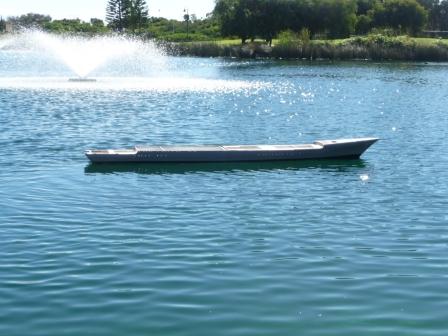

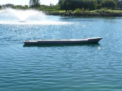

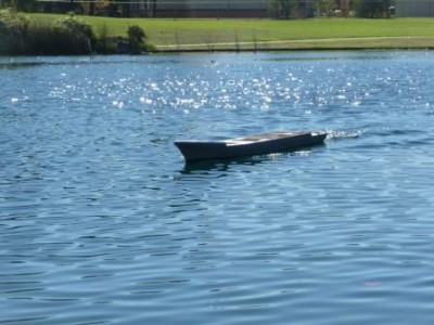

Well it has been a while. Kalinin (She will be the 3rd of the glass) has been in the water and works very well, capable of a good turn of speed.

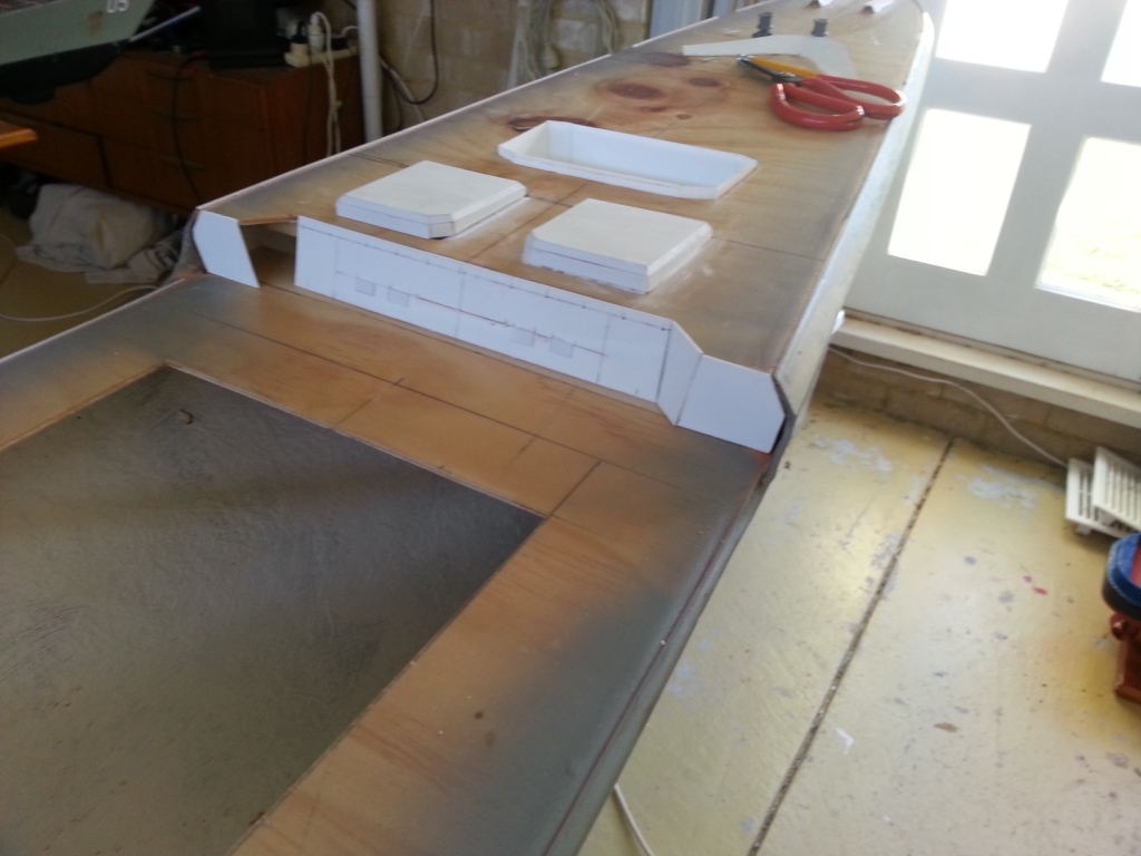

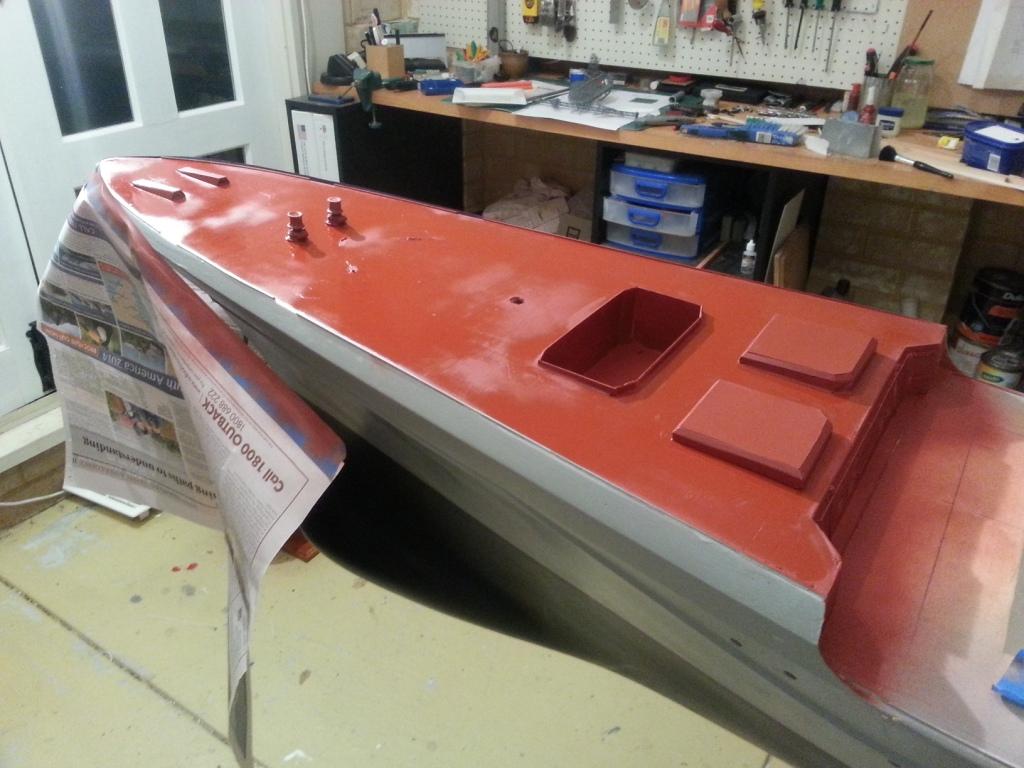

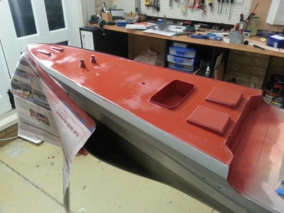

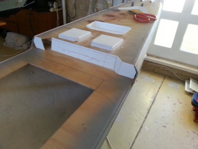

The focsle and pieces are now coming together nicely and with a bit of time available now, I'm going to get stuck into building her.

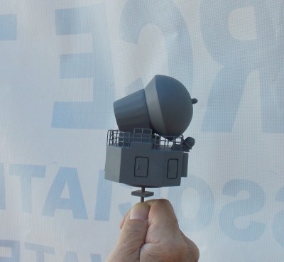

The top dome FC radars I have had made for me, due to the length of the build I decided to outsource for a few parts. Thanks Brian and Gunter.
The compartment on her focsle will be a reel store so I can carry some lines for her.

Hi Robert your Kirov is developing nicely and looks superb on the water .

Impressive work and impressive scale !
In 1/100� my Typhoon and my Sovremenny are already big, but at this scale it's enourmous

Beautiful shape on the water. Awiting new pictures.

Bloody hell that radar...

Hi Robert Superb job you are doing , I very much like the Kashtan , looks good .

Just a quick one from the last time she was in the water, video is best viewed at 1080, full screen.
Thanks Dave, I purchased 6 Kashtans from Shapeways, not cheap, but brilliant quality, more than I could achieve by hand, and a lot less frustrating....
The vast majority of the model though is all scratch built either by myself or experts in their area's, i.e. George Sitek manufactured a brilliant running set for her off photos.

Hi Richard Just superb

Richard I was just looking through all your build pictures of your model and admiring your work.
I don't want to be a nit picker I just want to possibly help you out with a problem I see in some of your build.
This image shows me a problem you might have with your joints.
Other shots show some sort of putty you are using or is it an undercoat.
I don't know if this image above is a work in progress of not.
My dad showed me how to overcome such a problem.
When you have to pieces join make one over sized, then wait for it to dry COMPLETELY. (Just want to stress this point)
Then get your hobby knife and trim back and if necessary hold the blade square and scrape it back for a perfect square edge.
If you do this you will need much less putty and have a sharp edge.
Again great work mate and keep up your work. I hope to make a start mine soon.
