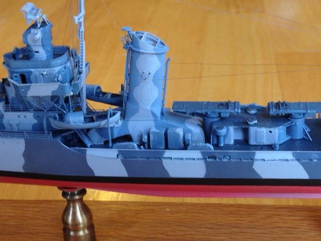

Here's three shots of my Sim's conversion, USS Anderson, DD411, using your stack and mid deckhouse. I am very pleased with their look. I'm not real sure how to do this, so please bear with me.
The donor kit was the 1/350 Dragon USS Livermore kit. I'll get some more full length shots made and published soon. I need to make a couple of fixes, weather, and flat coat it, but I just wanted to show your parts in use. I hope your are pleased with them.

NICE!!!!!
I can't tell you how super it is to see these being used. Your model looks wonderful, a great model of an underrated and important ship! You're far better with keeping PE rails straight than I ever will be. Are the splotches brush painted or airbrushed? They look very evenly and petitely airbrushed, as I'm not seeing the paint build up and heavy deposits that brushes can sometimes leave behind.

Well, thanks. On the larger structures, hull, stack, deckhouses, etc., they are airbrushed, using enamels and scotch tape or post it note masks. The smaller structures, such as the 20mm gun tubs and main gun houses, have the contrasting camo color brushed on after a base color coat airbrushed.
Very happy you like it. You do good work.

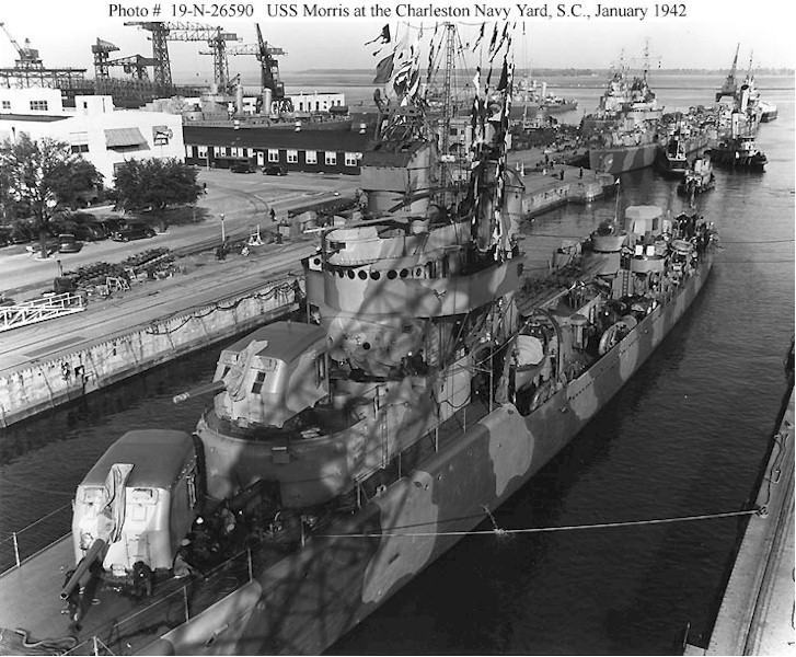

I'm not a big camo expert and figuring out specific "colors" from B&W photos is a guessing game, but I would say that the hull is 5-N and 5-O with the superstructure being 5-O and 5-H. The Atlantic Fleet switched from 5-S to 5-N as they switched from Ms 12 "original" to the Ms 12mod(or R) scheme in late 1941. Those colors would follow the "rules" for Ms 12mod(R). NOW then whether they followed the rules I don't know.
Another photo of one of HAMMANN's DesDiv sisters at Charleston Navy Yard, USS MORRIS (DD-417), taken at the same time seems to show the color gradients as prescribed by "Ms 12mod(R)" better. By the way this photo of MORRIS shows her entering drydock and the destroyer closest to her behind her is USS HAMMANN. This gives you a different perspective angle of that ship.
Here is the same image first as I scanned the original print at NARA and as seen on Navsource from what NHHC scanned. An example of now different "scans" and maybe different original prints, can provide different "shades" of gray.
