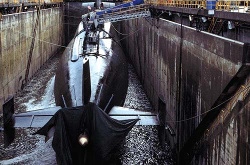

Hello. I am getting ready to start Dragon's USS Ohio kit. I will be building it as the Louisiana. Part of the build will be to fill in the panel lines. My question is, has the USN done away with the red antifouling on the hull? I have Squadron's Ohio class book and plan on using any photos from the USN site I can fine as reference.
Vepr157
Posts: 276
Location: United States
Re: Calling all Ohio class (SSBN/SSGN) fans
Post by Vepr157 »
Kenny Loup wrote:Hello. I am getting ready to start Dragon's USS Ohio kit. I will be building it as the Louisiana. Part of the build will be to fill in the panel lines. My question is, has the USN done away with the red antifouling on the hull? I have Squadron's Ohio class book and plan on using any photos from the USN site I can fine as reference.
Here's a photo of the Louisiana in drydock, but I'm not sure of the date.
https://thechive.files.wordpress.com/20 ... info&w=919
There are two current schemes:
Black above, red below
Maryland
http://i.imgur.com/5Tf2fM5.jpg
Rhode Island
http://i.imgur.com/6YEUV9U.jpg
All black
Pennsylvania
http://i.imgur.com/l7KvIYv.jpg
Henry M. Jackson
http://i.imgur.com/Kjpyqo1.jpg
I'm guessing that Atlantic Boats (drydocked at Newport News) have red antifouling while the Pacific boats (drydocked at Bremerton) are all black. I remember hearing that during the Cold War, boats overhauled at Mare Island would be painted all-black because of a California regulation on toxic paints. Could be apocryphal and I don't know if that would apply to Washington.
