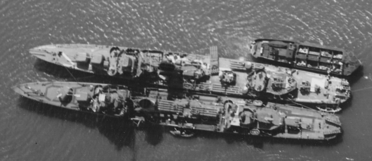

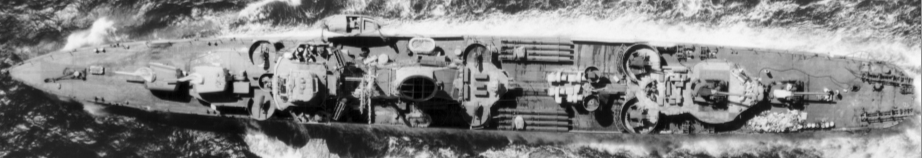

I have attached a couple of "small" views just to show "typical" major mid to late war differences between the GRIDLEY and BENHAM classes.
I don't have time to go down through unit by unit the differences in the Four GRIDLEY class and Ten BENHAM class during WWII.

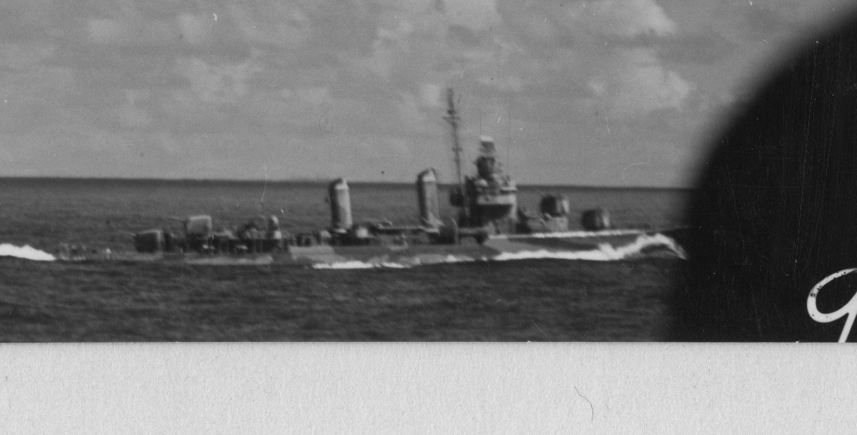

Photo a Barton at Santa Cruz, courtesy of Fred Branyan via Roger Torgeson. Photo is from the US National Archives, NARA II
Crop of Barton
Crop of Barton

The NARA number for the photo above is 80 G 33921
