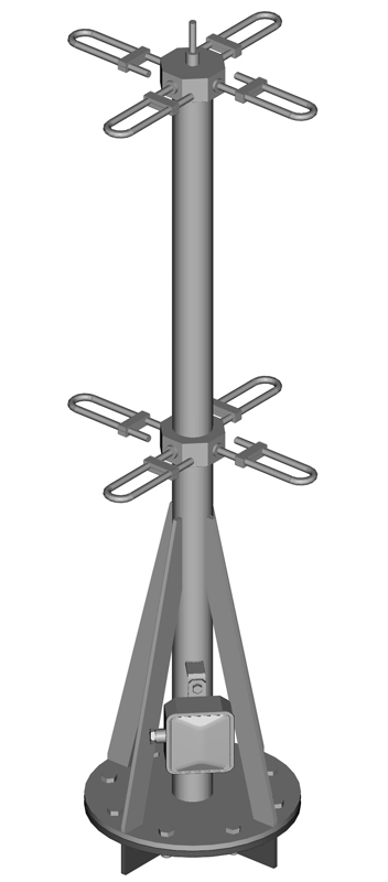

Does anyone know what this antenna is? It was common on cruisers, DLGs and other ships in the 70s.
I would like to know dimensions (it is about 5 feet tall), frequencies and what it was used for.
Thanks.

PostPosted: Mon Aug 10, 2015 11:46 pm
Posts: 1274
The CLG-6 antenna information will be useful.
I looked over the picture and I didn't see the antenna. I think it is some way associated with the SPS-37 air search radar that replaced the SPS-29 shown in the photo. The SPS-37s replaced the SPS-29s in the mid to late '60s.
The AN/SPS-37 uses the AS-1092/SP antenna assembly. I think the mystery antenna is an AS-1093/SP, but I haven't been able to find a data sheet for it, so I am not certain.
