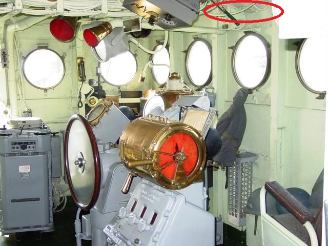

Seeking some help with the overhead of a square bridge pilot house. My apologies if this has been discussed earlier.
I am trying to locate the structural elements supporting the pilot house roof as seen from inside the pilot house. I would like to understand their position along the overhead and how they tie into any supports on the bulkheads (or not tie in). I suspect they are simple I-beam elements. Any thoughts or photos (and dimensions, if possible) are MUCH appreciated.
Have fun, Monkey around.™

Is this info not in the FLETCHER Plan Book? I would think it would be.

Not the pilot house overhead, unfortunately, but otherwise a tremendous resource! Thanks for loaning it to me! David Doyle's USS Kidd On Deck published by Squadron has some great interior photos of the pilot house but, unfortunately, not of the overhead.
I'm missing girder details. For example, there is a heavy beam or girder than runs centerline, longitudinally along the overhead that connects to an I-beam post on the (aft) bulkhead that separates the Pilot House from the Fire Control Station. But there is no support on the forward bulkhead directly at that location because a porthole is there. So, thinking structurally, what supports the girder forward?
There are four vertical I-beam posts on the forward bulkhead between portholes so I expect that they tie-in to four longitudinal girders on the overhead but can't confirm from the available plans or photos I have access to.

Found a photo of how the centerline girder ties to the forward bulkhead above the center porthole - no supporting column or transverse girder, it just has an expanded end that abuts the bulkhead (see below) but can't make out any other overhead structural details for the Chef-Boy-Ar-Dee cabling. There is an interesting gray box fixed at an angle. Any idea what it is?
