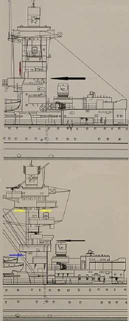

PostPosted: Sun Sep 13, 2015 6:20 am
Joined: Tue Mar 05, 2013 2:31 am
Posts: 70
Some of the problems mentioned above:
1. The after superstructure is in fact narrow, not wide (black arrows), it is shorter than depicted in the drawing and there is a piece of open deck between it and the funnel base (red arrow). A minor but interesting point that the flakvierling et the end of tghe forecastle deck is not in the midline but slightly to starboard (yellow arrow)
File comment: drawing and picture from "The pocket battleships of the Deutschland class" by Gerhard Koop and Klaus-Peter Schmolke
2. The bridge was cut down at the level marked by the black arrow but below the that the front face was unaltered (no overhang created) . The tubular mast is too wide in the drawing and it should be situated further aft (blue arrow) as only half of it was incorporated in the bridge structure (see pohoto below).
File comment: source: Monografie Morskie 9, Deutschland/Lützow, Admiral Graf Spee, Admiral Scheer
File comment: from "The pocket battleships of the Deutschland class" by Gerhard Koop and Klaus-Peter Schmolke
