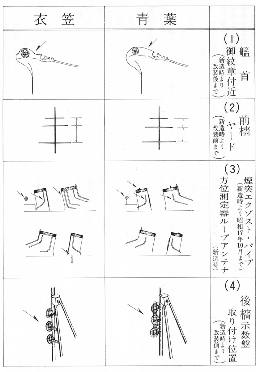

Sasaki-San mentioned that the Kinugasa's forward deck was altered to look more like that of Myoko.
And that this was a point of difference between the Kinugasa and Aoba.
I am trying to do an Aoba and Kinugasa for the 1942 Solomon's Campaign (Savo Island and Cape Esperance), but I am having trouble determining what to do about the PE kits (I have the newer Hasegawa kits for these ships).
This thread has said the Rainbow PE kits for both ships are a bugger to work with. I have one set of the Kinugasa PE for the Kinugasa, but the PE kit for the Aoba is for 1944 (I have a thread in the Main Forum that mentions this).
I am already aware of the issues with the turrets having their training devices removed. And I have already taken care of the dip in the Fairlead of the Kinugasa.
The PE decks for the ships are the same kit from Rainbow (they just have PE inserts for the deck where the '42 to '44 changes were made). But I am not quite sure what to do about the differences in the forward deck, as mentioned earlier in the thread (and this post), for the Kinugasa. The "changes" were not exactly specified, and looking at photos of the forward decks of the two ships, all I can see in the few images I can find don't give me enough information about what exactly is on the deck to know any different.
Are we talking about just the arrangement of deck-vents, or is it the shape of the forward forecastle, where the hawsepipes and anchor chains are arranged?
Or is it something more obvious, that my inexperience, or lack of familiarity with the period is causing me to miss?

This is what I've got. More than anyone else, Mucho would know if there's more.
MatthewB
- Posts: 2269
Re: Calling all IJN Aoba/Kinugasa fans(new)
I have already taken care of the first two pair of images (the Fairlead, and the Stack).Dan K wrote:This is what I've got. More than anyone else, Mucho would know if there's more.
But what is that third pair of images?
It looks like either signal lights or pulleys on a mast.
And, I can only read about three of the Kanji, which don't give me enough context to derive the rest of it.
MB

Those are range clocks, phased out during the 1937 refits.
MatthewB
- Posts: 2269
OK, then that could be why I don't see them in wartime photos.Dan K wrote:Those are range clocks, phased out during the 1937 refits.
So I don't need to worry about them for the 1942 outfit of both ships.

Now to just get the collection of junk kits I have lingering on my desk painted (or finish painting them), so that I can concentrate on some kits that are a bit more interesting.
Like the Kinugasa and Aoba.
So... Other than just these few differences to their forward decks, and stack.... They are pretty much identical in their 1942 outfit?
I need to get (read: find) some photographs of the stacks to figure out where the plumbing they have doodled in on the sides of the stacks comes from.
Obviously it comes from the deck, somewhere.
Also, what do the tops of these vents look like? Are they curved outwards at the top, or are they just open pipes? The former would be a bit of a beach to model.

Pretty much identical. Yes, the auxiliary pipes extend upwards from the main deck, though some may route thru some of the other surrounding superstructures. The auxiliary piping vents are varied in their appearance.

Excellent Photos, thank you very much.
Oh! One other question:
Were Aoba and Kinugasa in the same CruiserDiv?
What about Kako and Furutaka?
I see in that last photo of Kinugasa's stack that she is the second ship in her division. I am assuming Aoba is the first.
MB

Matthew and Dan,
As a matter of fact distinction points are in the above mentioned pic. Differences will be positions and shapes of;
the 2kw signal light(the rear mast)
the signal yard ( " )
the steam pipes(nr.1 funnel)
Here you go with your pin-point scrutiny. Good luck!
I think neither conventional ship books nor ijn experts have been pointing out these for more than 70 years,neither the latest Nihon no Kaigun book Dan refers to...
BR
mucho,
BR
mucho,
MatthewB
- Posts: 2269
Wow... He's right.
The pipes on the forward stack can only be from the Kinugasa, which has the paired exhaust piped on the rear-side of the froward funnel, as in the illustration seen earlier.
I can't mKe out the differences in the searchlight near the rear mast that is mentioned, though.
What would be the differences, so that I can reposition the one that needs to be re-positioned (I am betting I will need to re-locate the light on the Kinugasa kit, as it is basically a repeat of the Aoba, but without the AA Gun positions for the Later-War - which I am having to cover).
MB
MB

- Posts: 9038
Thank you, Mucho!
He's talking about a small signal light, not a searchlight. I don't even see it in this photo. I'll try to post an example, later.
